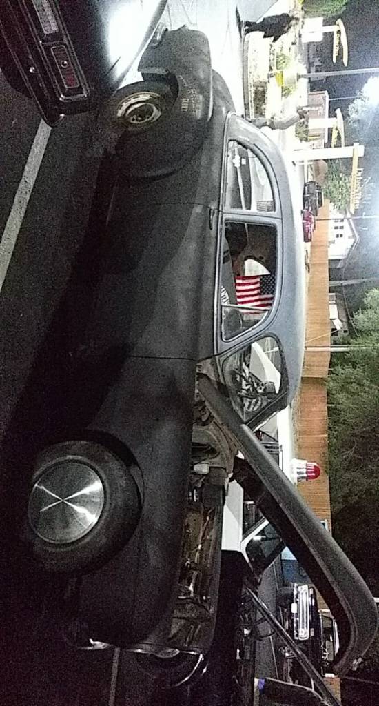

    I thought i'd go a liitle more patriotic with it, as war turd won't quite fit when it looks nice. Is there a universal harness that would work for this sort of thing? Thanks for the help guys.

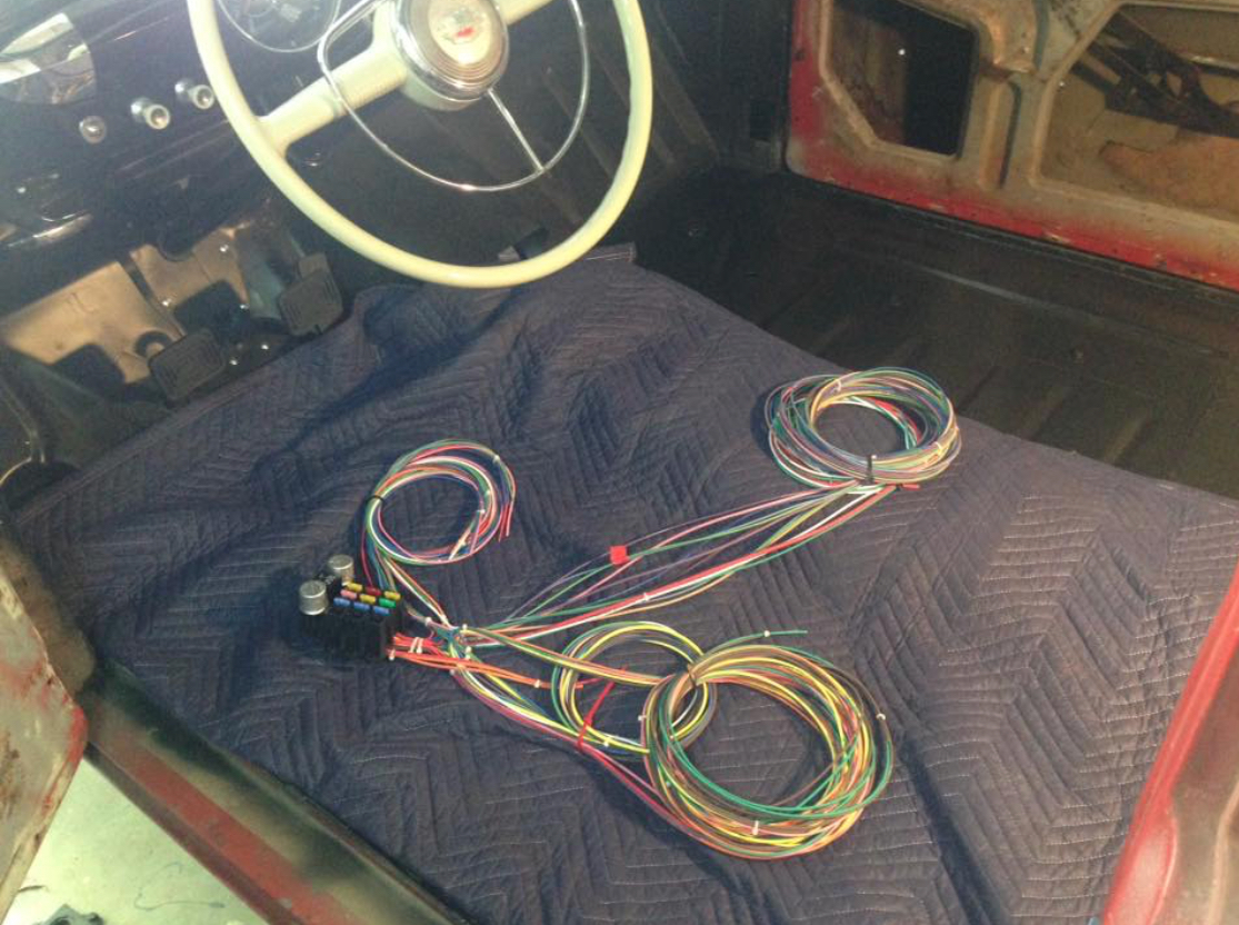

  6. Rebel wiring harness would bail out the wiring issues. They are a vendor here and easy to talk to for support. Would be a good challenge for you if you have never rewired a vehicle but taking your time you can do it.Lots of threads here on rewiring and many members that are well versed in wiring and electrical issues.

    Thats one thing i'll probably buy then. I got the tail lights working today, but couldnt figure out the blinkers yet. Even with the instructions, thing didnt line up with the way its been rewired in the back half. But hey, this is a learning experience and i'm learning o ill just call the tail lights a win for today!

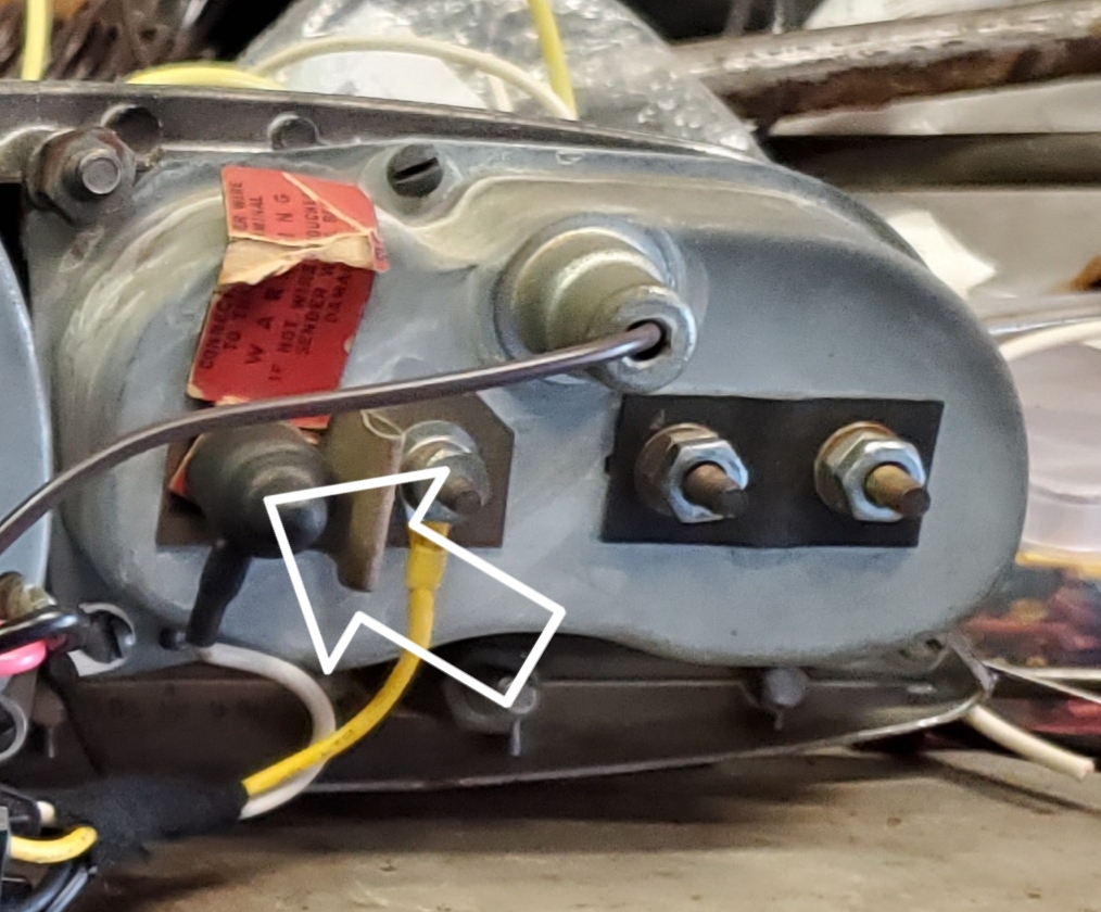

    Regards to the wiring- does the fuel gauge move at all when you switch on the ignition? Even at a dead short it should rise off the stop a fraction.
    Moderately easy way to see if it's the gauge or the sender is to reach up the back and undo (as you look at the back of it) the left hand terminal- the one with the warning label and rubber bung on the peg, it's the smaller of the two pegs.
    Switch on the ignition and the fuel gauge should go to full. If so, you've got a short circuit going to ground towards the fuel tank.
    Ever get the turn signals sorted out? The turn signal switch isn't that complicated but mine was all bad contacts. See if the multi plug under the dash by the blinker relay has been bypassed.

    Sorry guys, I've been pretty busy. The fuel gauge move straight to full and stays there. I was attempting the blinkers for a while, I found the 3 point connection after endless searching but couldn't seem to get the mess to work. So here's how the last couple of weeks went for me. I got out for Cruise Kearney, the car had a low front drivers tire. Went to the nearest Casey's for the air pump, the pump was broken. Headed back to the house, and ran over a nail in that same tire. Called a tow truck, the truck never showed up, so I gimped it home and pizza cuttered the tire. Next day. I was at drill, so my wife was being nice and took the wheel off to get a new tire. Took it to a shop with some young guys, and the got a new tire on but didn't set the bead before giving it back. The tire held air until it started rolling, when it promptly went flat. Got that one fixed the next day, went to start it, and the fuel pump immediately burned out! So we took a deep breath, walked away, and overnight we had a huge temp drop. Luckily the block didn't crack!

    Fuel gauge straight to full means the gauge is good. You've either got a wire disconnected towards the tank or the sender is open circuit.
    Test for resistance at the tank connector with a meter, if it reads infinity then replace the sender, they're available and not that expensive.
    Phil
    Edit: the gauge works "backwards", the more fuel you have the higher the resistance goes. A full tank is about 30 ohms, empty close to zero.

    I had wanted to make sure mine worked! You can check the gauge for sure easily.
    On the back of the gauges, with the ignition on, pull the rubber boot off and use a screwdriver or piece of wire to touch that terminal to the metal on the back of the gauges. The needle should drop and point at just below empty. Do not touch it to battery voltage (that's what the red label says).
    If it does it's worth investigating the rest of the wiring because you can have yourself a working gas gauge pretty easily.
