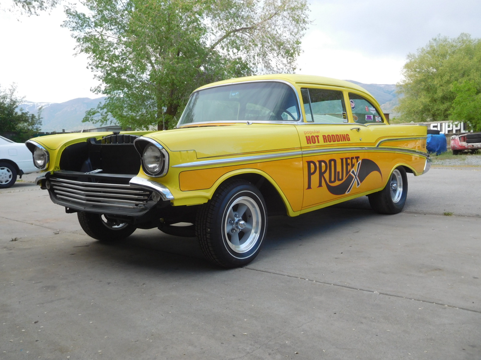

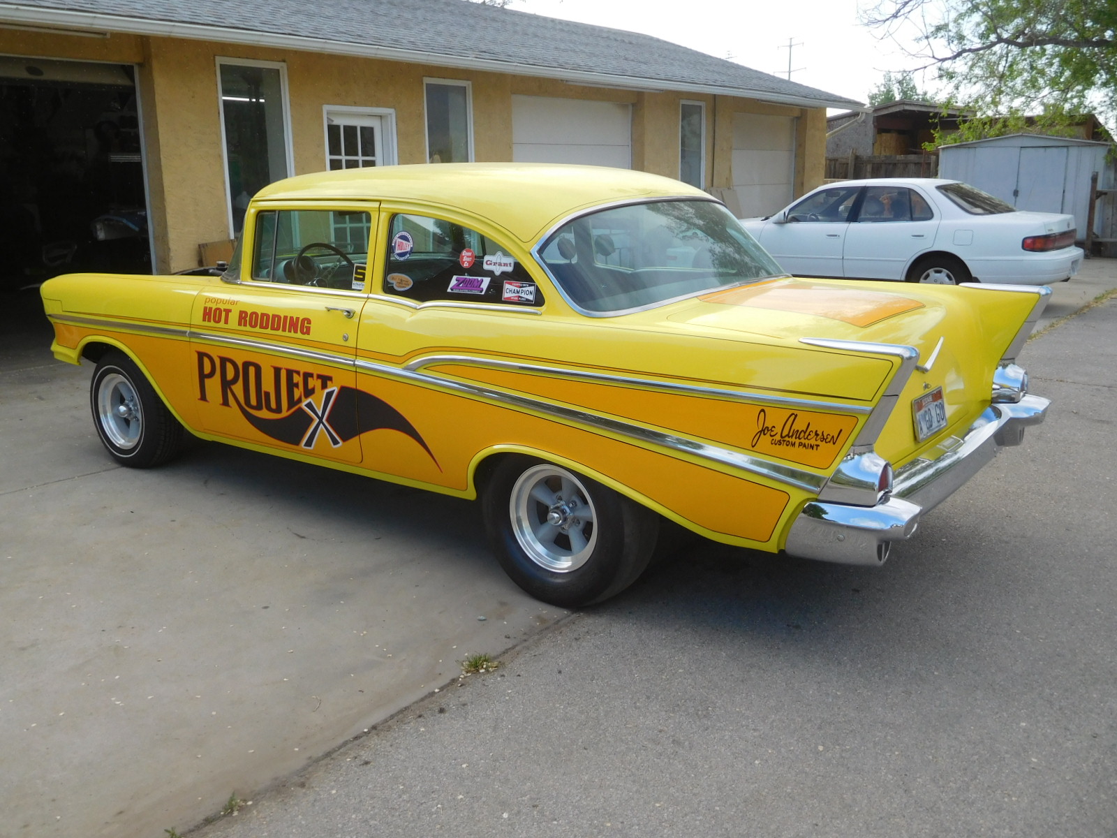

    This is going to "one of those cars" and what I mean by that is when you take this to events, people are going to RUN across the fairgrounds to see it... rock on man

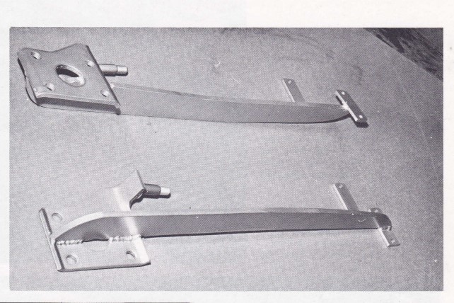

    Super bad*** car. All I can add is that I have some car show flyers for Joe Andersens custom work. In the future..people will study your car to build a replica. You've done great work getting all this info together. Car looks awesome!

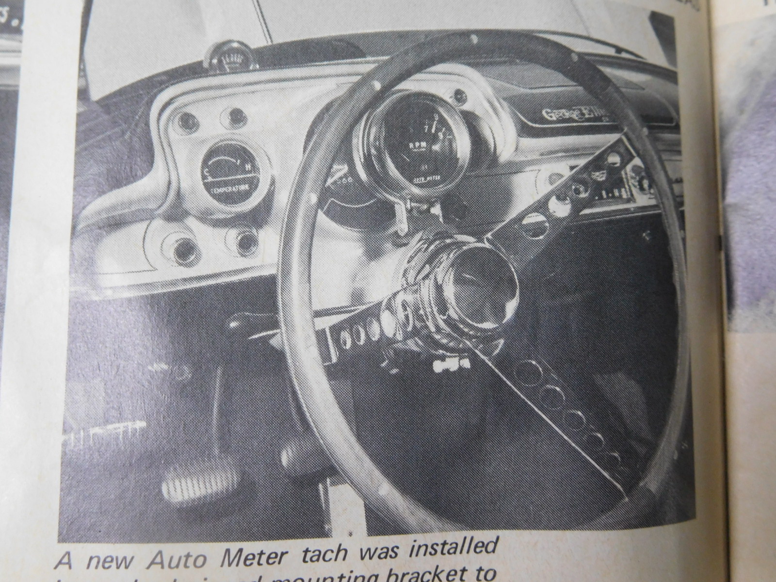

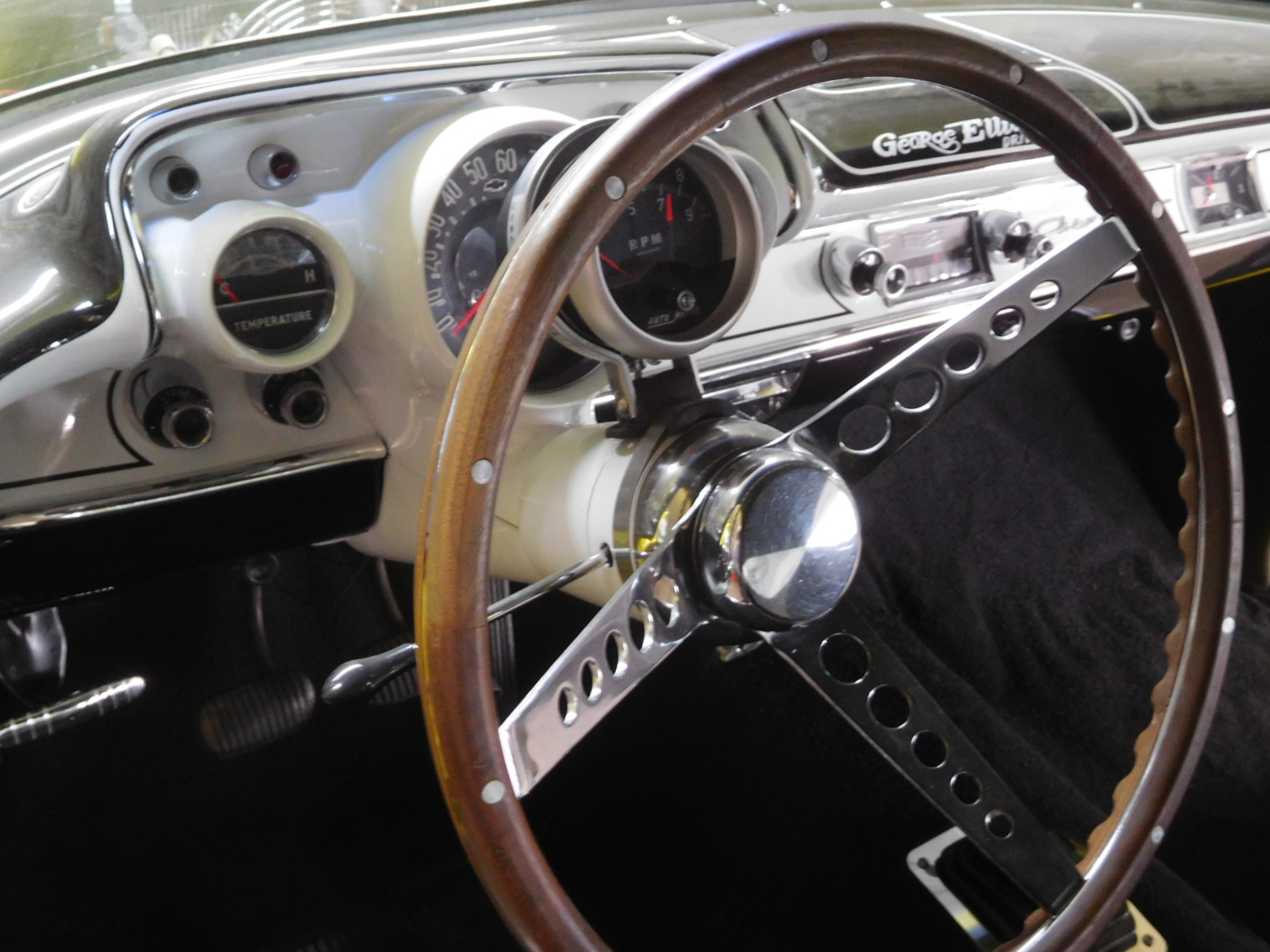

  5. Phillips
    Joined: Oct 26, 2010
    Posts: 1,873
    Phillips
    Looks like a ‘60s vintage Auto Meter to me (look at the sweep and lettering) Auto Meter designs were so ahead of their time that even their early gauges still look modern.

  9. Project X is one of the most iconic rides of my generation. Your reproduction of the earlier version is killer. Not everyone will get it, but those that do, salute you. Outstanding effort and result.
  10. Squablow
    Joined: Apr 26, 2005
    Posts: 19,041
    Squablow
    Yup, looking between the original picture and the new comparison picture, they're identical. The tach still does have a modern look to it, but it's exactly the same as the one that was originally used, down to the hose clamp mount.
  11. 19Eddy30
    Joined: Mar 27, 2011
    Posts: 5,139
    19Eddy30
    from VA
    Very Nice looking clone ,
    very close to being Accurate to time frame ,
    The Tac on clone Looks to have
    Sport & Pro Comp Basil, ( silver paint)
    Compared to B-W picture to have Crome Basil ?
    I have a older One I believe around here
    Early 70s ,
    I think A-M started using /offering the Silver paint around 80ish .

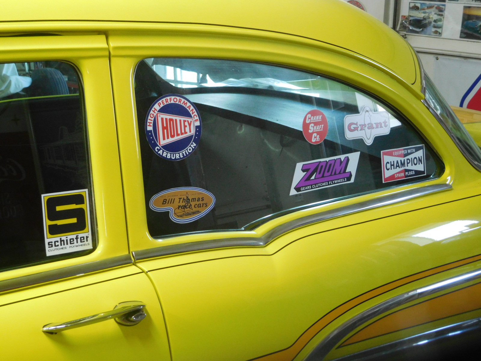

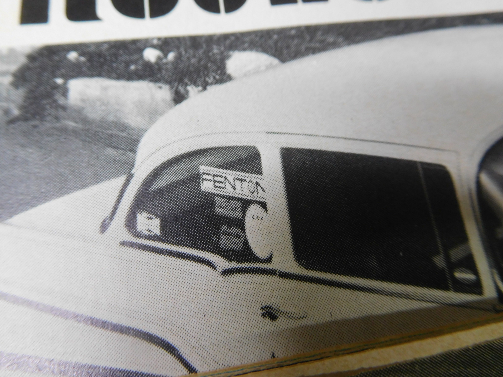

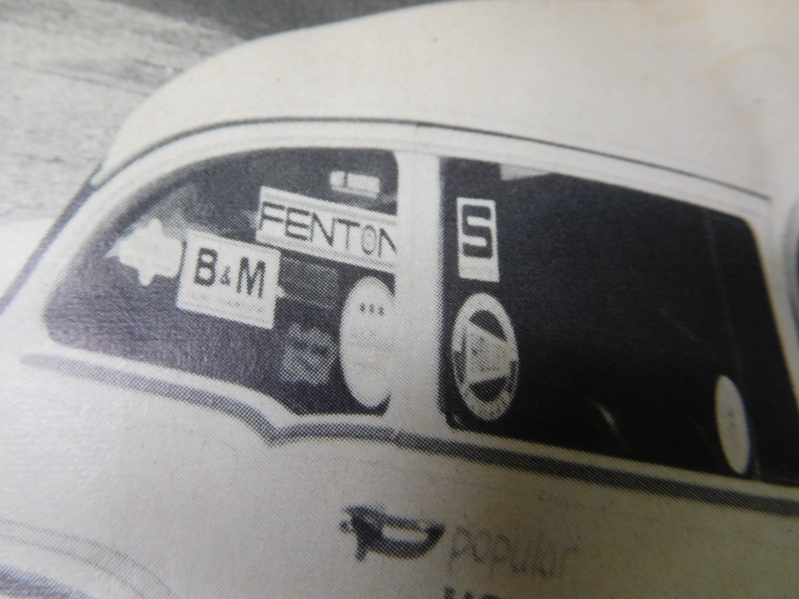

  12. Utahvette
    Joined: Sep 4, 2012
    Posts: 478
    Utahvette

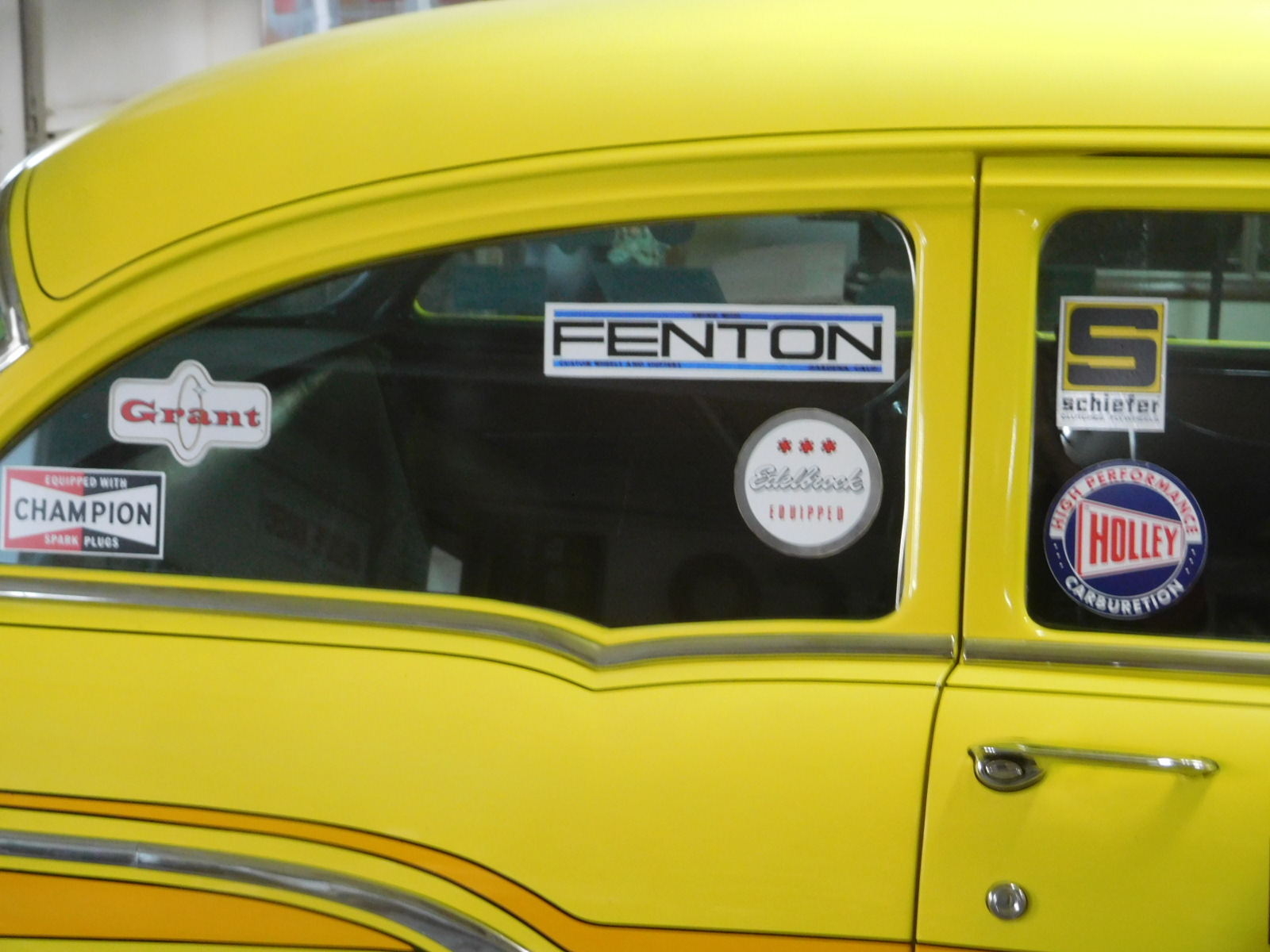

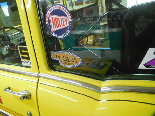

    I put on the window decals I could identify. With time I should be able to figure out the others, maybe. Part of the problem is they were constantly changing so they were different in nearly every picture. DSCN5290[1].JPG DSCN5293[1].JPG DSCN5292[1].JPG DSCN5297[1].JPG DSCN5298[1].JPG

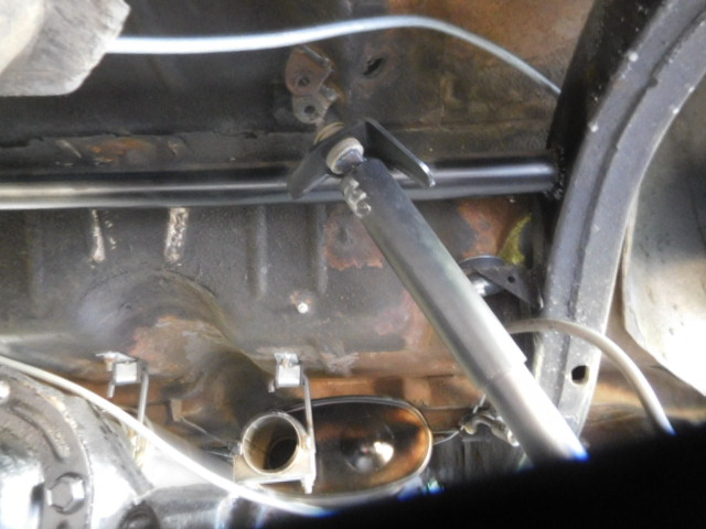

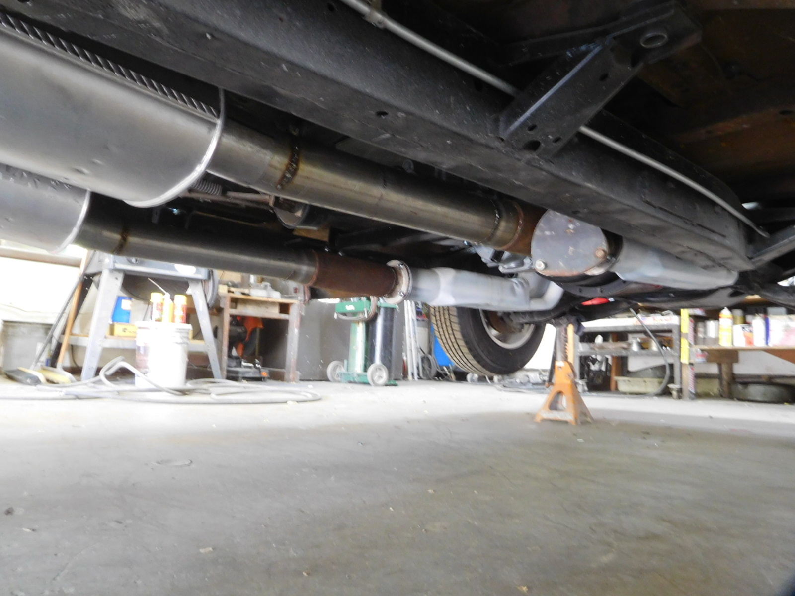

    I started on the exhaust last night. I got most of it done. Will still need some clamps and hangers, but it's good enough for now. I incorporated some of the old exhaust with dumps that came with the car and added some 3 inch Dyno-Max Super Turbo mufflers. These are very large capacity and do an admirable job of quieting down big engines. I don't know how to terminate the pipes yet. They may just turn down ahead of the axle. I'll have to get the actual axle installed and see what I have for clearance. Looks to have adequate ground clearance. I'll clean the pipes up and paint them black later. DSCN5311[1].JPG DSCN5312[1].JPG

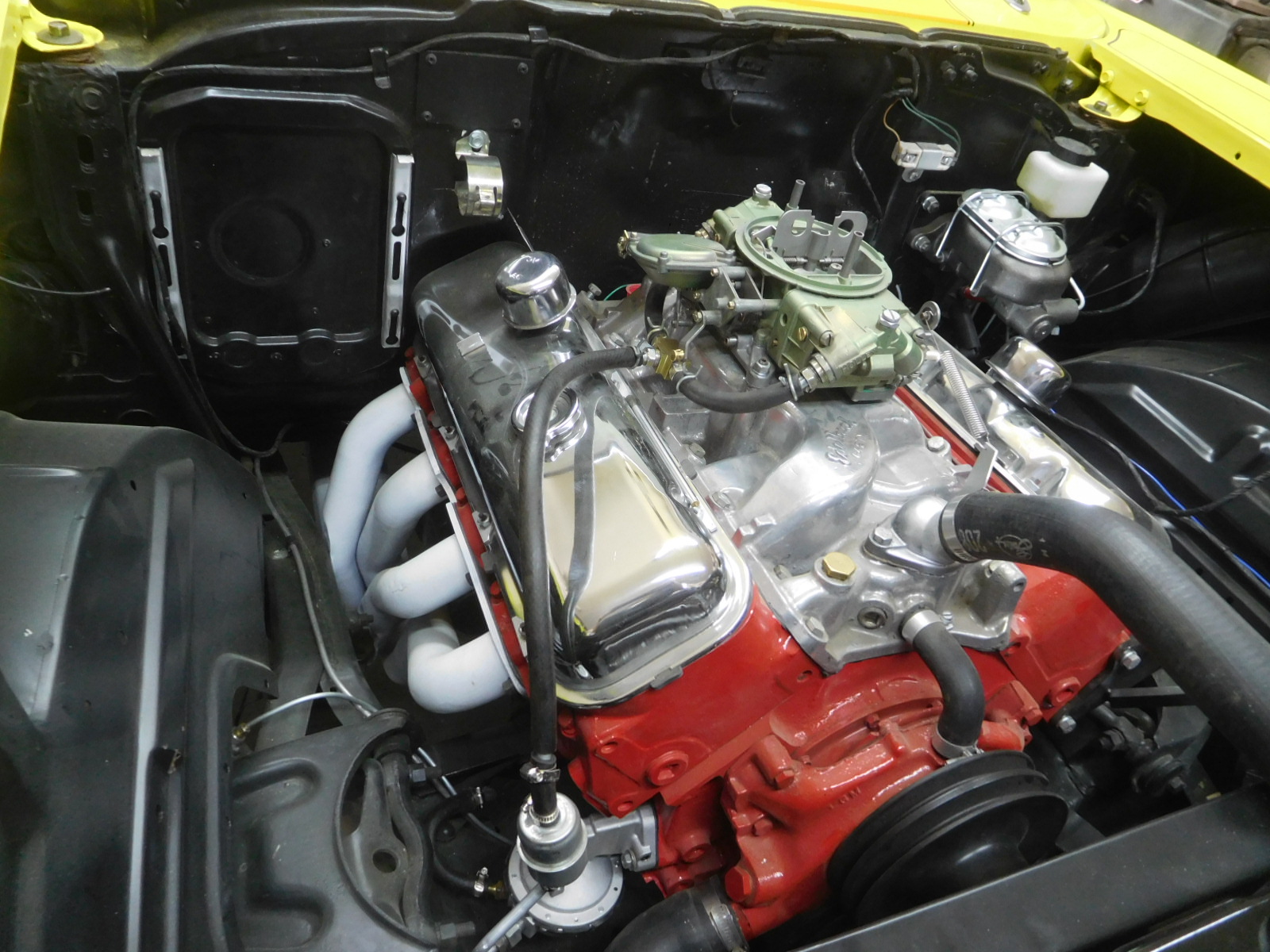

  20. bushwacker 57
    Joined: Oct 3, 2007
    Posts: 833
    bushwacker 57
    The Throttle / Gas Pedal Was Hydra/ Link Brand in the Engine Photo you can see the Slave Cyl to Carb.

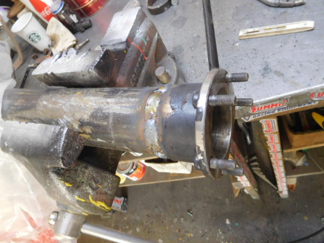

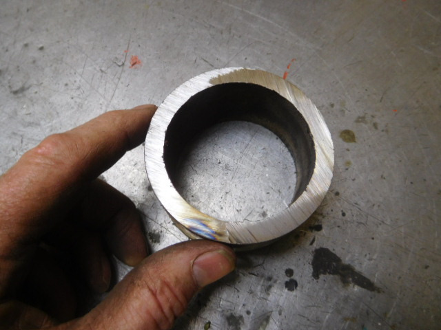

  22. Utahvette
    Joined: Sep 4, 2012
    Posts: 478
    Utahvette

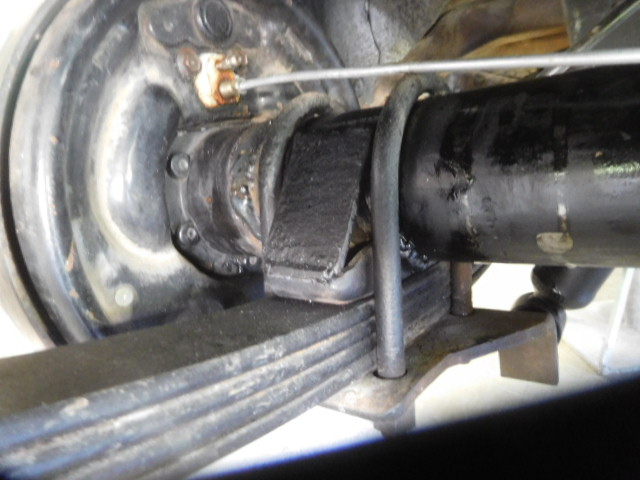

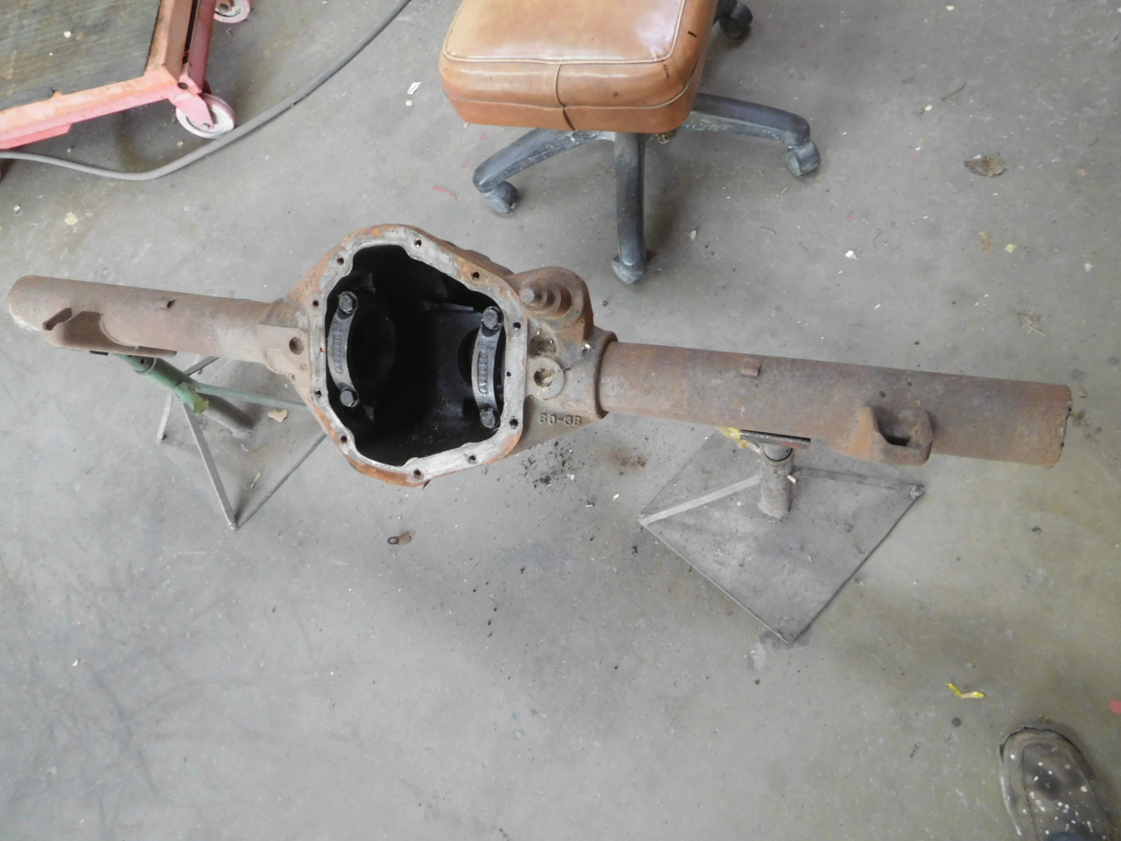

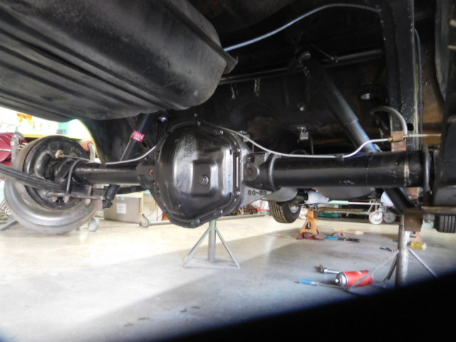

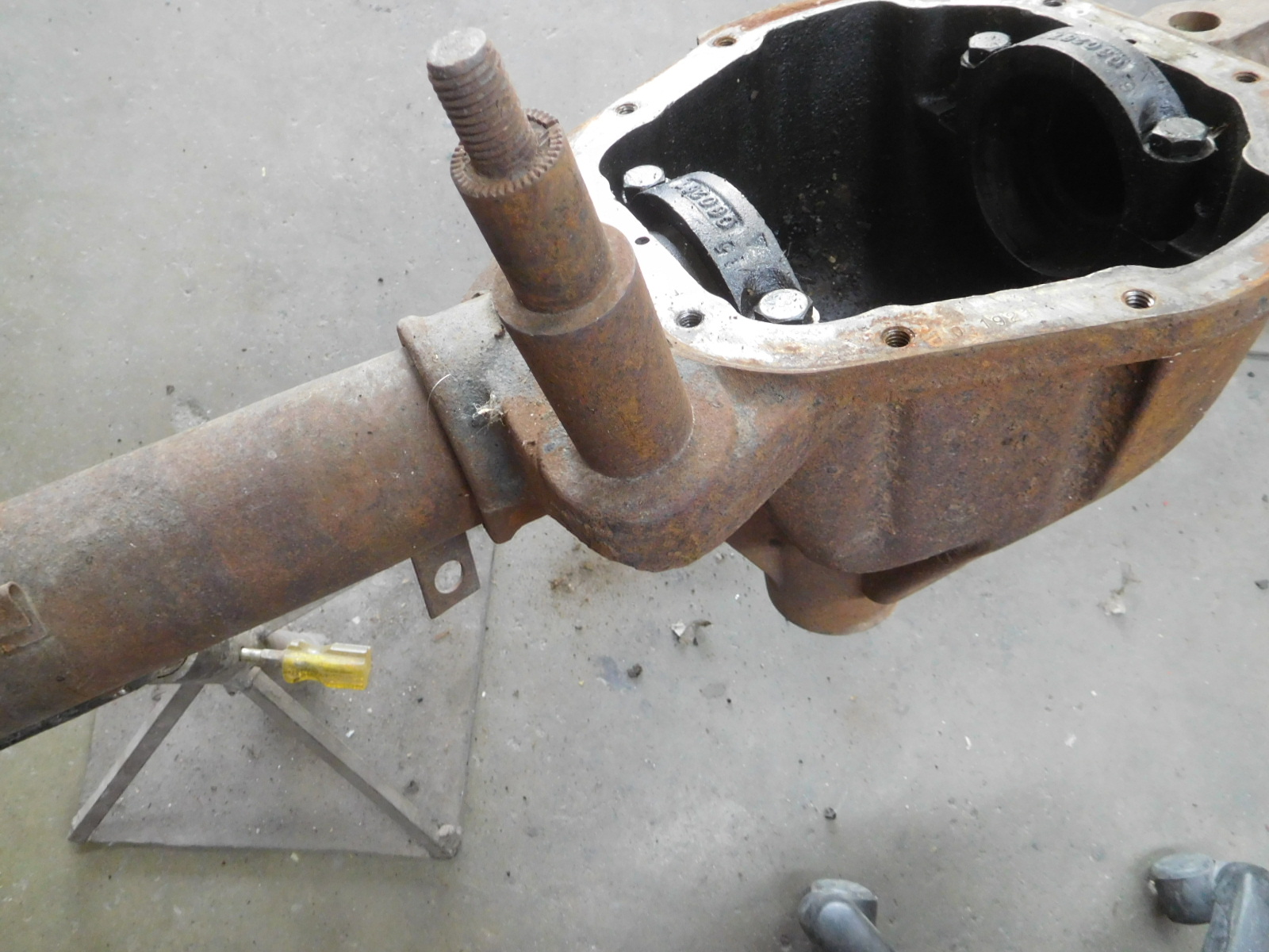

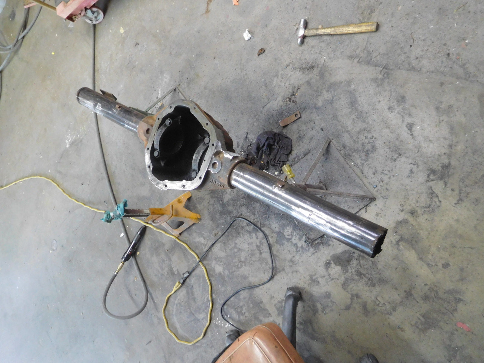

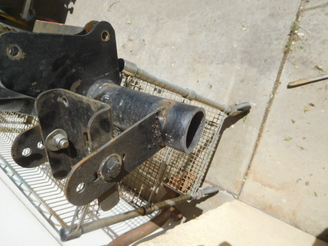

    Finally, some progress. I was given a Dana 60 a few years ago. It's a weird one out of a Chevy truck I think, so it has a strange panhard bar bracket sticking out of the housing that needed to be removed. Only 45 minutes later, with the help of my Saws-All it was gone. Nothing to it. This was a dually axle and had the drums and ends cut off. I cut the housing ends off the 8 3/4 that was in the car. I set up the ring and pinion in the Dana housing, and then using one of the 3 sets of 35 spline axles that also came with the car, I calculated the width desired. The axles were just a bit long so I trimmed the ends down with my chop saw to get the desired 59 3/4" overall width. Then I trimmed the center housing and adjusted the end pieces to proper length. The hard part was, the housing tubes are .325 thick! It takes forever to cut through them. Very important to measure twice so you only have to cut once. The good thing about the thick tubes is that you don't have to worry about anything being bent. Once it was properly sized, it was a simple matter to weld the ends on and finish ***embly. I cut the spring pads off an old rear end and transferred them over. I reinforced them with some straps to prevent the axle from breaking out of the perches and twisting under the car. Used the brakes and backing plates off the other rear end and she's ready to go. While I was under the car, I installed the shock crossmember that also came with the car. Now with the brakes on the rear, I was able to bleed the brakes and setup the emergency brake. I dropped the driveshaft off at the shop to have it shortened and 1350 yokes installed. When it comes back the car will move under it's own power for the first time in 8 years. This drivetrain is gonna be bulletproof. DSCN5314.JPG DSCN5315.JPG DSCN5316.JPG DSCN5319.JPG DSCN5379.JPG DSCN5380.JPG DSCN5382.JPG DSCN5383.JPG DSCN5384[1].JPG DSCN5385[1].JPG DSCN5386[1].JPG

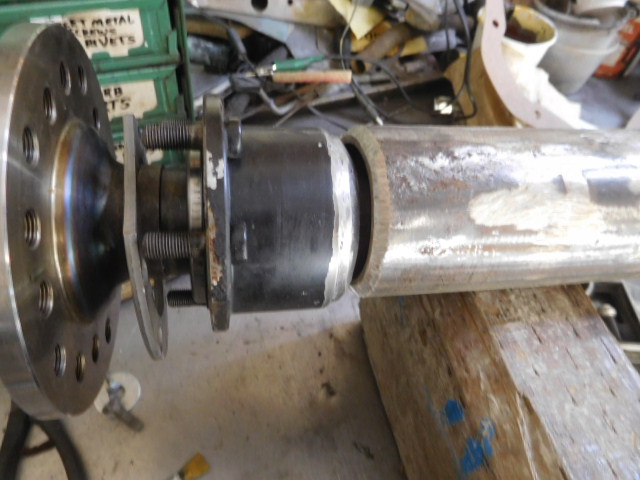

    I suspect some of you out there are wondering why I didn't use a Pontiac rear in the car like the original had. I've used Pontiac rears before, and while the 9.3 inch ring gear and the 31-spline axles are stout, the positractions are weak. Sure, if you run a spool they're tough, but spools on the street are awful.
    I want to take this thing on a Drag and Drive event and the last thing I need is to bust the posi 1000 miles from home in a rear end that's been out of production for 60 years.
    The Dana 60 Power-Lock posi is absolutely huge compared to the Pontiac's much smaller Dana 44 size. It will survive anything I can throw at it without so much as a whimper. And of course, let's not forget the 9 3/4" ring gear dwarfing even the Pontiacs 9.3" gear. The 35 spline axles are just more insurance that there will be no reliability issues from the back of the car. Plus, these are cheap to build. I had the axles and housing. I bought a new posi for $480. Bought used 3.54 gears for $150. Axle bearings for $85 and that's about it. I re-used everything else.
    Once again I'm deviating from the original, but I'm doing it in the name of durability. A cool car is no good if it's broken.

    A D60 does not dwarf a 9.3 Olds/Pontiac. Not even close. The guts of a 9.3 are m***ive by p***enger car standards. Pinion bearings, pinion shaft dia, main cap size, are all very similar between a D60 and a 9.3. Yeah you're right a D60 probably is 'stronger' but you can't change ratios in an hour.
    You are correct about weak factory posi units, but you shoulda bought a Trophy Track that woulda solved that problem. I broke an axle on the starting line in my 55, and I drove it back to the pits on one axle with a Trophy Track. Didn't even faze it. Got a Trophy Track under 2 cars and I beat the snot out of em, with slicks.

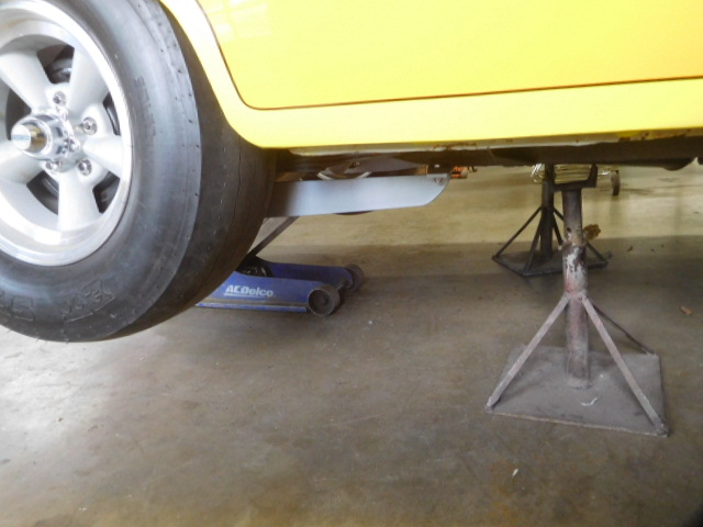

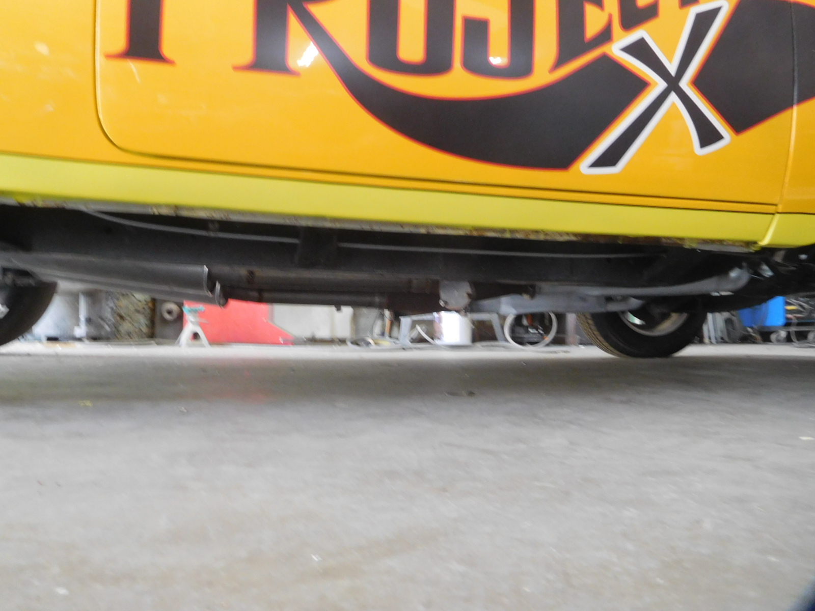

    Two more things off the list. I rounded up some 3/8 plate and cut some traction bars out. These will be like the Bill Thomas bars used on the original car. I couldn't find any out there,so I made my own using a spare set of spring pads. DSCN5402[1].JPG DSCN5405[1].JPG Screenshot 2024-03-12 221326.jpg Screenshot 2024-03-12 220404.jpg

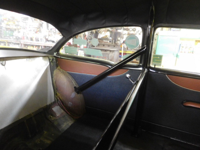

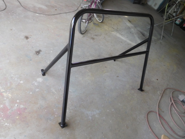

    I got the roll bar tube back from the bender and welded on the rear supports and cross bar, and painted it gloss black. I think it turned out nice. The rear bars drop down just as the original did from halfway up the window post through the fender dip in the quarter panel. DSCN5404[1].JPG DSCN5406[1].JPG DSCN5407[1].JPG Screenshot 2025-01-17 173913.jpg Screenshot 2024-03-13 200512.jpg

    The interior is nearly done. Just have to get the rear seat tonneau cover done and it's about ready. Still looking for some old school seat belt harness. Excuse the upper picture for being a later shot. It differs by the carpet color and the tach on the dash. The car was using black carpet at the time I'm replicating. The black carpet was under the rollbar mounts and this carpet was trimmed around the bar. Screenshot 2024-03-12 223044.jpg Screenshot 2025-01-17 173913.jpg DSCN5413[1].JPG
