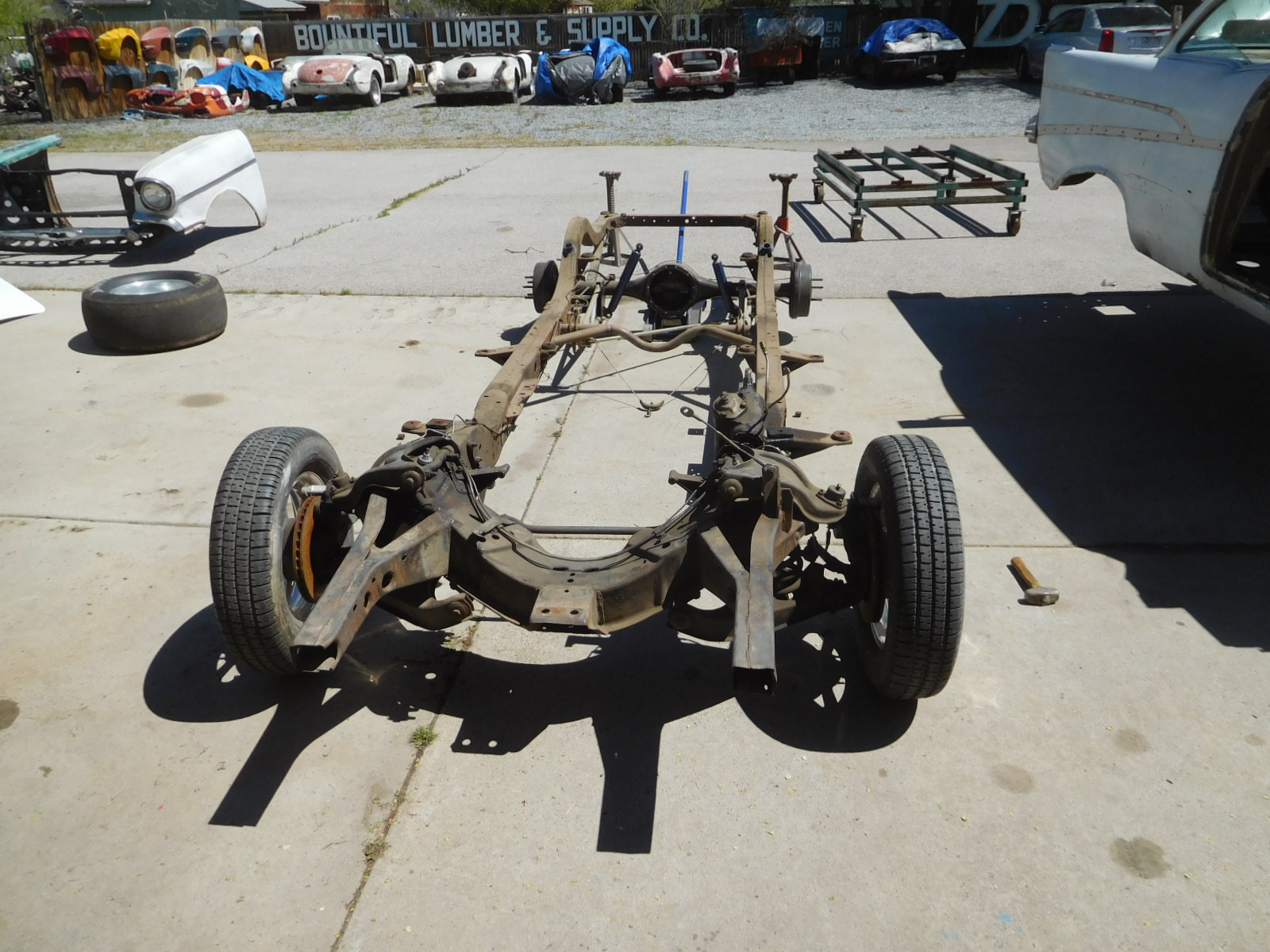

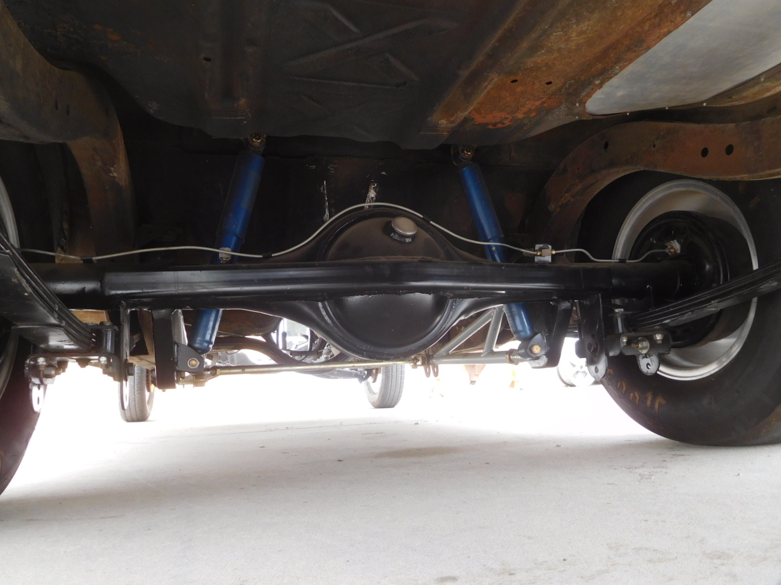

  10. Utahvette
    Joined: Sep 4, 2012
    Posts: 480
    Utahvette

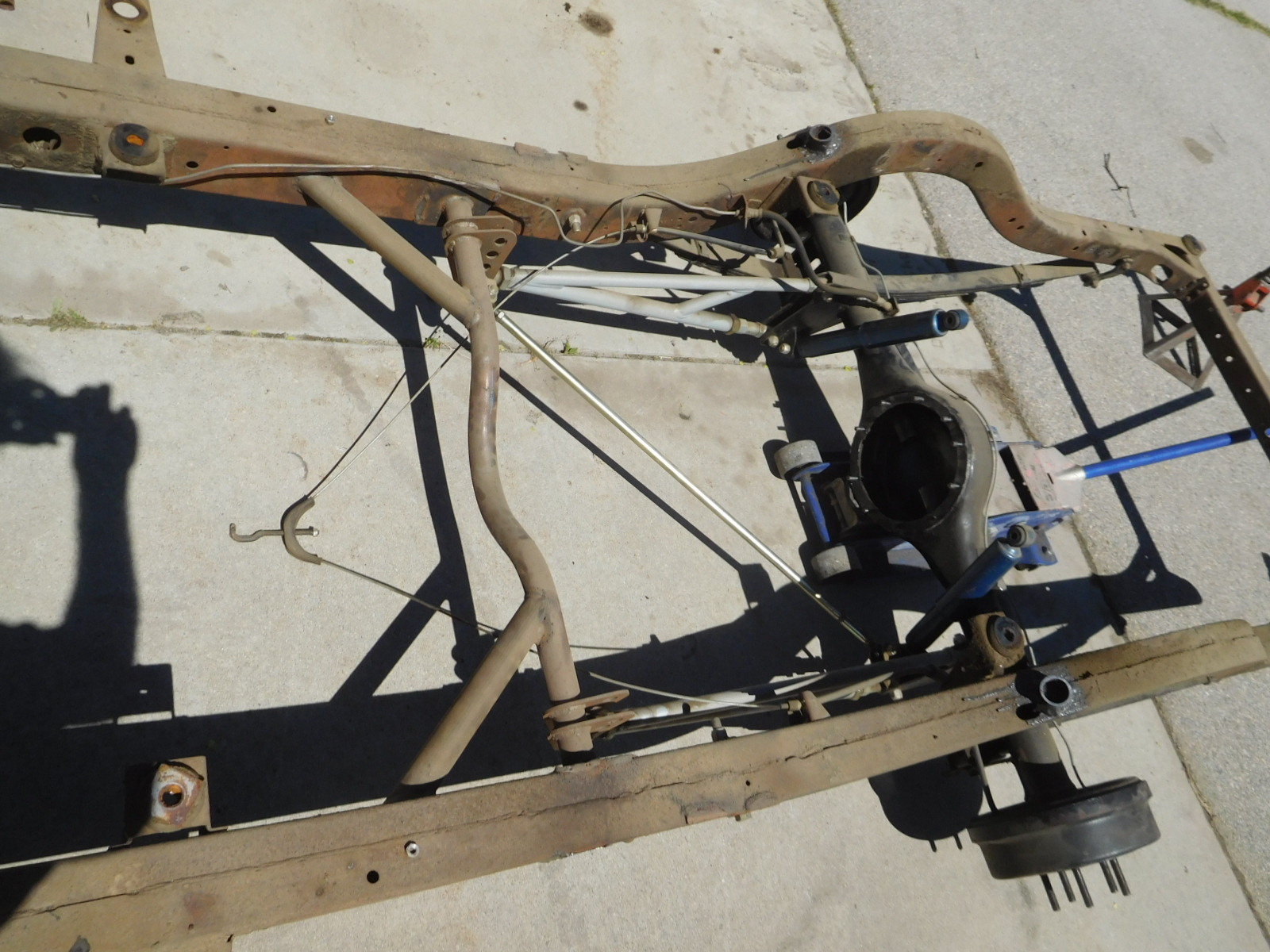

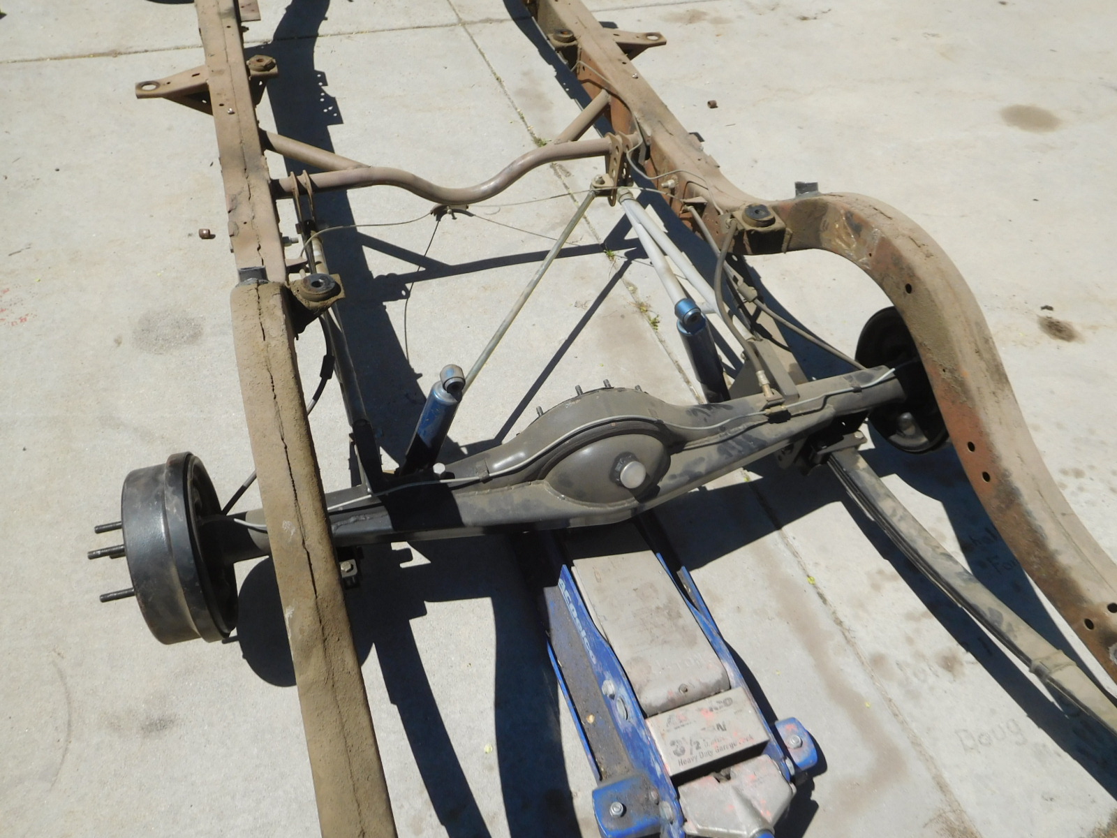

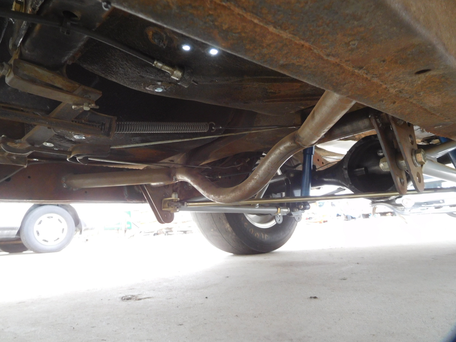

    I've just about got this dis***embled as far as it need s to go. At this point it's a matter of some body mount bolts and the brake lines to get the body off so I guess I'm gonna pull it off. It will sure make it easier to restore the rear suspension. The previous owner installed a nice ladder bar set up and moved the rear springs to under the frame. All that needs to be changed back to stock and it would be so much simpler with the body off. Cutting, grinding and welding while laying under a car is not as much fun as it sounds. DSCN4307[1].JPG DSCN4308[1].JPG DSCN4309[1].JPG DSCN4310[1].JPG
  11. chevy57dude
    Joined: Dec 10, 2007
    Posts: 10,349
    chevy57dude
    You'll be in a really good position to install a spring pocket kit while the body is off.

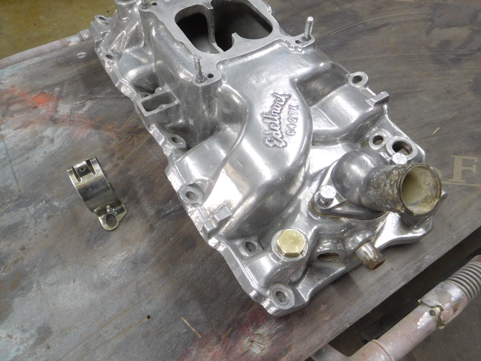

    Scored a polished Edelbrock C427X intake and coil bracket recently. Baby steps. Already have the Valve covers and one A.C. breather. Still looking for another breather and a Holley 3 Barrel carb. Good swap meet season is coming. 16.jpg DSCN4320[1].JPG

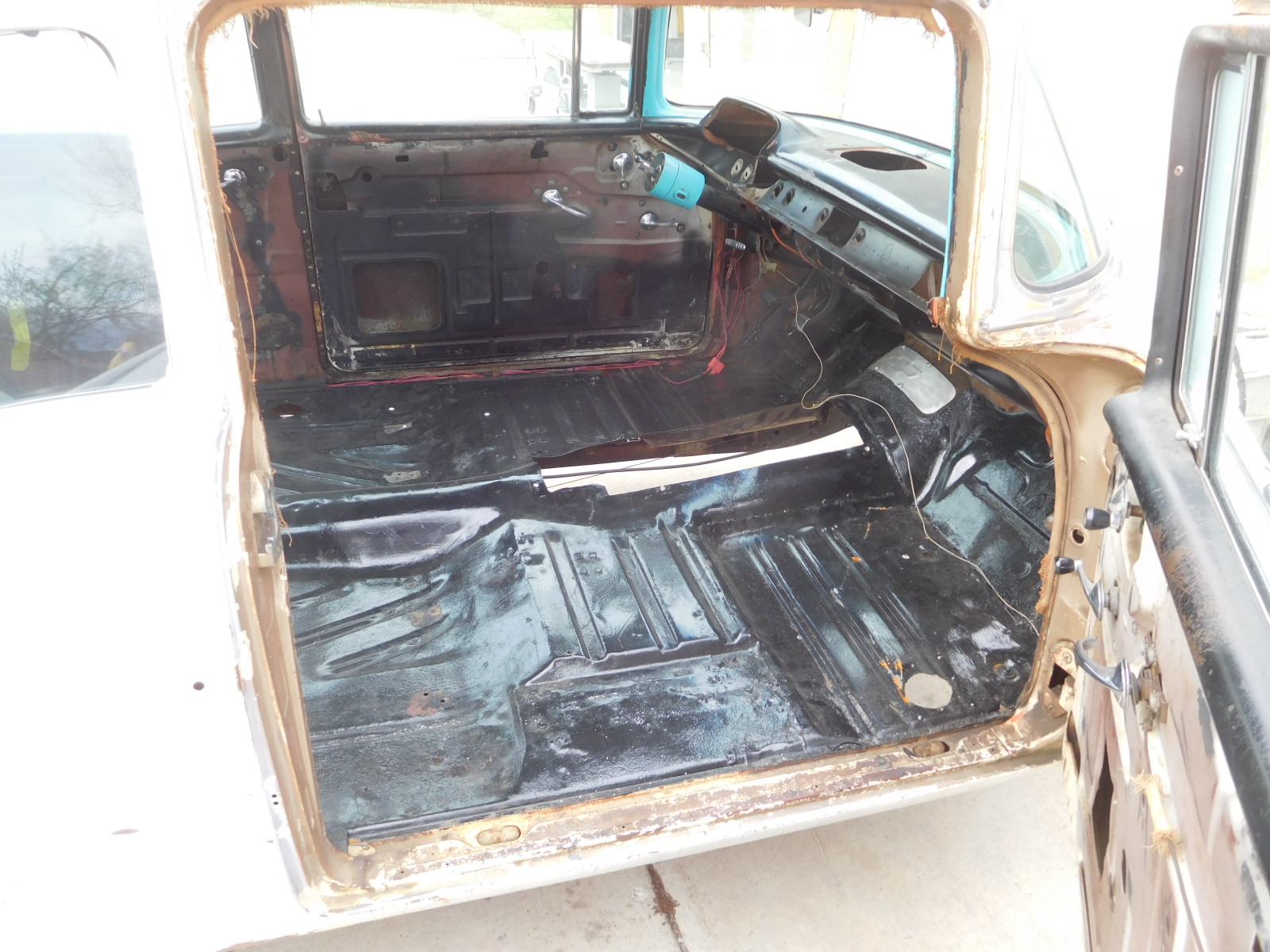

  15. Utahvette
    Joined: Sep 4, 2012
    Posts: 480
    Utahvette

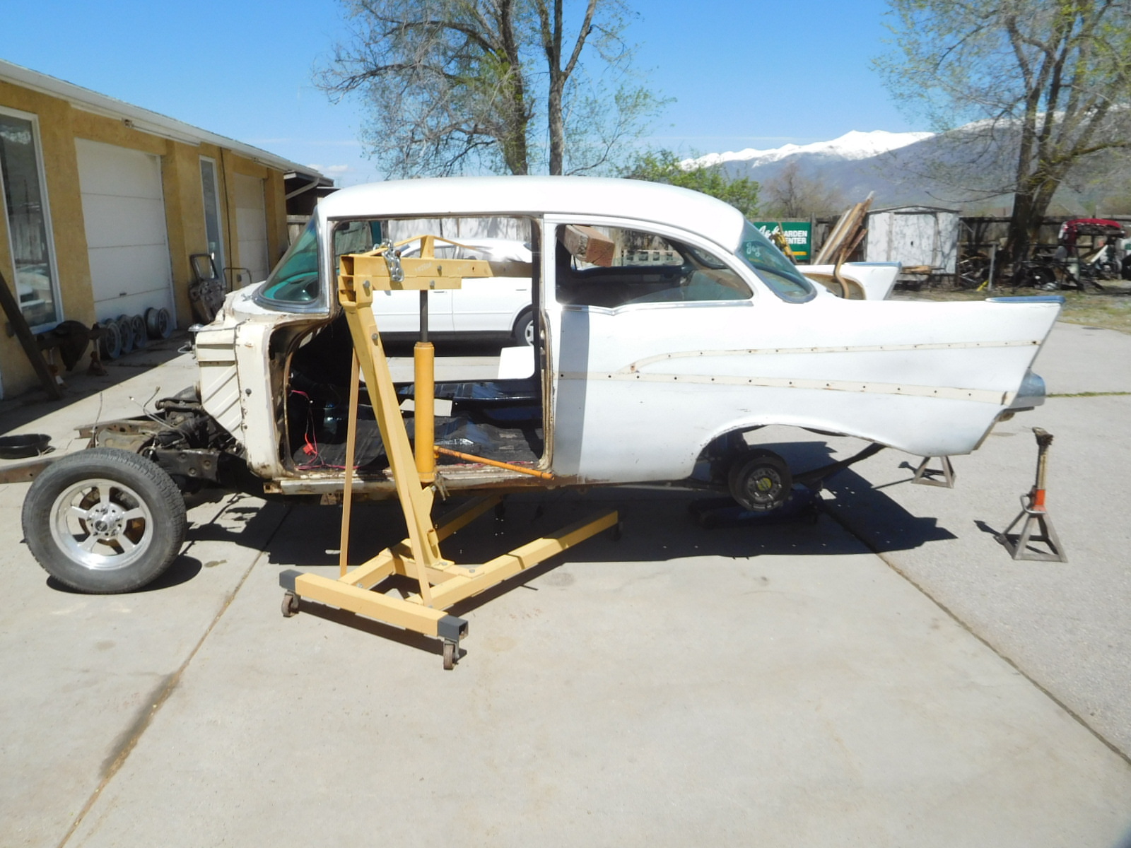

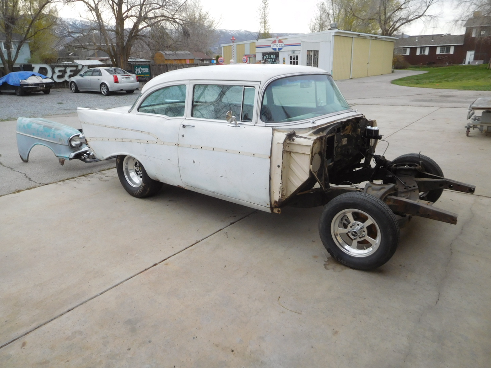

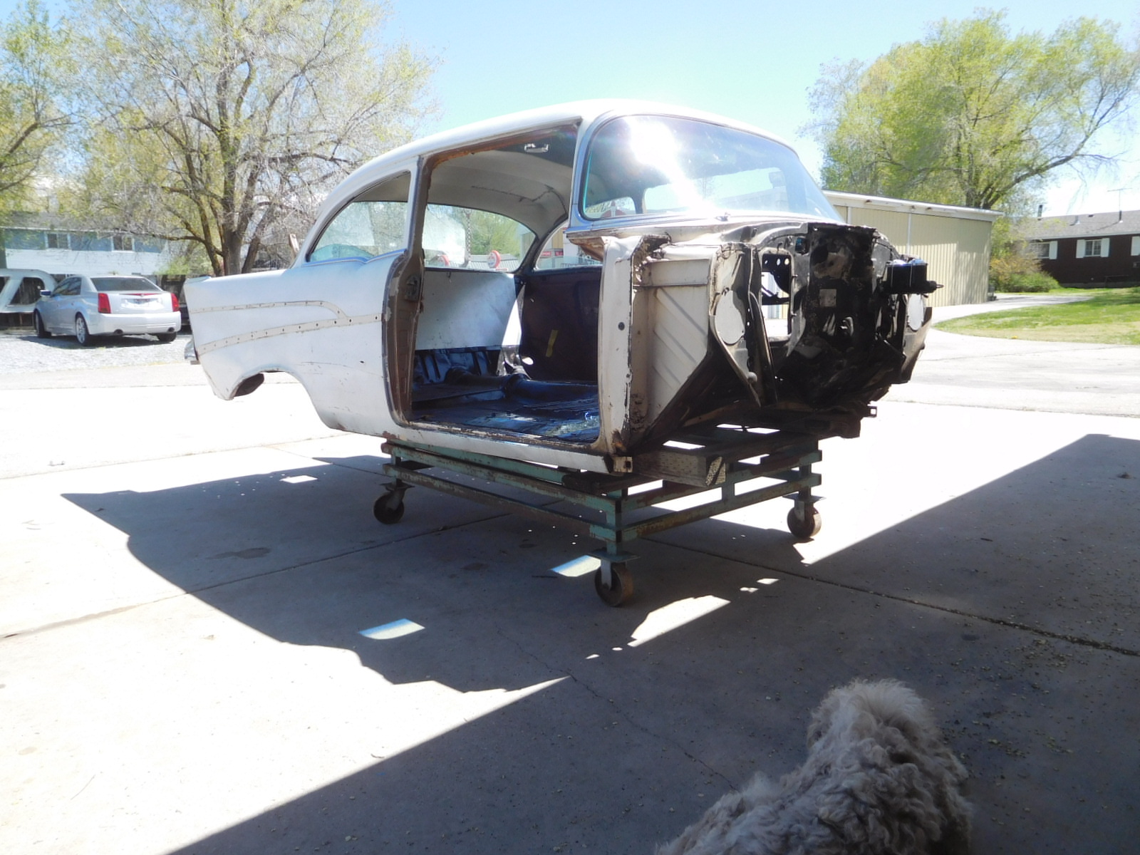

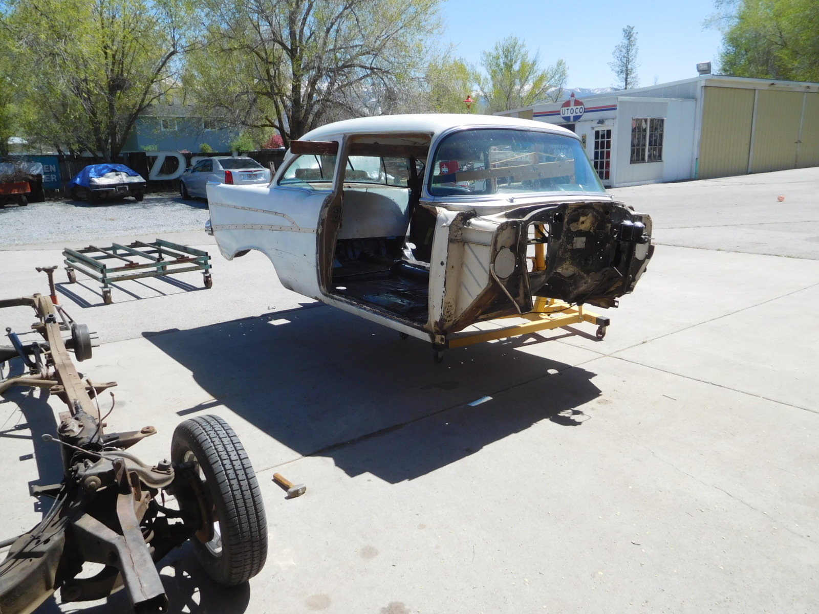

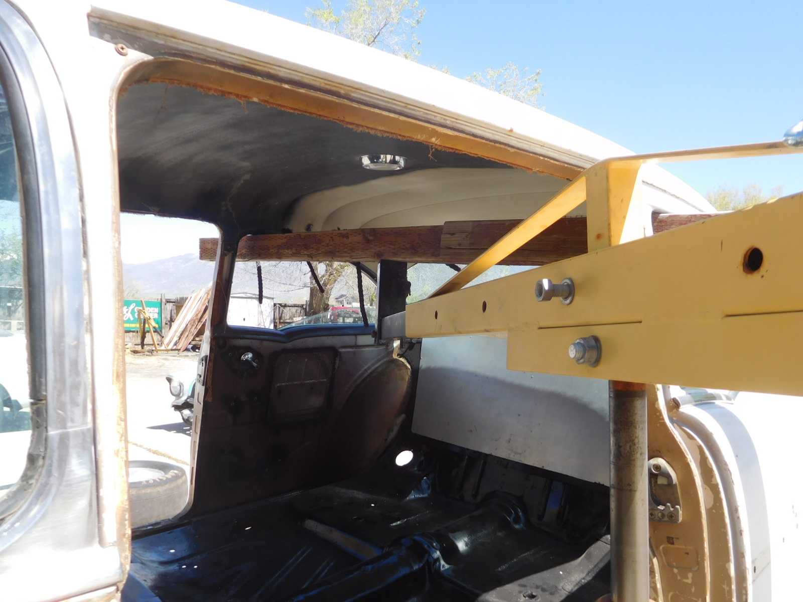

    Big Day! I pulled the body off. I'm a one man show so I had to improvise how to lift this thing without a 2 post lift or hoist of some sort, and with no help from anyone else. First I removed the doors and trunk lid to reduce weight. Then after removing all the body bolts(only broke two off), undoing the E- brake cable and the lines off the master cylinder, all that was left was the steering. The previous owner had adapted a rag joint to the box so it was simple to disconnect from there. With my plasma cutter I built an extension for my cherry picker out of one of the previously removed frame outriggers for the roolbar. Using a 4x4 fence post and experimenting with balance points, it turns out it is at the front of the back window opening. Making sure I positioned the cherry picker so it wouldn't be rolling over any cracks in the driveway, I placed the fence post through the car and centered the extension on the beam. It balanced perfectly and lifted right off. Pretty slick! I would estimate I only lifted it about a foot or so to clear the frame to remove the body sideways. I did have to take off the rear tires to gain additional clearance. Only took about 3 hours total. I know it's "hillbilly engineering" but necessity is the mother of invention and it did work after all. Now to chop out that nice ladder bar setup and put the springs back out board of the frame like original. DSCN4331[1].JPG DSCN4326[1].JPG DSCN4327[1].JPG DSCN4328[1].JPG DSCN4329[1].JPG DSCN4332[1].JPG DSCN4333[1].JPG DSCN4334[1].JPG

  17. phat rat
    Joined: Mar 18, 2001
    Posts: 5,159
    phat rat
    Utahvette, I'm a one man operation myself and your hoisting is similar to what I do except I have adjustable metal clamps with eye bolts on my 4 x4 and use chain over the top. I built a new much longer arm for my cherry picker that has a upright of 15". The original arm is just under 3 ft long. The new on is 81" long with the upright back 45" from the front. Too be on the safe side I wrapped the end of the tube on the picker with some 1/4" strap to prevent any splitting. I also built a piece onto the bottom back to hold counter weight if needed. I can easily lift bodies and truck cabs off my trailer now

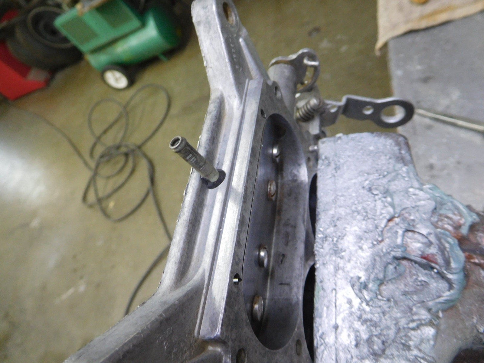

    Through the power of the H.A.M.B. I was offered a Holley 3 barrel for a good price. It was kinda crusty but had good bones, mostly. DSCN4378[1].JPG DSCN4381[1].JPG

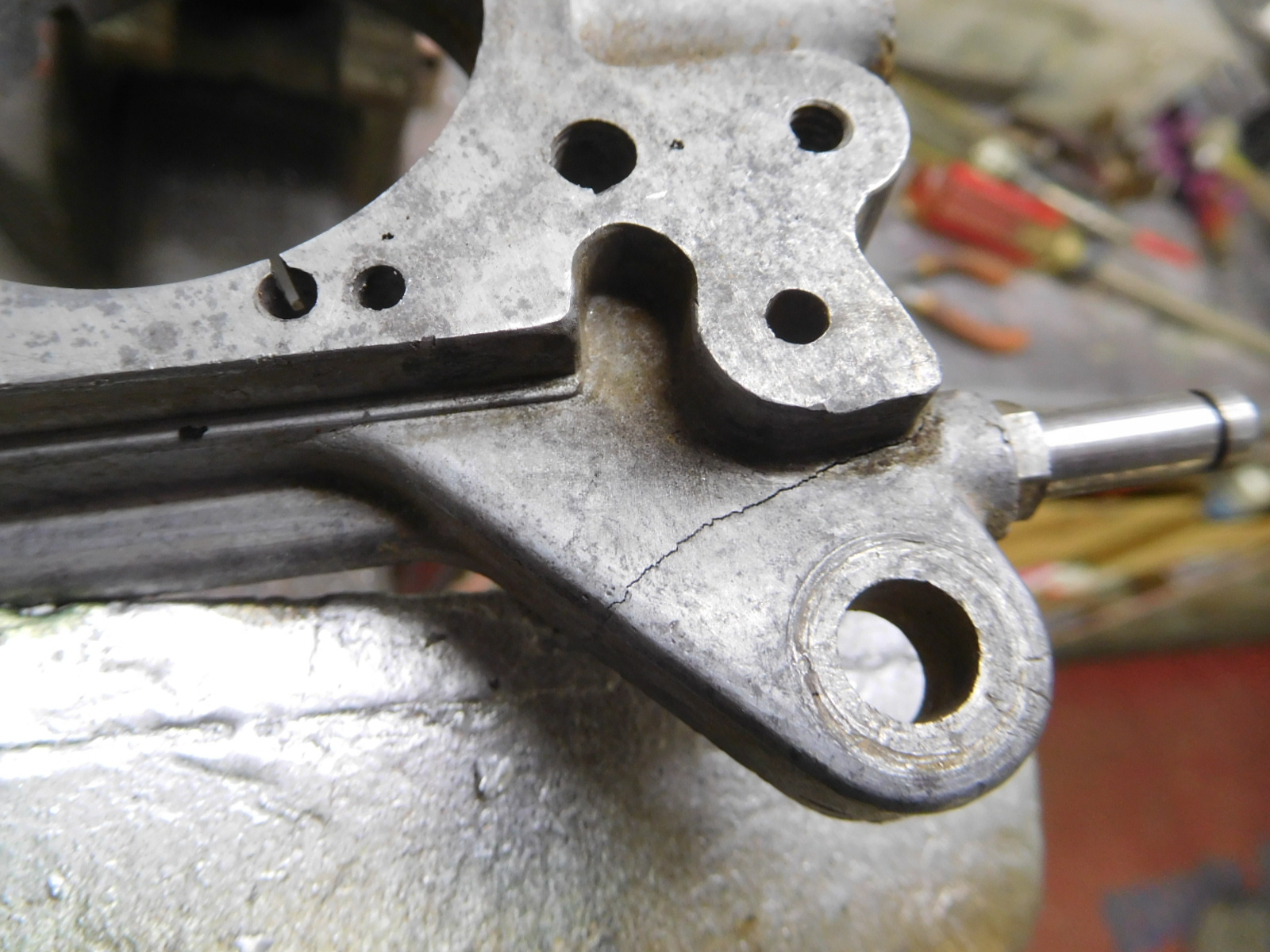

  21. Utahvette
    Joined: Sep 4, 2012
    Posts: 480
    Utahvette

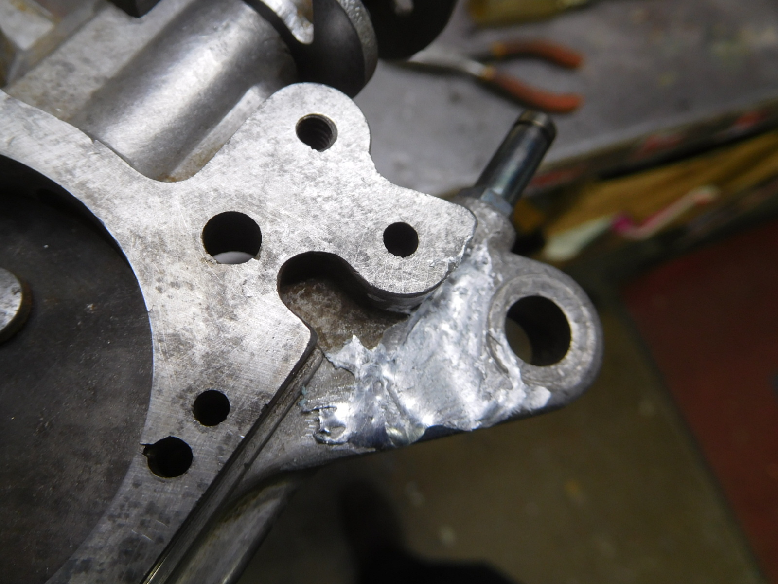

    The good thing was it was complete. The bad was the base was cracked. This gave me a great opportunity to try my aluminum welding rod. After V-ing it out and filling it with rod, It really gives the impression it's gonna work. DSCN4383[1].JPG DSCN4384[1].JPG

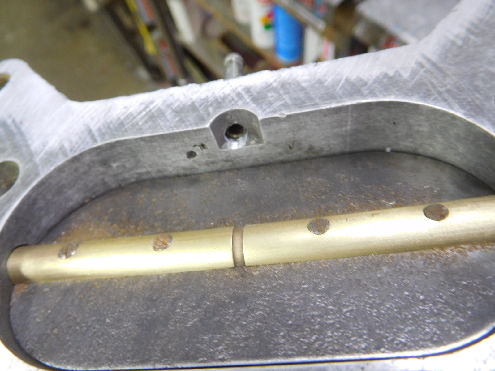

    I did add a vacuum take off for the distributor that was nonexistent. It only had provisions for ported vacuum and that's not the best for the street. DSCN4385[1].JPG DSCN4386[1].JPG

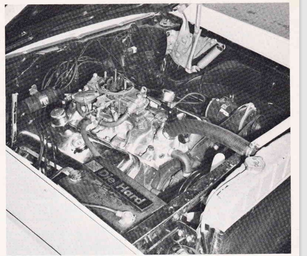

  23. Utahvette
    Joined: Sep 4, 2012
    Posts: 480
    Utahvette
    With the carb rebuilt and detailed, mocking up the top end of the engine gives a little encouragement. I even made up a matching fuel line with those stupid spring clamps and used the correct plugs in the manifold. Magazine pictures compared to what I have so far. I think it's going to be OK. carb.jpg 1`4.jpg

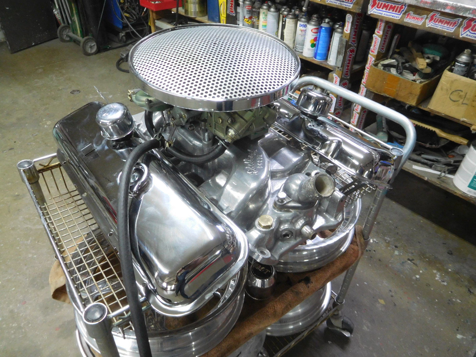

  24. Utahvette
    Joined: Sep 4, 2012
    Posts: 480
    Utahvette
    I may be getting a little ahead of myself here but I have this beautiful fly-eye air cleaner that might get used. They were all the rage back then. There are no pictures of the car with an air cleaner so why not? DSCN4391[1].JPG

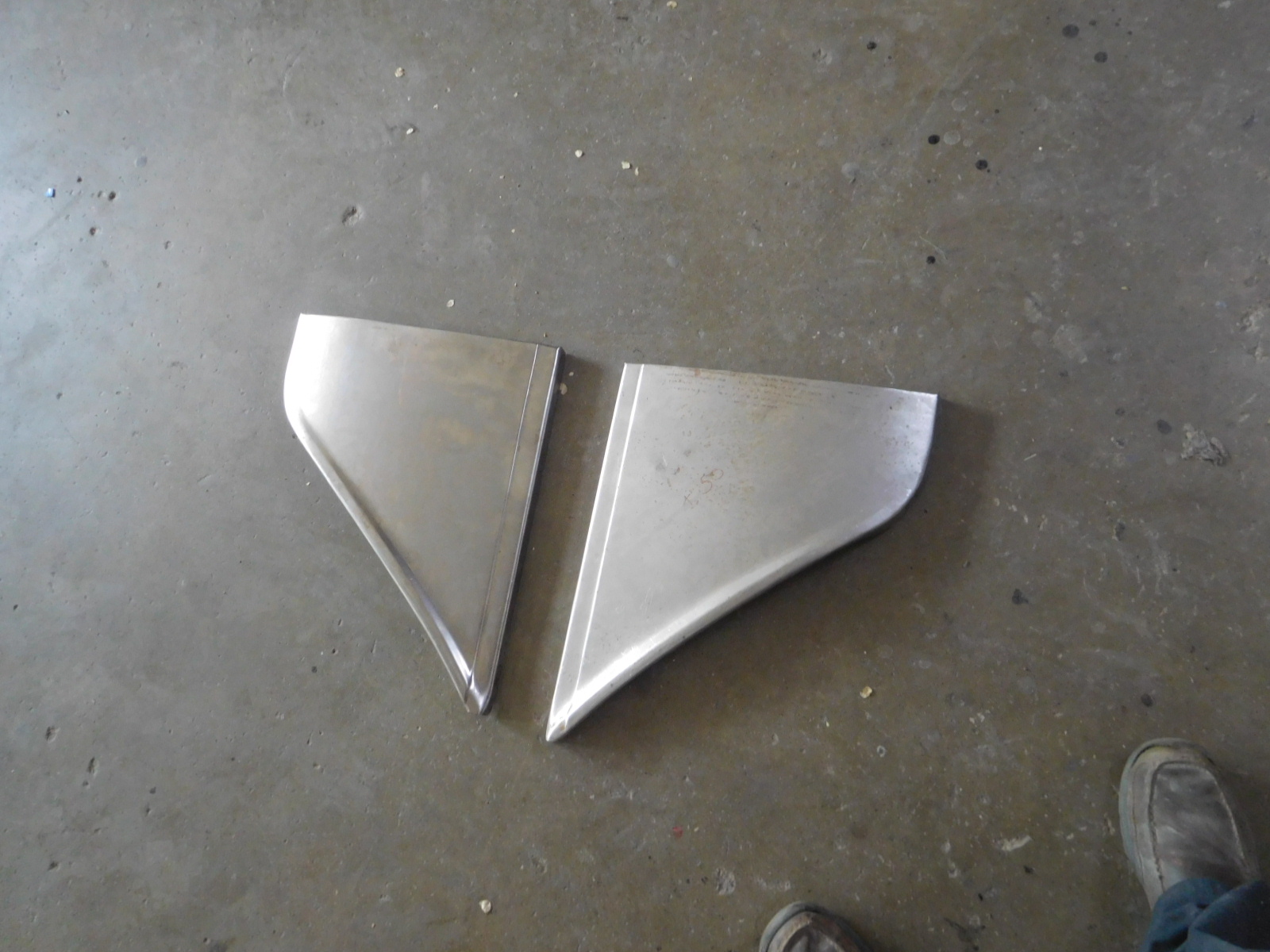

    Sold the MSD distributor for $325. Whittling the cost down now to $18,165. Picked up a manual tuning radio and a aftermarket coil that when painted black will look correct. Got a pretty good deal on a pair of lower fender patch panels at the swap meet today for $50. I was just going to cut and patch the fenders but for $50 I couldn't refuse. Got some leads on a seat and rear bumper that could work out. We'll see. DSCN4422[1].JPG DSCN4421[1].JPG DSCN4420[1].JPG

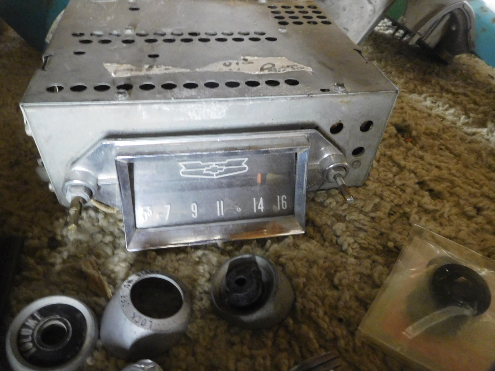

    Ever see an am radio where the numbers decend instead of ascend? Here's mine.

    Neat project. That radio was an aftermarket deal intended for that car possibly, thats why it fits so well. Some cars back then came radio delete...so the aftermarket stepped in. Ive even seen those kind of radios for first gen Camaros and even cars into the early 70s. Generally they were Motorolas.
