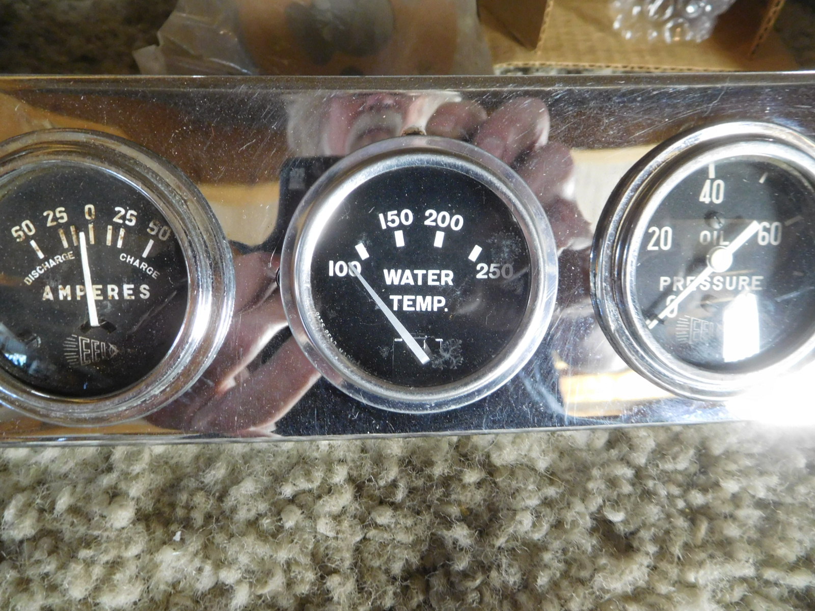

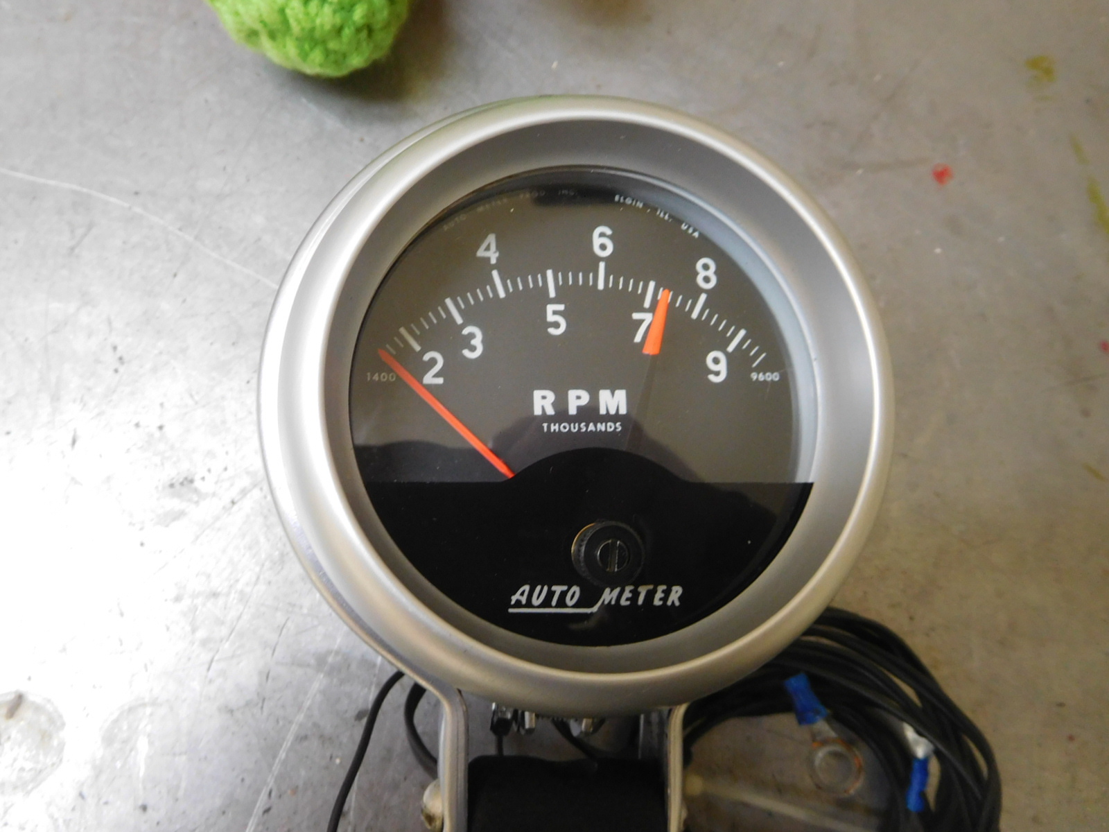

    The latest scores. I won a beautiful Auto Meter Tach on E-Bay. Recently got 2 of the correct Eelco gauges from a fellow Hamber. Having a little trouble with a water temp gauge but have a temporary one that's close for now. Bought a 3 gauge panel off E-Bay. Have friend that bought a bunch of Danchuk stuff 15 years ago and he's trading me a rear bumper and 2 lower rear quarter moldings, a trunk "V" and a few misc. parts for doing some work on his Dads 61 Vette. The previous owner found a body mount kit and dropped it off the other day. Things are coming together nicely. Most of what I need now are readily available repro parts. Except for that grill. I still need to check with Custom Grills, I think they can do one. At what cost though? DSCN4520[1].JPG DSCN4521[1].JPG DSCN4523[1].JPG DSCN4524[1].JPG DSCN4525[1].JPG DSCN4529[1].JPG DSCN4530[1].JPG

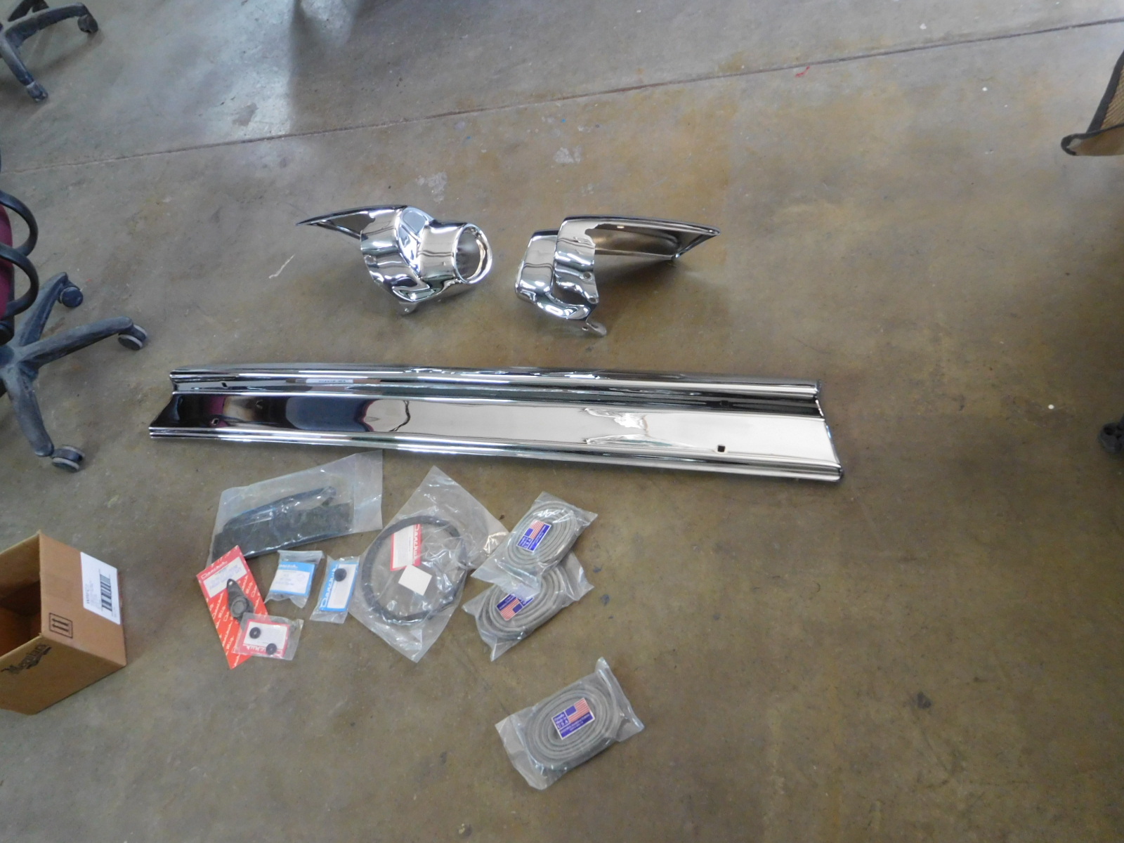

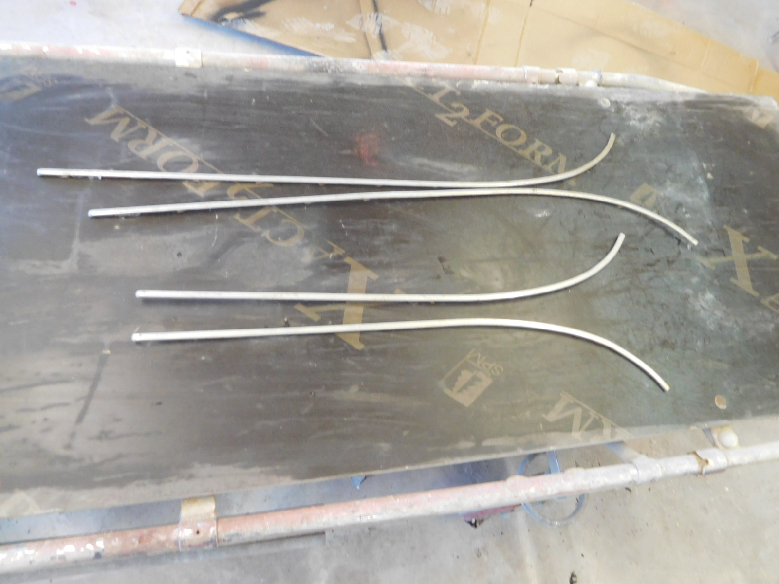

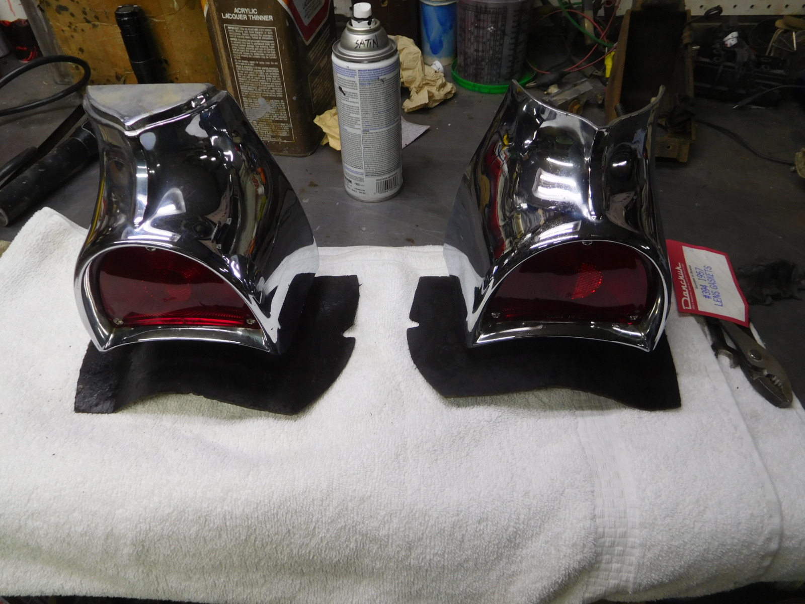

    Spent the day cleaning up trim. I had an ***ortment of tail lights to chose from and was able to come up with 2 pretty nice ones. No blisters or pitting, bright chrome, new lens and they were ready to go. Then on to the stainless side trim. After some straightening and buffing I have everything except a good left front fender strip. Mines been flattened and if they were unobtainable I could, with enough time, fix it, but they're only $60 so it wasn't worth 8 hours fixing the mashed one. Like all of my stuff, nothing is perfect, but it will have an acceptable overall look to it when it's finished. I've found that if you can settle for second best you can save a ton of money, lower your stress, finish the project much quicker and still have an attention getting car. The older I get the sloppier my work becomes and the more I enjoy it! DSCN4534[1].JPG DSCN4537[1].JPG DSCN4538[1].JPG DSCN4540[1].JPG DSCN4541[1].JPG

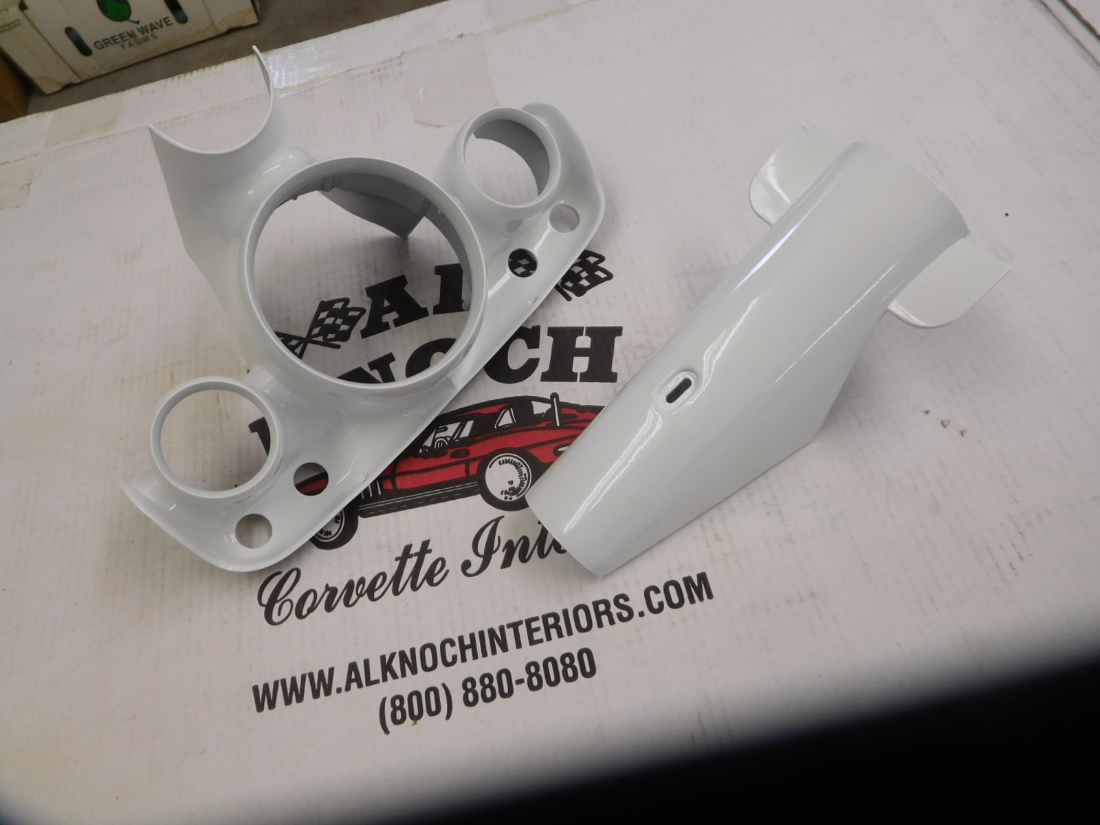

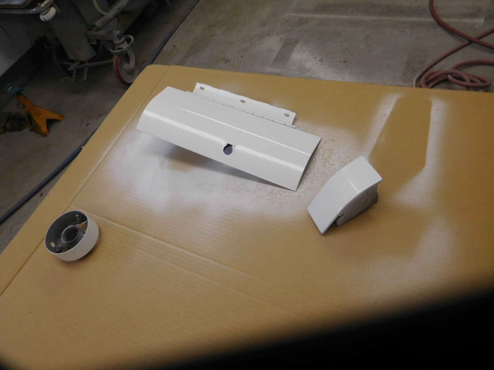

    I'm trying to complete some little sub ***emblies so that when the time comes the car will go together quickly. I took the instrument cluster apart and prepped a few other things so I could paint and get them ready to go back in. I cut off the shifter boss on the steering column and filled the hole. The painting turned out well.... except that the glove box and ash tray are supposed to be BLACK ! To busy to look at the pictures, that's me. Duh. It'll be a simple scuff and shoot to make them black but I feel kinda stupid. DSCN4638[1].JPG DSCN4639[1].JPG DSCN4640[1].JPG
    catdad49, Sharpone, -Brent- and 12 others like this.
  14. Think of the white paint as filler primer. Make the black paint extra slick ;)

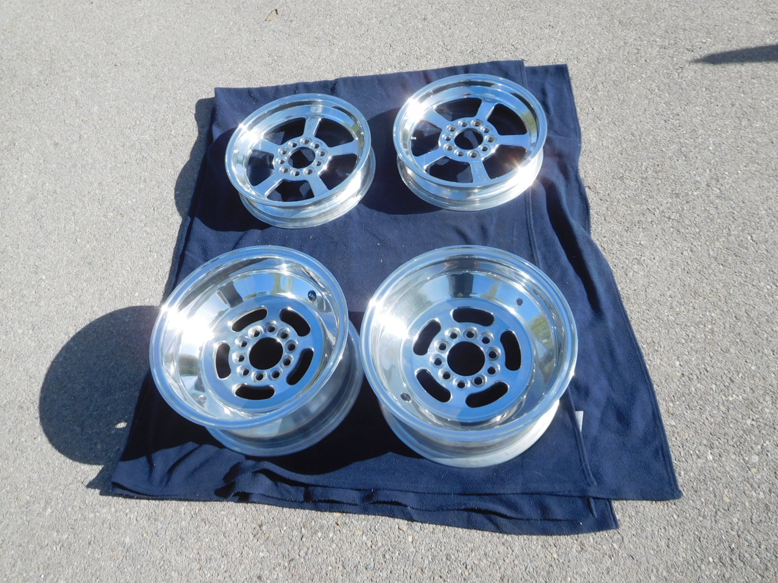

    News flash! I just sold the wheels off the car on E-Bay. That's -$1344.41. I'm under 16,000 now at $15974.77. Getting cheaper all the time. Maybe I'll make my goal. DSCN4340[1].JPG

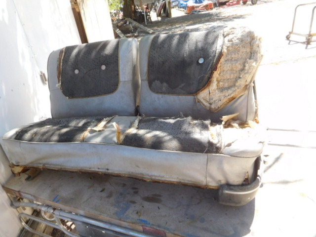

    My "traded for " bench seat arrived. As far as good cores go, this is really good! However, the car would no doubt be a tenth or so quicker with some light weight buckets. This thing is a tank. It is missing a side shroud, but I have some 4 door seat parts that I think can be altered to work. DSCN4798[1].JPG DSCN4799[1].JPG

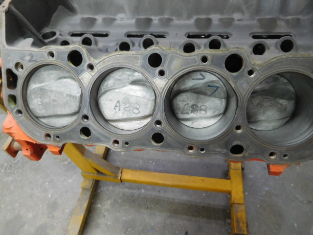

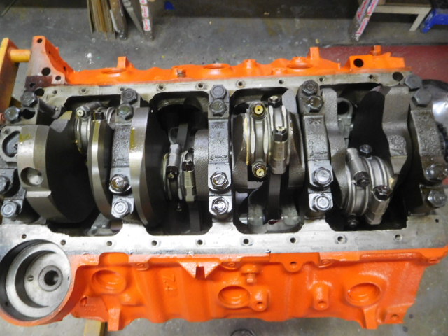

    Spoiler alert! I'm not going to use an L-88 427. I know, blasphemy. First of all, I don't have one sitting around and this is a budget build. Second, I've actually had some experience with a few genuine L-88's, and was not impressed. Yea, I know, "they ran 10's right from the factory." But my impression was, for an engine with a 1200 rpm idle and 12 - 1 compression, no bottom end power and miserable street manners, they just didn't run that good. Yes they made 560 horsepower stock, but really, that is small block territory now days. I have an over load of 454 stuff so it doesn't make sense to me to build anything else. It will look the same and run as good or better than the 427, and do it with better drive-ability, on pump gas. Another thing I have in my favor is that Project X didn't run that good with the stock L-88. According to the Magazine high 11's with a tunnel ram was about it. In fact, with the 3 barrel like I'm going to be using, it only ran low 12's, so duplicating it's actual performance won't be to hard using more cubes and better tech.
    For the engine I have a beautiful standard bore 454 that I got back in the late 80's and saved all these years. Chevrolet was having warranty nightmares with the 454's in the new trucks. I had a friend at the local Chevy dealer that was the heavy line mechanic in the service department. He was replacing those things weekly it seemed, and rather than s****ping them, as he was supposed to do, he was selling them for beer money out the back door, to me! I generally paid $150 for each one. I bought about 10 or 15 from him. It was a good time to be alive. The beauty of it was they had virgin standard bores and 4 bolt mains. At the time I could resell a bare 4 bolt main block for $500 so it was a win for me. The cranks were usually good and they were still the gen 4 style blocks so they used everything the old engines did. Who wants a standard block you ask? Well, I had collected some mint standard forged 454 LS-6 take out pistons from some racers that bought a crate engine and swapped out the 11 to 1 pistons for 12.5's. I got them for free! Because, who can use standard pistons? Everybody's block has to be bored(except mine). They even have the factory ink numbers on their domes still. Those coupled with the perfect bore block and some good aftermarket rods and I've got the makings of a killer short block for minimal outlay. The oil pump is a good used one. Yeah, I know, buy a new one, they're cheap insurance. It is a real nice used pump. High volume and looks good inside. I built a pressure testing fixture and it provides 70 pounds of pressure. I feel it's been tested over time and proved itself to be reliable. Why spend money to try something new and of unknown quality and made in china.The oil pan was the cleanest of the three I had to choose from. It did show signs that a few rods tried to escape out the side at one time but they didn't make it through. Any pan good enough to keep the rods inside is good enough for me. This is the basis for my engine build. DSCN4764.JPG DSCN4765.JPG DSCN4766.JPG DSCN4783.JPG DSCN4784.JPG

  27. lumpy 63
    Joined: Aug 2, 2010
    Posts: 3,602
    lumpy 63
    I got a couple of warrantee 454s out the back door of the local GMC dealer due to wiped out thrust surfaces on the crank from the T400 trying to push the converter out on some defective front pumps. Dress it like an L88 no one will know:D

    The four bolt truck 454 Mark IV blocks were used at the very end of production, late 80s to very early 90s, eh? I had one that I turned into a 427, it worked pretty good...the blower let it make power without a lot of cam or compression
    looks like you have a solid start to the engine
