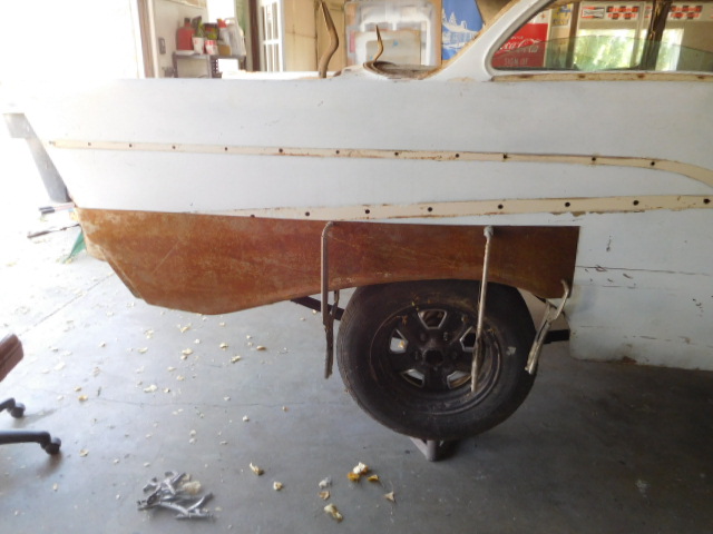

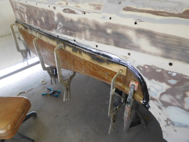

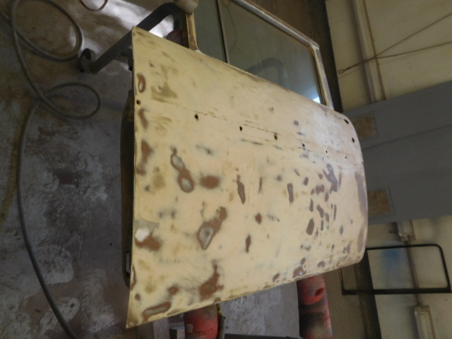

    DSCN4926.JPG DSCN4928.JPG DSCN4931.JPG DSCN4937[1].JPG DSCN4940[1].JPG Time to do some body work. The car came with a patch panel for the crunched and cracked right rear quarter. If I was a real bodyman I could straighten out and weld all the cracks on the original panel and fix it, but I'm not. I fit the patch over the fender and it covers all the questionable areas so I cut off the offending parts, and with a little tapping here and there to snug things up a bit, I think it's going to be perfect. Of course I should weld it on but from my past experience when I do that it makes a ton of work to grind the welds down and straighten everything that I warped, and it just isn't any fun. I bonded it with panel adhesive and a few clamps. No warpage and very little filling afterwards.

    Bonded? Exactly how did was this done? I don’t see an over lap. Did you place a step on the patch or is there a strip of metal over lapping both patch and fender?

    I've heard of panel bonding on late models but would be very interested in your process.

    The patch panels had a stepped flange across the top so you can overlap the parts. I used 3M panel adhesive to glue them together. I asked the salesman how much to overlap them and he said the factory's just use 1/4 inch. That didn't sound like enough to me so I used about 3/4 inch. I've used this stuff before and it works amazing. If I welded it, it would be a mess. DSCN4420[1].JPG
