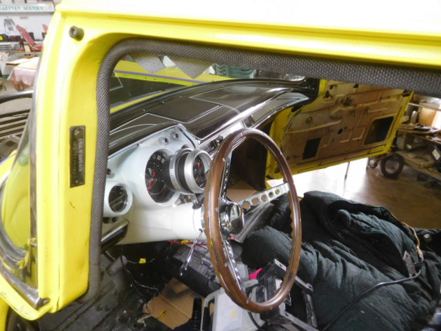

    I think I'm ready to install the engine and transmission. The firewall is blacked out and the throttle linkage is in place. DSCN5078[1].JPG

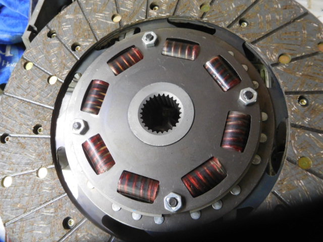

    I like these RAM brand clutch discs. They feature "poly coil" springs in the center. I've found them to be less harsh on engagement. Think about the regular springs and what happens when the clutch is dumped at high RPM's . They stack solid and "BANG" harsh impact! I liken it to hitting everything downstream of the clutch with a hammer. These springs can't stack solid. They will compress a little but with more of a "thump". It's my opinion that these substantially extend drive-train parts longevity. I have successfully run T-5's in conditions that I feel would be beyond their capability and had no problems.

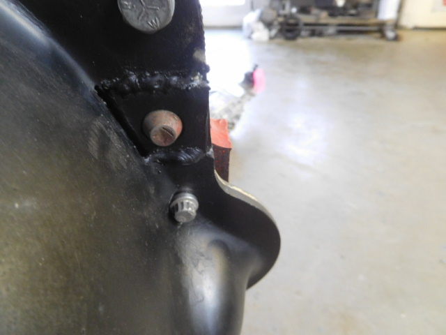

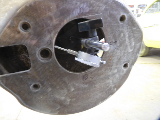

    DSCN5072[1].JPG DSCN5070[1].JPG DSCN5079[1].JPG After bolting on my new high dollar flywheel(that came with the car) and clutch ***embly, it's time to dial in the belhousing to verify it's centered with the crank. Of course it had too much run-out and the "proper" way to adjust it would be with offset dowel pins. Well I don't have any of those and I want to get this done today so I came up with a different solution that really worked good. It sounds kinda severe but I cut out around the locating holes and centered the housing and then re-welded the pieces back in place. It worked perfect.

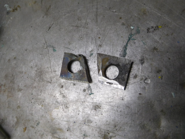

    The previous owner had removed the original fuel tank for a fuel cell. That's fine, at least he kept it all. The bad part was he also cut the tank hangers off, I guess to save weight? Anyway I had to fabricate some new ones and weld them in. The tank looks good inside and was reinstalled with a new 3/8 sender/pickup. The sender installs from the front of the tank and picks up fuel from the middle of the tank. I extended the pick up tube about 6 inches so it would reach to the rear of the tank to better collect fuel during acceleration. Fuel starvation can be a real problem on cars that pull hard unless you run a full tank. of gas. DSCN5077[1].JPG

    Time for mounting the steering wheel. In all my junk I don't seem to have a chrome steering wheel bell the proper size. All mine are to large diameter. The wheel off the car had a black one the right size, maybe I could strip the paint and polish it? Yep. Looks good. DSCN5095.JPG DSCN5096.JPG DSCN5097.JPG DSCN5112.JPG

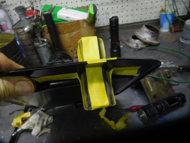

    I bought what I thought was a tube grill for a 57 off E-Bay a few months ago. Opened the box and immediately realized it wasn't . I stewed about it for a while and decided to see if I could alter it and make it work. since I wasn't having any luck finding a correct one elsewhere. The good thing is it was to big. I could cut it down. First modification was to take some angle out of the tubes and flatten the profile a little with out kinking anything. A couple of deep sockets slid in behind the tube and a curved half pipe to push on so it didn't put a dent in the face and it worked great. DSCN5102.JPG DSCN5103.JPG DSCN5101.JPG
