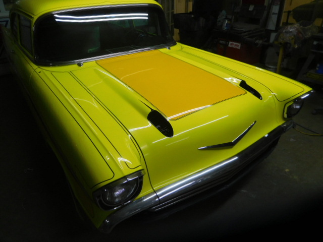

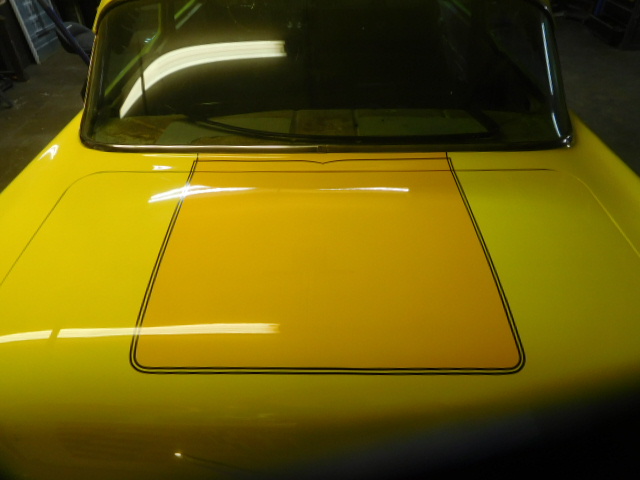

    Buffed out the new color and pinstriped the trunk lid. There are no good shots of the lid but I'm going to ***ume that the same treatment done to the hood and cowl was carried over to the trunk. It's hard to see in the magazine picture but it's double stripes with a whoop-tee do in the middle next to the window. I think it looks pretty good. DSCN5173[1].JPG DSCN5174[1].JPG DSCN5175[1].JPG

    So this is what 230 feet of pinstripe looks like. DSCN5176[1].JPG DSCN5177[1].JPG DSCN5178[1].JPG DSCN5179[1].JPG

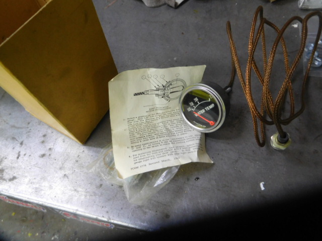

    I picked up a what I think is a correct temp gauge from E-Bay and the ****ers brand new! Thanks
    Moriarity for telling me about it.

    I did it with tape. I suspect Pop-Rod did the same back then. It was pretty popular. I think I bought all the tape with in a 40 mile area

    Buffed the hood finally and pinstriped the orange panel. Applied some Mascara around the hood scoops. The hood's just sitting on the car so I can get some enthusiasm. I'm still a long way from bolting it on. Wish my wheels would show up. It looks ****py with the rollers on it. DSCN5182[1].JPG DSCN5183[1].JPG 7.jpg
