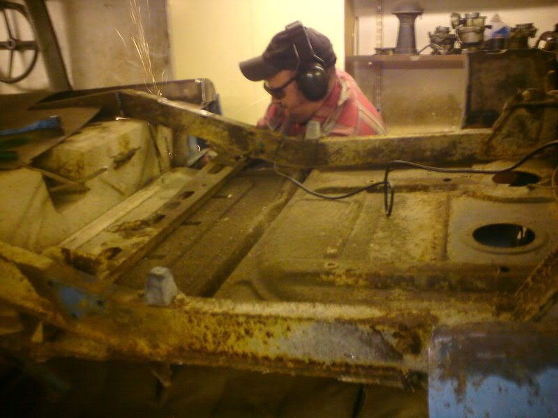

  6. Here is some pics of todays cutting and welding...:)
    Had to narrow the rear frame so the tires would fit. We cut of 4" on each side. Hopefully we will get the leafsprings and Volvo rearaxle in place tomorrow or Thuesday.

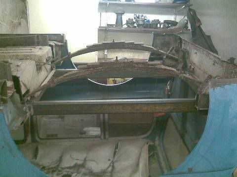

  19. While i was working today Kimmen made some progress with the G***er. He welded the new rear frame and got the leafsprings in place. He also finished the rockers and the second wheelwell and he cleaned up the rearaxle from all braces and stuff as u can se on the cellphone pics below.
    Stay Tuned as they say on TV!! :)

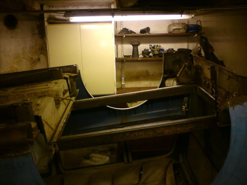

    This evening we just mocked up the rearend and starting to reworking the frontend. just got a pic from the rearend mockup. Stötte på lite patrull as we say in Sweden!!

    I have to ask.how wide is this rearend? and how wide is the body on the van? Looks in the pic as if the outside of the drum is only a few inchs away from the body. Oh this is just getting too cool can`t wate to see it upright on wheels.
  27. Carbody is around 58" wide and the rearend is 53" and the rear with tires is 68". So the tires vill be about 5" outside the body on each side.
