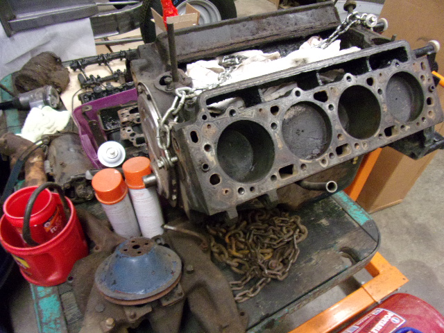

    Started pulling down the 331 and it has the stock bore and little to no ring groove. Need to finish dis***embly and hot tank the block and check for cracks. A buddy recommends Ballos Precision Machine in Richmond for the machine work. Anybody have experience with them? 102_0840.JPG
    kidcampbell71 likes this.

  30. Any chance you can hone it and ring it? Are the bearings useable?
    Charlie Stephens
