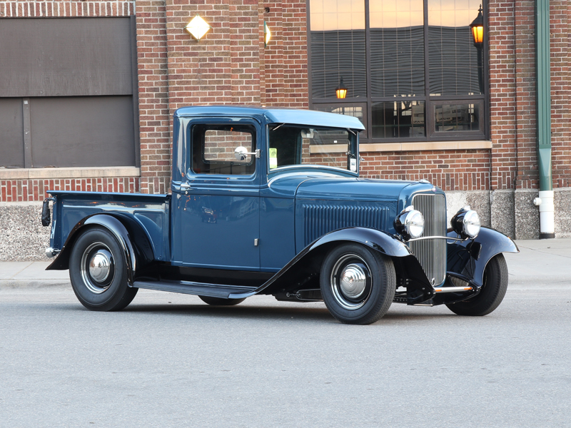

    Street Rodder Magazine's 2018 Road tour vehicle was a 1932 Ford pickup. It's pretty much all aftermarket, they used one of those bodies from Union Pacific and a frame from The Roadster Shop. They put out a special magazine covering the build, you may be able to find it on your local newsstand. Granted, being Street Rodder Magazine it is a street rod :) but it may be useful to give you some ideas. There's some info on the truck on the Pete and Jakes website. https://www.peteandjakes.com/street-rodder-road-tour-1932-ford-pick-up/

    I don't know what's under the hood (sbc?) but I don't see any billet gee-gaws, graphics or mustang 2 r&p. Looks like a Hot Rod to me!
