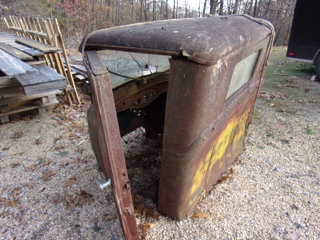

    wow!! I would think the drivers door would be worth more than the $200 purchase price

    That cab is rusty, rough, and thin. I suppose the doors could be saved but somebody would need them awful bad!
    I am going to run full fenders so I'll just hafta see how much I'll need to cut the firewall. Hopefully I'll be able to keep it to a minimum.
