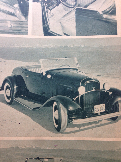

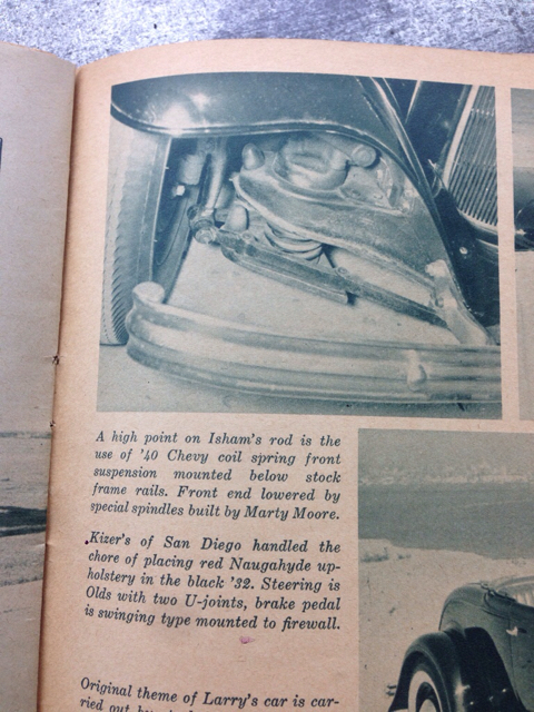

    ImageUploadedByH.A.M.B.1463682940.889321.jpg ImageUploadedByH.A.M.B.1463682969.307203.jpg
    I read through this whole thread and kept thinking back to an old article I had seen in a 1961 Hot Rod magazine. Nice lookin Caddy powered 32 with a 40 Chevy front suspension under it. Fortunately he left it full fendered so it's not drawing your eye to the suspension. The fact that the article stuck in my mind really proves this was an uncommon setup. Had it been a straight axle I might not have even remembered it. It may have been done more than we realize, but you really have to search hard in the old mags to find something similar. With that being said I would tip my hat to this guy for doing it like he wanted but I wouldn't call it traditional.
    Late to the Party and volvobrynk like this.

    That Chevy suspension was tempting to many who saw it dropped out of the Chevy frame.
    It was a whole unit, continuing production into the early Corvettes.
    (there was a certain number of 'rodders' that seized upon most items 'exclusively Corvette', as I recall) And the 'near bolt-in' fit?
    So, I'm surprised that more of those whole rolling units weren't simply dropped upon with 'A', '32, and Model 40 frames.
    ronzmtrwrx and volvobrynk like this.

  26. Bruce Lancaster
    Joined: Oct 9, 2001
    Posts: 21,681
    Bruce Lancaster
    "...old article I had seen in a 1961 Hot Rod..." Note also the U-joints in the steering (rare until the streetrod epoch, in the days of tradition steering shafts were solid from box to wheel, as God and Henry intended) and the swing pedals...these last became common VERY quickly after the '52 Fords came out, with people even buying the parts new before they became junkyard findable, but now no one seems to choose them for "traditional" cars.
    Don't tell that thing has an electric fan...
    volvobrynk and fhuket like this.
