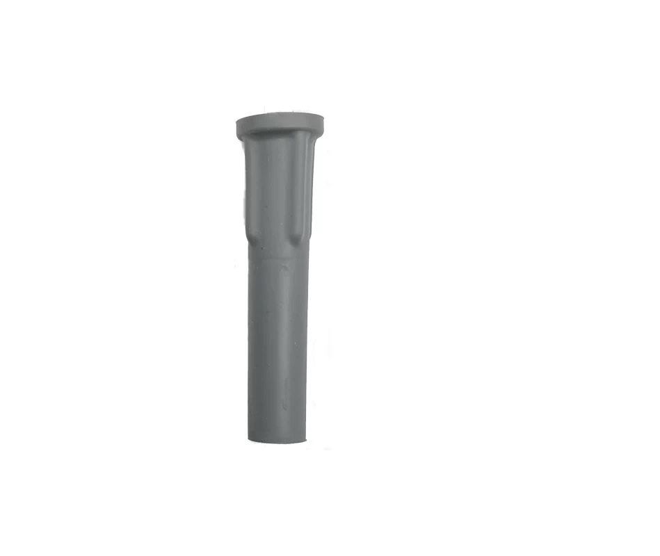

    I always used a spark plug boot to hold the plug. These were my favorites. Long, nice flange to pull on and the flutes to help with spinning. They worked on almost everything. Much preferred to sockets or other aids. You could easily install quickly and wouldn't exert enough torque to cross-thread.
    On a hemi, the end could hold a big flat blade screwdriver if there wasn't enough room between the tube and the end of the boot.
