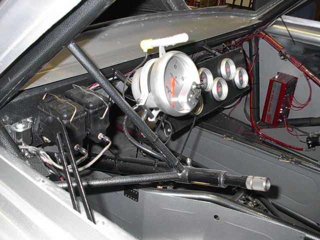

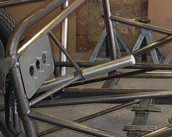

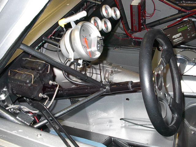

  11. ProEnfo
    Joined: Sep 28, 2005
    Posts: 1,498
    ProEnfo
    from Motown
    I understood you, here's a few samples. Note that there is also a lower support before it goes thru the firewall...
    CC
