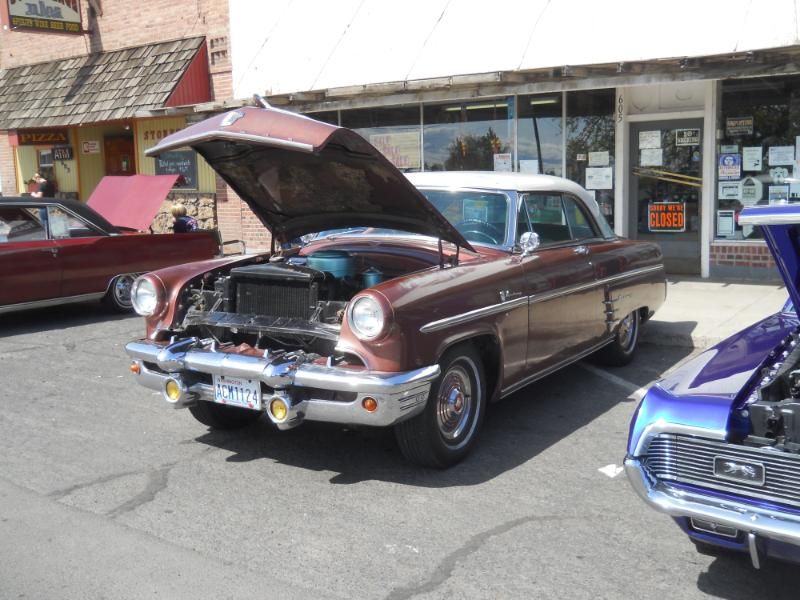

    This^^^
    It's rust, rot and decay that one makes excuses to not fix correctly and most of the preservation nonsense just makes it look silly rather than just old and neglected. If it actually has decent paint with just a few thin spots a bit of hand polishing once in a while will give it that softly worn but well cared for look of an old but well cared for saddle or pair of boots.
    This is real "patina" Well kept, original paint, worn thin in spots because the old gent who had it kept it under a tarp for a number of years.
    The gent who owned it in the late 80's early 90's was a customer of mine who was afraid to drive it because the gas gauge didn't work. He couldn't grasp the concept that if you filled the tank every time and drove X miles and filled the tank again and figured out your gas mileage pretty soon you had it figured out how far you could safely drive on a tank and have some reserve and be able to closely estimate the number of gallons it took. A few years later I saw it riding up the freeway on a trailer.
    That is "patina" anything less is just ****py worn out old paint with rust and decay thrown in.

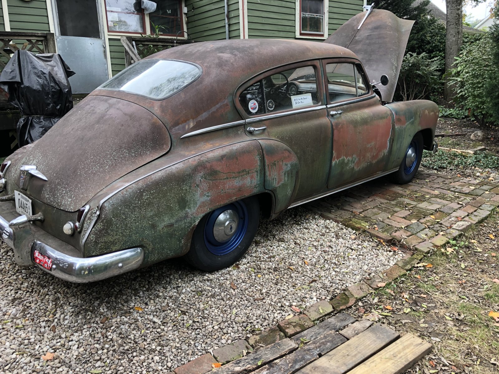

    1CD5AD7F-0CB7-4022-A8B7-4D3A798B74E2.jpeg Darn! So this isn’t “patina “?:rolleyes:
  18. That’s dang near perfection
    rod1, 05snopro440, Driver50x and 2 others like this.

    It may not be perfection, but it sure is fun to drive and see other people’s expressions when the “ old rusty whatever “ drives down the road! Oh , and I use nothing to enhance the patina, not even a car cover, just drive it.

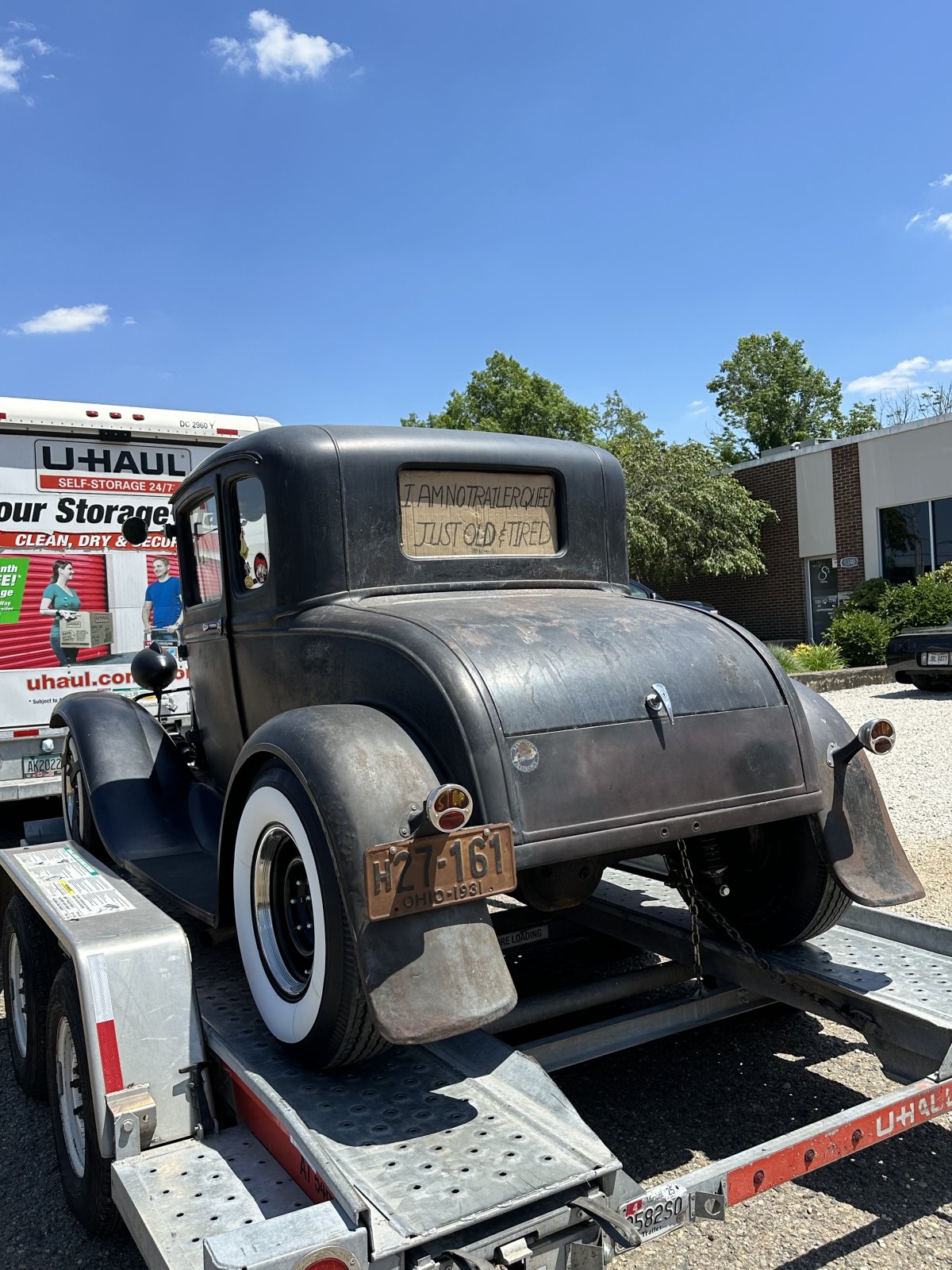

    Seal, prime, and paint.

    I dunno. Ordinarily, I would agree, but if he's talking about the nice little coupe that he posted in hot rod primer (or faded gray) I would drive that around a long time as it is before committing to the torture of a paint job.
    It screams Hot Rod to me....
