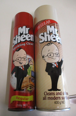

  11. I have had a can of this in the shed for about 25 years, and never thought to use it on the outside of a car. I am going to check if it has silicone in it, so I can keep it away from paintwork. (It's a******** to touch up if it gets on there)
    LeoSmalls and Tow Truck Tom like this.

    It does have silicone in it.
    Lots of bike guys swear by it. It makes clean up of tar/bugs/etc a breeze..... and has a nice lemon scent.:rolleyes:
