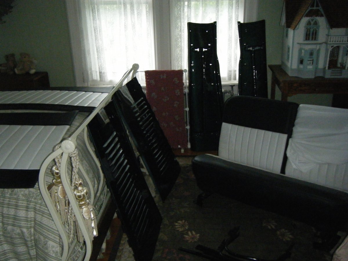

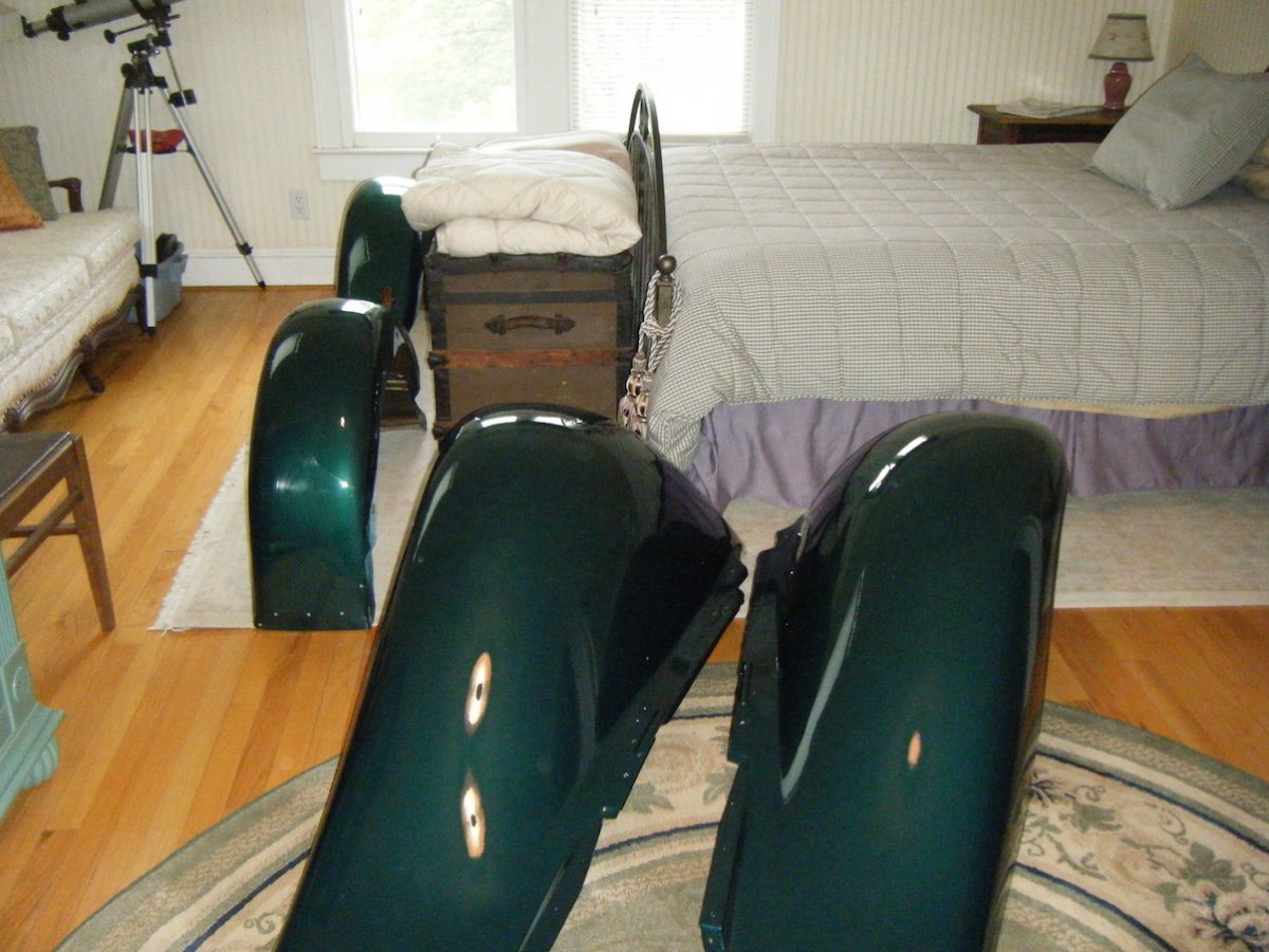

  16. i stored mine in the spare bedrooms......... DSCF4028.JPG DSCF4029.JPG be careful wrapping freshly painted parts in plastic. any solvents, still coming out of the paint, trapped by the plastic may ruin the surface.
    goodwill , salvation army have lots of sheets/fabric /blankets for wrapping stuff up, then they can be covered with a tarp
