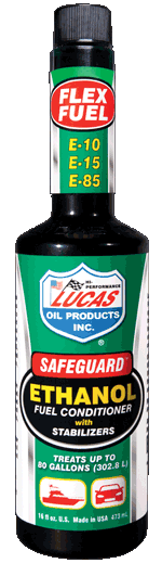

    I looked at wal marx and couldn't find any of the Star tron stabilzer but I did find some made by lucas. I bought a few bottles of it and put some in my car, tractor and air compressor.

    thats what i have been using to stabilize my E85.
