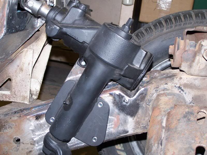

    we just did one of the "bolt in" PS boxes, I need to find out who it came from.
    We added an extra mount welded to the top of the frame, and had to use their modified center link.

    I dont have shots of the center link, but they shorten it and thread it.
    You can see where we had to notch the top of the frame, and with this setup it will be difficult to run column shift (we are on an aftermarket column). Also once you buy the box, pitman arm, "tierod kit" and have them modify a center link, it gets rather expensive.

    I was afraid of that. I've heard a lot of negative stuff about the product. It didn't exactly bolt on, but you have very capably made it work; your next surprise may come when you road test it. I've heard of everything from wandering to steering lock-up. I'll try to find links to the discussions I've read and post them.

    Initially the product seemed nice. We ordered the complete kit, and quickly were disappointed with the quality of instructions. It took a bit more work to mount the box than their limited instructions said, there was no way to put their "tierod kit" onto the centerlink. There was NOTHING in the instructions about it. After calling they said that they offered one already modified, I have NO idea how they ever chucked it up in a lathe to thread the end. We had to pay for the new centerlink, even though it is listed as part of their kit. Hooking up column shift will be slightly more difficult than a tri five chevy with a 605 box. We have had to make a box to recess the shift arm into the firewall.
    That is where we are now, it will be a while till the car is on the road, we will see how it turns out.

    Stay away from Gear Venders. I put one in a customers 60 Starliner last year, I love how they advertise "bolt in". Since when does bolt in involve a torch and welder? After a day and a half of bolting it in it drives like an old worn out box, not what we wanted for $1500 + labor
