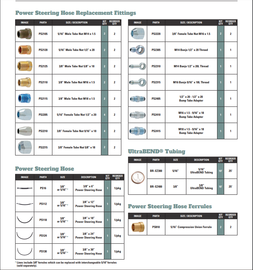

    I use these all the time. Just make the ends up you need and tighten Farrell fitting and done. They come in about three different lengths I think IMG_3060.png
    alanp561 and JohnLewis like this.

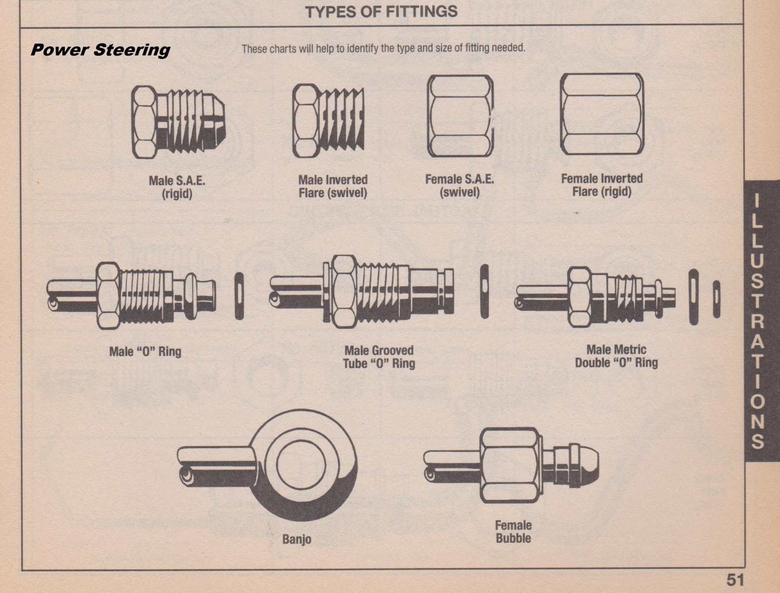

    Here is some info on fittings that also may help you adapt.

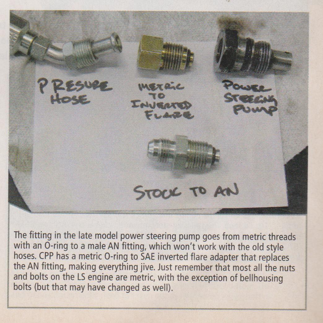

    I flared mine to the "Male O Ring" style to fit a Hydroboost master cylinder.

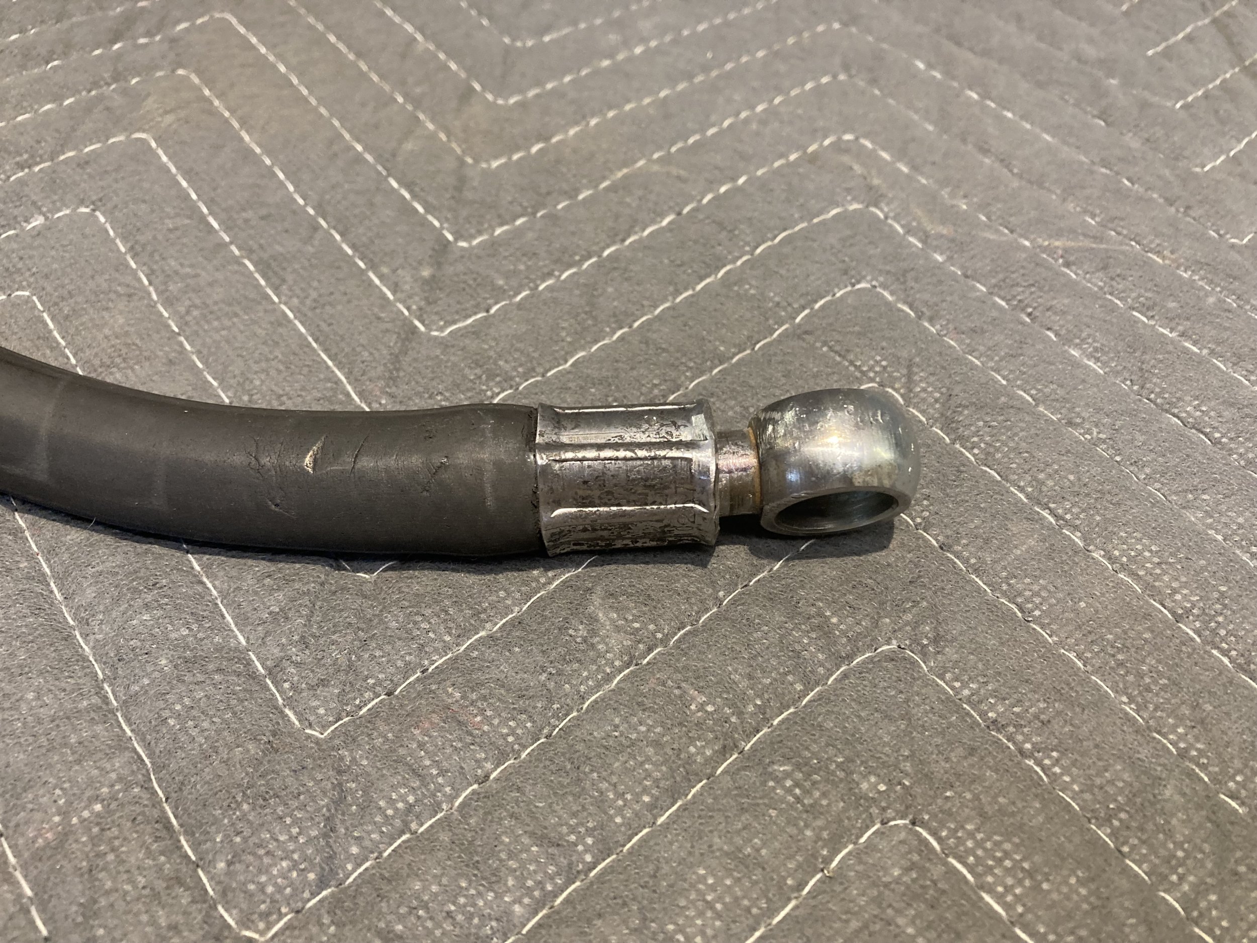

    The banjo fitting stem is 0.39 dia, and the hose is 0.77 dia when pushed onto the stem.
    The threaded fitting is 1/2-20

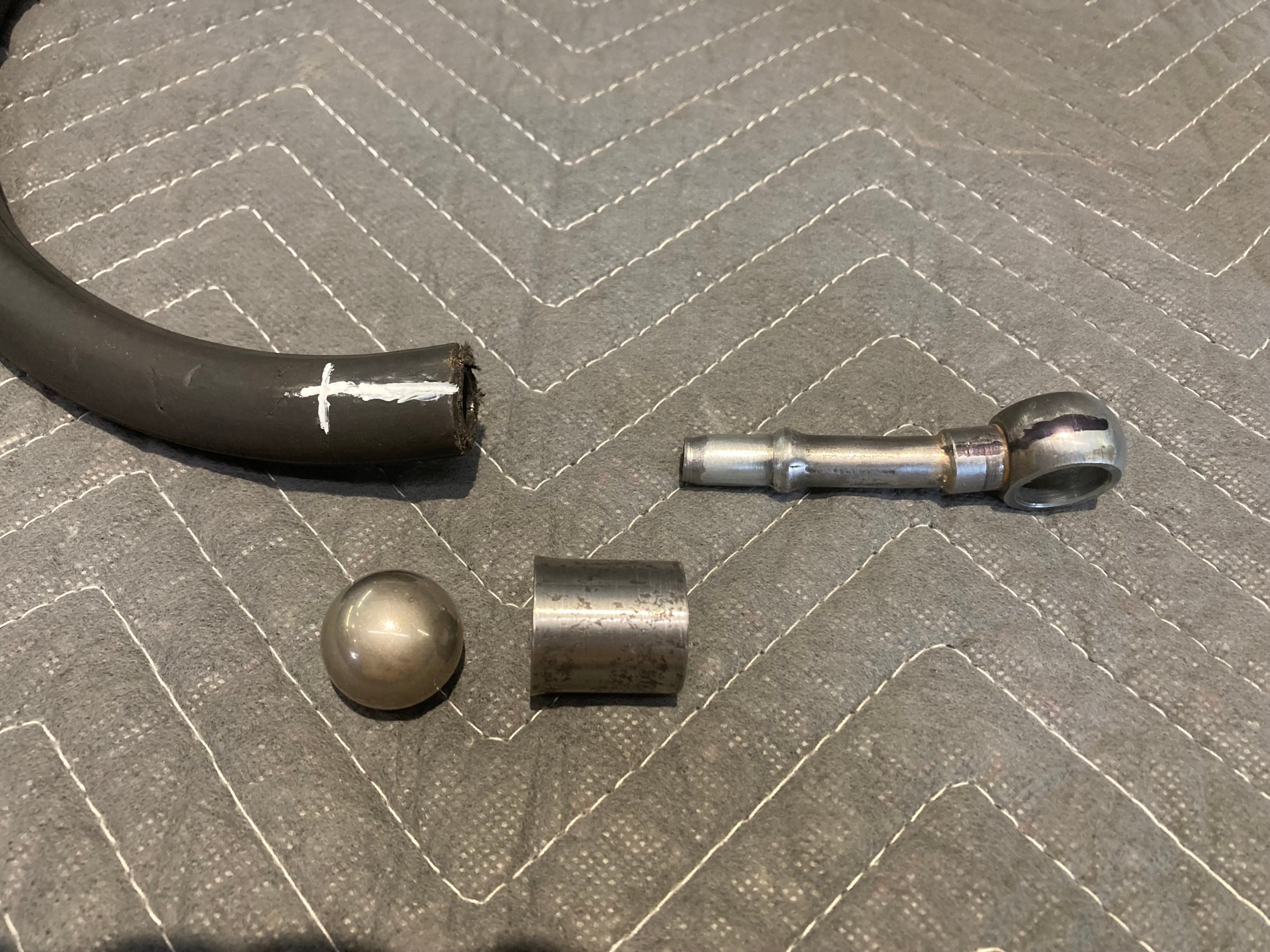

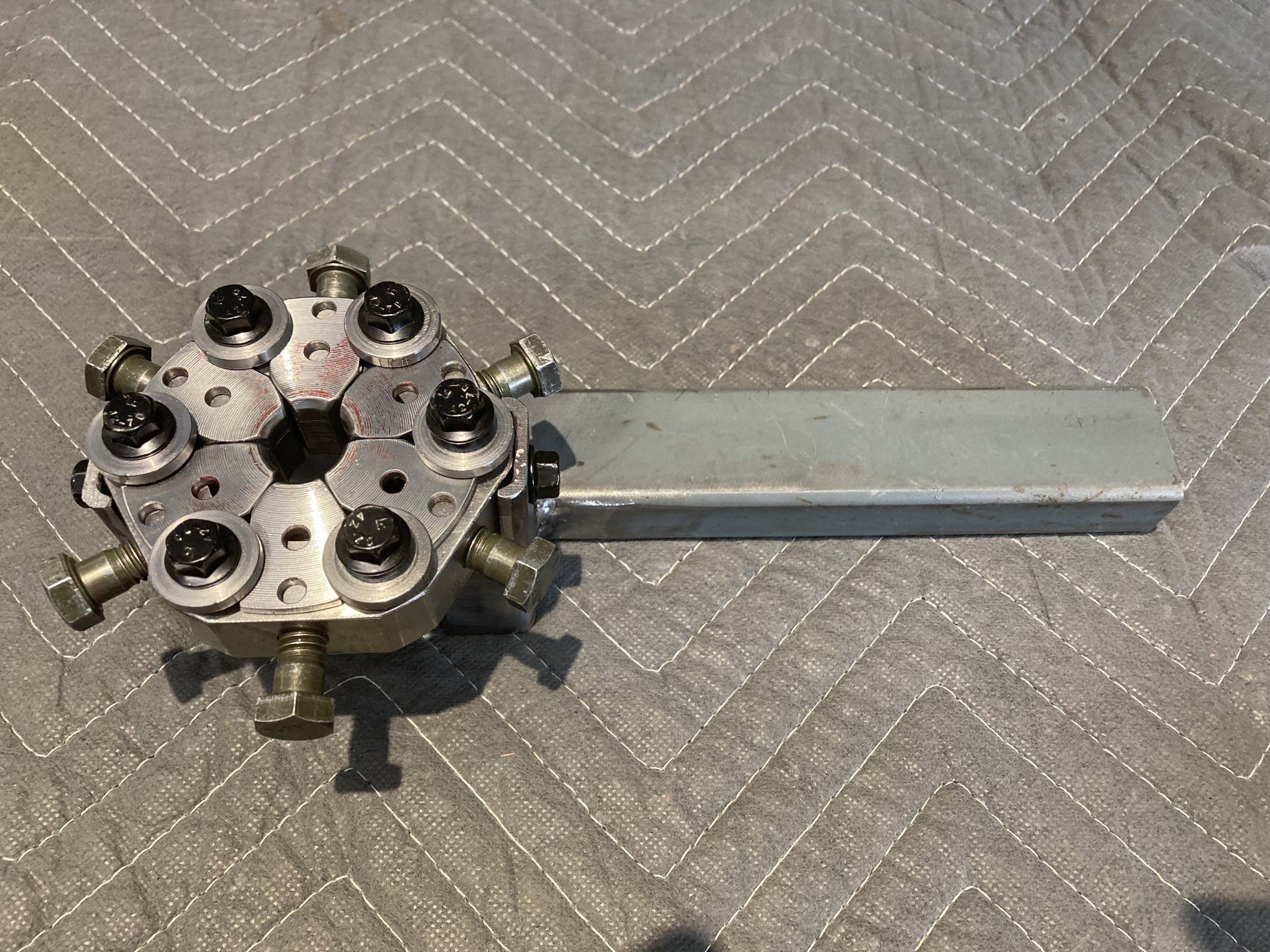

    After more fruitless inquiries for shops or businesses that might be able to do this, I took it upon myself to make a 6- sided crimper and ferrule to finish this assembly.
    Made a ferrule or sleeve out of A513 steel and flared the end slightly using a 7/8 ball.
    The material was chosen because it was relatively soft and hopefully wouldn't crack when crimped.
    No turning was done on the OD, the ID was bored to 0.750
    With quite a bit of force, the hose, fitting and ferrule were pushed together before crimping.
