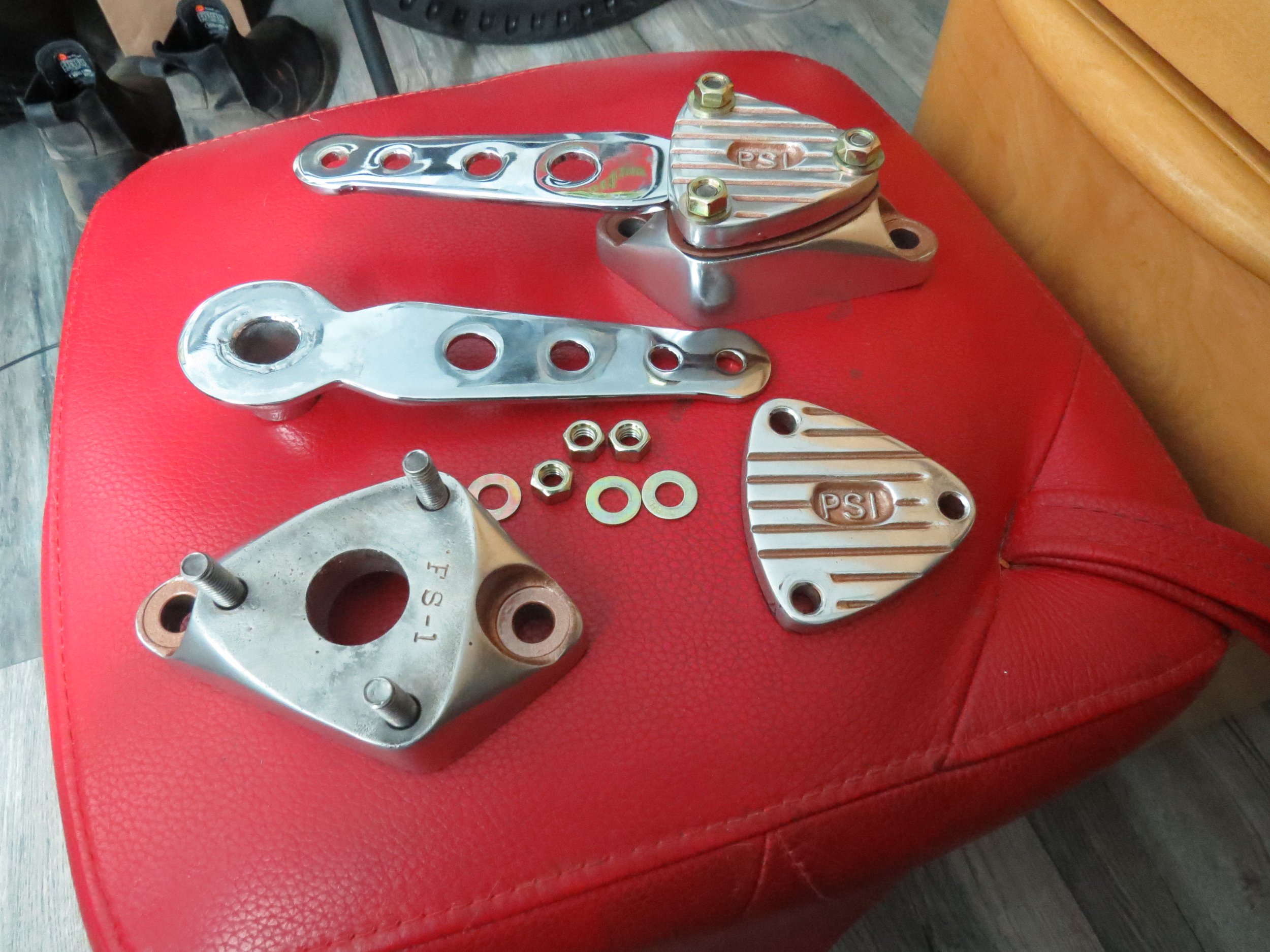

    Here is a picture of mine. Never see them. I detailed them for my A/SR project. Just need to find the material. I added holes to the arms. Chromed and polished. Pretty cool huh? Must use. 2024-11-09 08.59.42.jpg 2024-11-09 08.59.22.jpg

    @curbspeed if you can please take them apart so we can see the details of the cool shocks

    I don’t think Gene Scott sold a torsion bar front suspension, the Type III shocks were all steel and only designed to have their bases welded to a tube front crossmember. Type I and II had cast aluminum bases with steel covers but as seen on the photos from @curbspeed Gene later added cast aluminum covers with the PSI logo to all.
