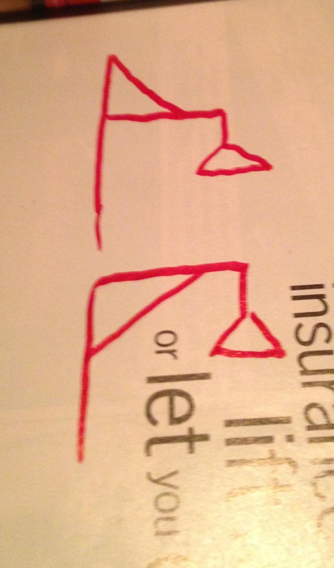

  5. Fixed Jib crane example a vs b weight is the same.
    Where's the load ?
    What where's the stress highest on these two
    Which needs to be thicker material. Why ?
    The top mount sag rod has the load above the weight, opposite for the low mount gusset.
    The top mount sag rod post will fail at the boom/post - low mount will fail at the gusset/post.
    Low mount gusset needs to be much thicker than the sag rod. The top mount sag rod post should be thicker because the weight is over a longer span.
