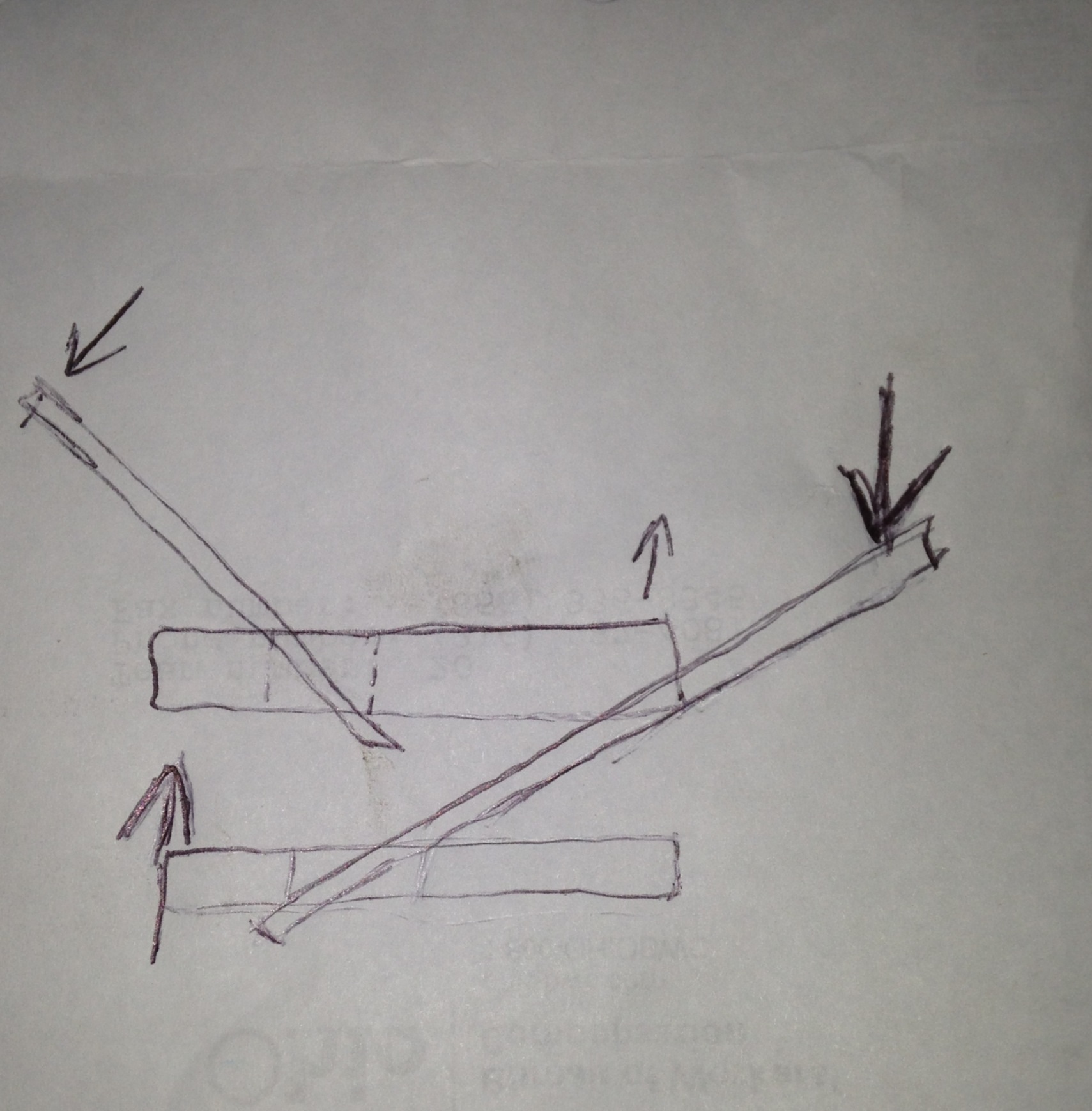

    31Vicky, Here is an example of a Free Body Diagram for the pictures you drew. All 3 have the same reactions at the supports because the loads or better stated (where the loads occur) are the same. What would be different would be the reactions or stresses WITHIN the structure.
    Think of the frame as a roof truss. Throw a given load on the roof and the walls will see some load. Now cut an internal truss support. That wall load remains the same REGARDLESS of how many internal beams you may remove. However when you remove those internal beams what you will change is the loading on each and every remaining beam - however the wall load will be unchanged.
    The interaction "concert" is very elaborate. I won't pretend to understand all of it.
    Now do I say this to disprove previous posts - no absolutely not. I tend to lean with the idea that the different structures have different stiffness and THAT may very well result in tangible improvements.

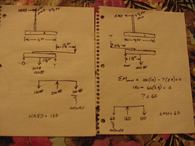

  10. Here's one of those hack pics LS and A likes to see.
    Demonstrating the bar thru the concrete slab.
    There is a bit of overlap in my doodle, but top doodle is pushing over short end and bottom pic is pushing over long end.
    I know very well that if I take a long enough bar to go under the front crossmember and over the rear, I can stand this ch***is on end.

    31Vicky, "Wrong" for applying what you see - unlikely. What can happen is drawing the wrong conclusions based on ***umptions mixed with limited observations. Been guilty of that myself more than I would like to admit.
    So IF I understand your question I see it like this - see pic. However to make things easier (for me and hopefully you) to understand I treated your pushing as a "moment" (since we are pivoting the cement which basically means it's a torque - this lets me rotate the force (90 degrees) and apply it so I have a simple Free Body Diagram again. So if you can make that leap the rest I think will make perfect sense.
    Remember TORQUE can be thought of in ANY direction. Torque a bolt to 100ft/lbs - doesn't matter if the torque wrench is oriented at 12:00, 6:00, 3:00, 9:00 or anywhere in between.
    Now for me to see the "motor" side might take a bit. Call me a slow learner....
    EDIT: I see I missed the 8" hole part, but the explanation is the same regardless.

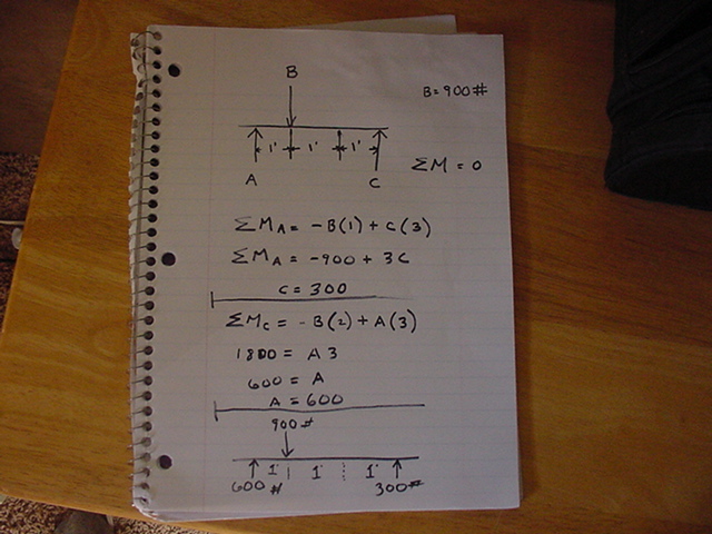

  13. I don't think we've met, but I bet we have walked past each other once or twice.
    So lets work up to this in steps.
    Ok so using torque figures and methods of calculating-
    What happens if we put 900 lbs on a 12 bar in the concrete slab ?
    Then make the slab 10 feet long - What happens then?
    Not sure exactly how to read your sketches. But I'm sure it will start clicking like a baseball card in the spokes

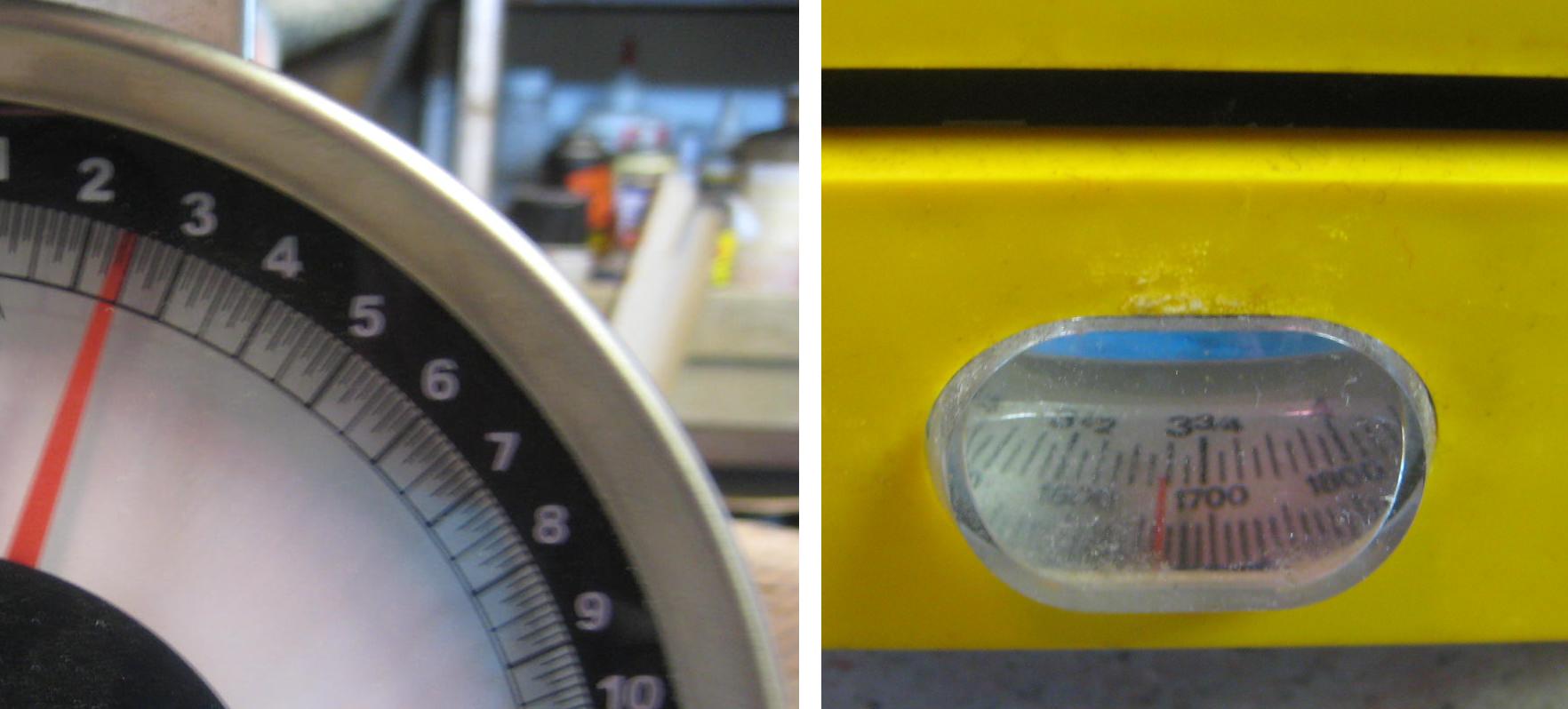

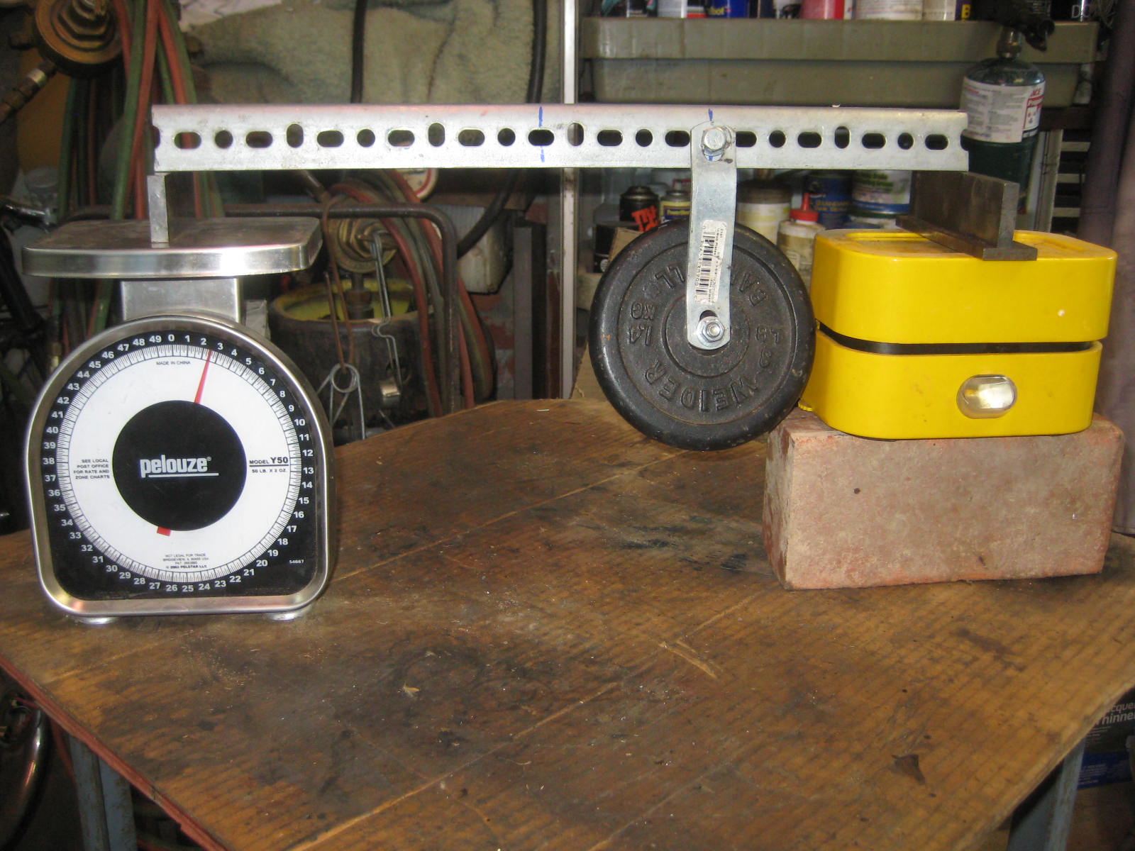

    Wish I had a second shipping scale but in my best Chong voice...hey man are you guy's ready to have your minds blown? Take the image of the angled offset motor mount, then weld a stringer from the frame straight in to the motor. Doubt the front of the car is going to instantly get heavier.

    Hmm, a scale at each end... The reading on the scale did not change, the weight of the ***embly did not change, but the weight on the brick would be different? That's magic! I tell you what you do, go run that by a boom truck operator.
  27. blowby
    Joined: Dec 27, 2012
    Posts: 8,664
    blowby
    from Nicasio Ca
    The argument is that changing a mount from 1 (below) to 2 will change weight distribution. Let's say you do that and you put scales under each end. Then you simply lay a brace across as in 3, not bolts. Is the weight distribution going to change? Of course not. Now bolt the brace in. Any change? Now you saw the angled piece in half. Any change?
