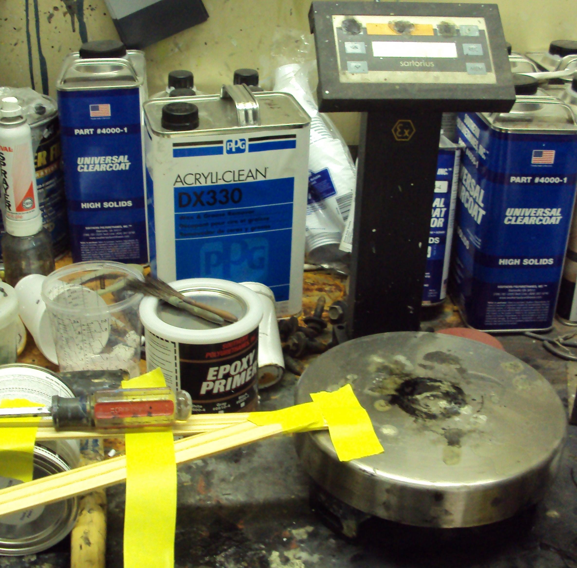

    All this work and theories to prove an old mans simple little motor mount wrong.....I love it...while you all have spent countless hours arguing I've put about 300 miles of evening ride time on my '32....."Ain't America a Great Place to Live"

    You are not to scale here, there is alot of calculating to do, But get a longer beam from the weight and bolt it as far to the left of the top beam as you can.

    If weight is where it is, how do my load levelers on my truck/trailer work ? They do a real good job getting my front end back down without adding any more weight.
    I can see where a rear facing mounting bar would transfer some engine weight to the rear wheels.
    Really enjoying this thread, got my simple mind a spinning.
