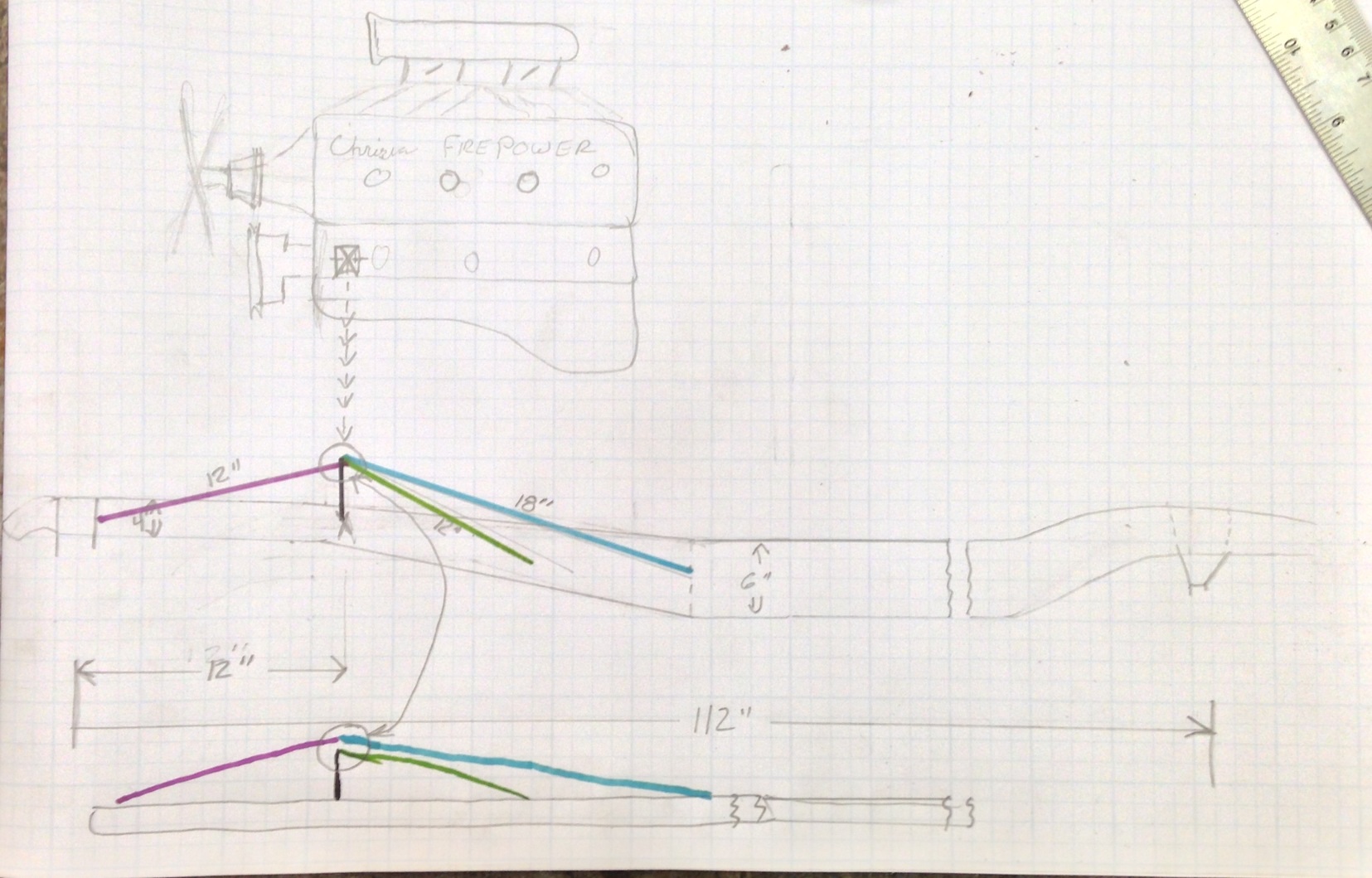

    Basically i was working up to the engine on a levered motor mount coupled to the frame rail.
    Give me a min, ill get my good crayons and sharpen them up. Lol

  8. Ok here's the pic,
    In this there are 4 separate motor mount scenarios & they are color coded.
    One is facing rearward, next is straight under, the next is facing forward and the last is longer facing forward.
    The frame is a rough sketch of a regular old 33/34 frame and the engine draw above its resting place, to be lowered down.
    With concrete and bar demonstration, you showed me how I moved/lifted one end of the slab by applying my weight thru the bar into the slab. It was torque created by my weight on the bar generating the force, torque.
    So when I said put 800-900 lbs on a 12" bar I wanted to see the torque applied to the slab and what would move ( read transfer weight). Then When I said make the slab 10 feet long I wanted to see how that increase would effect the out come. And all of that was working up to this pictures representation of levered motor mounts creating torque and transferring weight.
    Man I hope that makes sense.
    thanks for your help!!

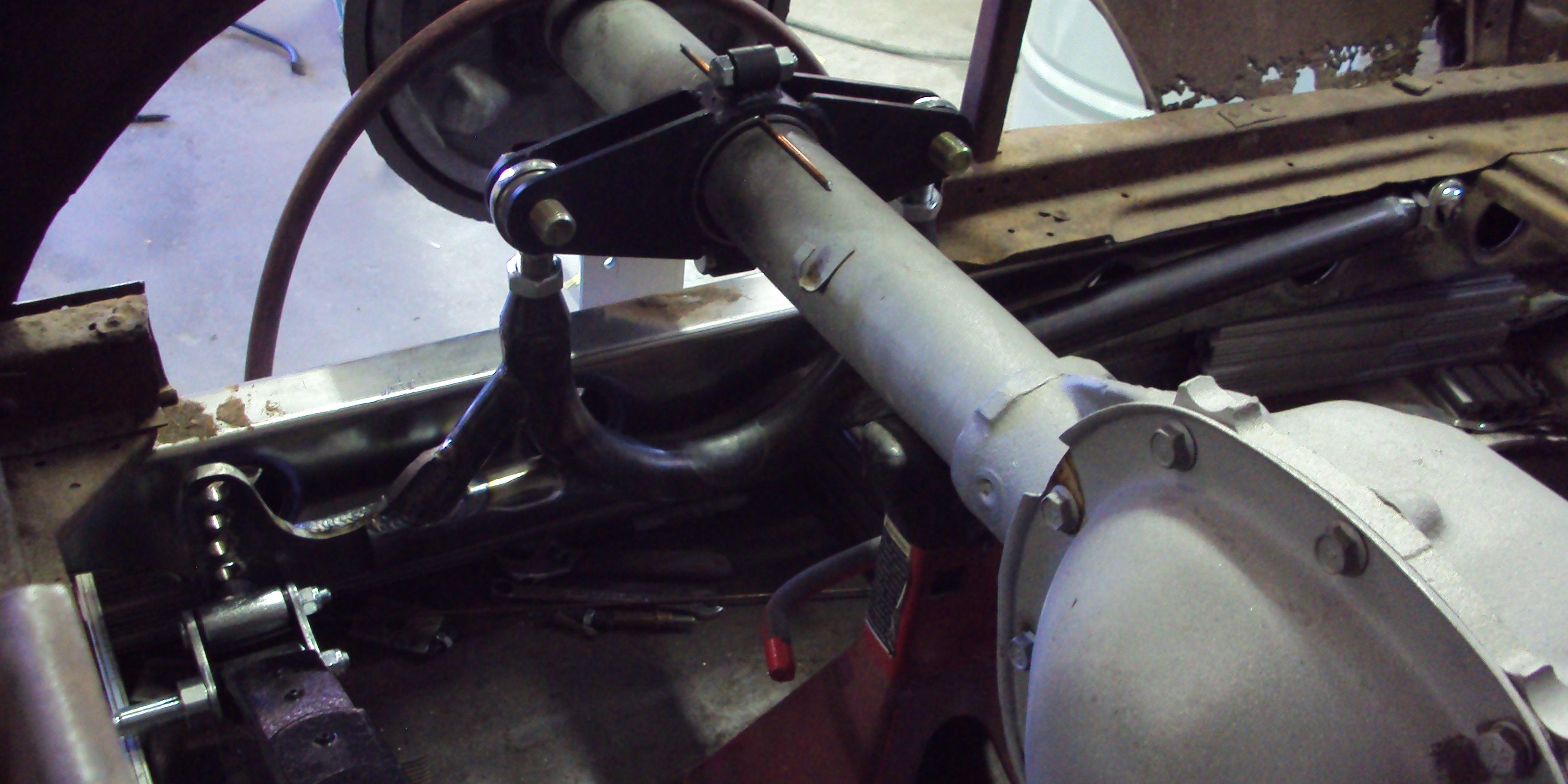

  9. This got me thing about what actually happens with this style rear spring and suspension
    The weight pushes on the spring hangers, The hangers try to spin (torque) the housing, the p&j style ladder bars are loaded because of the weight on the rearend. This has got to be doing a lot of weight transfer just sitting there too, no?
    Nobody wants to tell me this isn't transferring weight ? Or how much ? Or where its going ? Or where I should go ? Lol

    I give you an A-.....drawing skills are average for a man of your skills and knowledge, but the use of colors like that is ingenious.........I just had to come back and say something.....I love hearing you hands on guys make the pencil pushing pencil necks that wouldn't know doodly if they hadn't read it in a book.......I remember my mentor telling me one time..."That looks good sitting in the shop, but that 1/2 mile dyno will prove your work fruitful or dumb"...talking about the Circle track we ran each weekend.
  11. Lmao !
    You really should see some of my artwork. There's down and dirty back of a napkin stuff that suffices most of the time. But then there's other stuff that a drawing is all you have to sell it with. Some guys have a natural talent for it, I need to coax mine to flow and that takes time. Obviously a sign painter would be extremely easy going about doodles and make them nice without trying. With some of the sit I do, they say that " I make it look easy" I always tell them that making it look easy is the hard part.

    31Vicky, After studying your sketch there's a few things that jump out at me right away! First off LOOSE that 4 blade fan and get a good 6 blade one! Next those round exhaust port heads gotta go -not only are you missing one exhaust port but they are teeny tiny! at least step up to some triple nickles on that biatch. All the better if you can spring for them fancy "store bought" al-u-mini-um ones! Unless of course those are actually the freeze plugs - in that case I hope they are installed properly - them flat ones can be a PITA if you're not careful. Oh yeah - lastly - you aren't gonna transmit torque anywhere with that setup - you don't even have a transmission yet!!!! Sheesh

    Another hand drawn sketch. A bar with a bolt in the center. When you apply torque to loosen the bolt, the far end will try to lift. If the engine weight is applying torque to the mount, the static load is actually taking weight off the rear of the car. Under engine torque, the left side would be being pulled instead of being pushed and would help plant the left rear tire on the stock car, possibly. Just my backyard engineering opinion.
