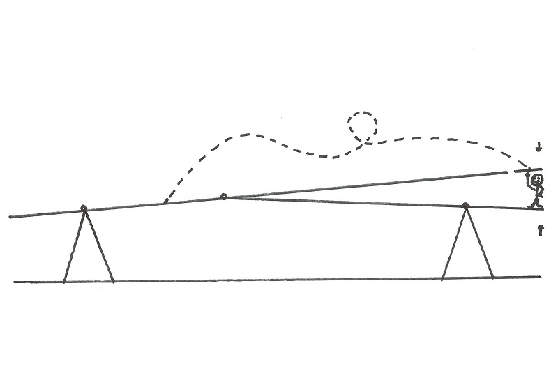

    Pardon my "art", had some time to spare and thought this would illustrate what Highlander is getting at. A,B and C are the alternate mounting points, second pic is an exaggeration and third may help to demonstrate why the other end of a mount doesn't really matter since the load is still applied in the same spot. Last pic would also feel spongier since the bracket itself is less rigid.

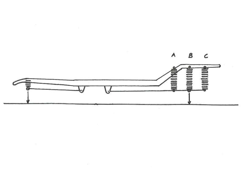

    good pictures showing the fulcrum/pivot points. if some of the weight was ahead or behind the axle/pivot/fulcrum and the vehicle was in motion, either accelerating, braking or cornering would the lift point of the motor attachment matter?
  12. landseaandair
    Joined: Feb 23, 2009
    Posts: 4,485
    landseaandair
    from phoenix
    Not completely sure what you mean. I was mostly partaking in the part II discussion though pic 3 does relate somewhat as far as static weight distribution. To be honest all this text is making my head hurt.

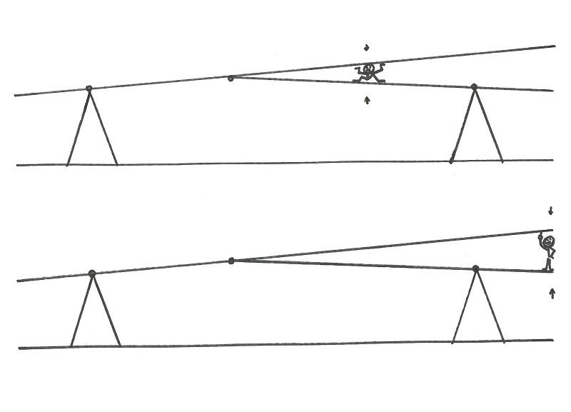

  21. [​IMG]
    What I see here, with reference to the first pic and being static ...
    With spring force at position B, - the ladder bars would not generate any load at the frame mount neither up nor down.
    With Spring In position A, the ladder bars would be placing a downward load on the ladder bar frame mount. That force downwards force would some how follow the curly cue to both the front and rear. And the further away from the axle the more force applied to the mount.
    With spring in position C, the ladder bars would be placing an upwards force at their frame mount. Again that force upwards force would follow the curly cue to both front and rear and again the further away from the axle the more force.
    does that make sense so far ? I'm pretty sure that the concept does and logic with some physics says it should be so. This particular application for reference is going to be with spring in position C
    I get that far and start thinking how to use that concept to do a bunch of stuff .... balance the car, at least move the sprung : unsprung ratio the right way, get it to hook hard and not unload, not stand straight up, go straight- This is the goal I suppose and the things I am trying to achieve, so the question marks later in this post refer to accomplishing this. At least not make any of it worse. I see the dynamics of spring position C changing when the engine torque makes its way thru the ch***is. There's a lot of concepts that come into play, CG, neutral line, anti squat that is see possibly moving , but which way??? What direction to guess in???
    Moving objects around and choosing the placement will change those forces, adding weight as a last resort will also. But adding weight apparently has an effect on the polar inertia moment. Not quite sure how many axis or poles I need to be concerned about but I'd imagine there would be more than one. For instance placing the battery between the ladder bar frame mount and the axle would be different than placing it behind the axle. Adding 80 lbs to each side if the frame just before the kick up would have an effect on sprung weight, center of gravity and PMI, But 160 lbs mounted in the same for and aft location but centered over the drive shaft would be different PMI
    Just for example - What I see the difference is that if the battery were behind the axle, it would certainly add to the sprung weight but at the same time add more upwards force at the ladder bar frame mount. While placing it between the axle and the mount would add some to the rear sprung weight and add some downwards force at the ladder bar frame mount to balance the upwards force. But which do I want?????? And why do I want it???
    If my calculations from the previous post are correct, if i were to move things from a location near the ladder bar mount to back behind the spring it would have at least least a 16% amplification of that relocation. Is that what I want ???

    Pretty sure were on the same page with the spring mounts as far as the forward ladder bar pivot being loaded one way or the other with the spring on either side of the axle. The whole combination is basically two levers linked together and pivoting on the axle centerline, giving an advantage to the spring in example C which would tend to lift the frame at center.
    Works with a pivot but not a solid member with the load point still the same as in the last pic. Curly cue was just a representation of a hypothetical Dr. Seussesque bracket going to another part of the frame. When it comes to redistributing weight I tend to think like a drag racer and put it all towards the rear bumper but sounds like to keep your "pole" happy, down low and near center sounds like the way to go.:p
