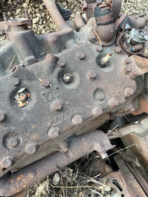

    Ok. I've overhauled a model T engine (the car in my profile) but I've never messed with a flathead V-8 before. It's gonna be fun! Here's a bad picture of that Mercury. merc flathead.jpg

    The only difference that makes any difference between a Ford and Merc flathead (after 1949) are the crank, pistons, heads, and cam. You CAN use a Ford block as a new host of all the Merc-specific stuff.

    Yep, I forgot to mention the cam and heads. It will look like a Merc except I believe the Merc branding is on the belhousing if the early ones are like the 8BAs.

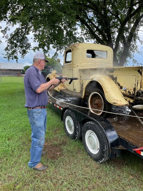

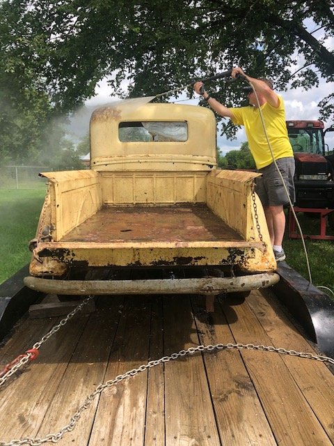

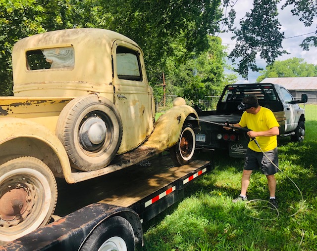

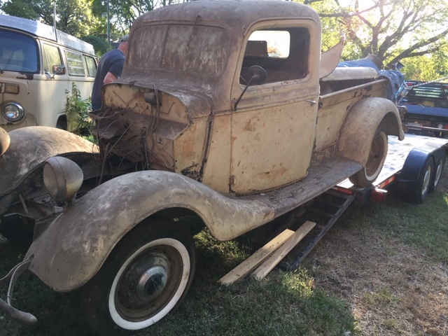

    Column freed up. Dad and I loaded the truck on the trailer ant took it to his place to wash it (no water at the shop). One of the tires still has paint overspray from the High School body shop paint job back around '62. They weren't too well versed on sanding before spraying, either! It is back in the shop now, ready for dis***embly. I thought the spare was cool, so I added a picture of it.

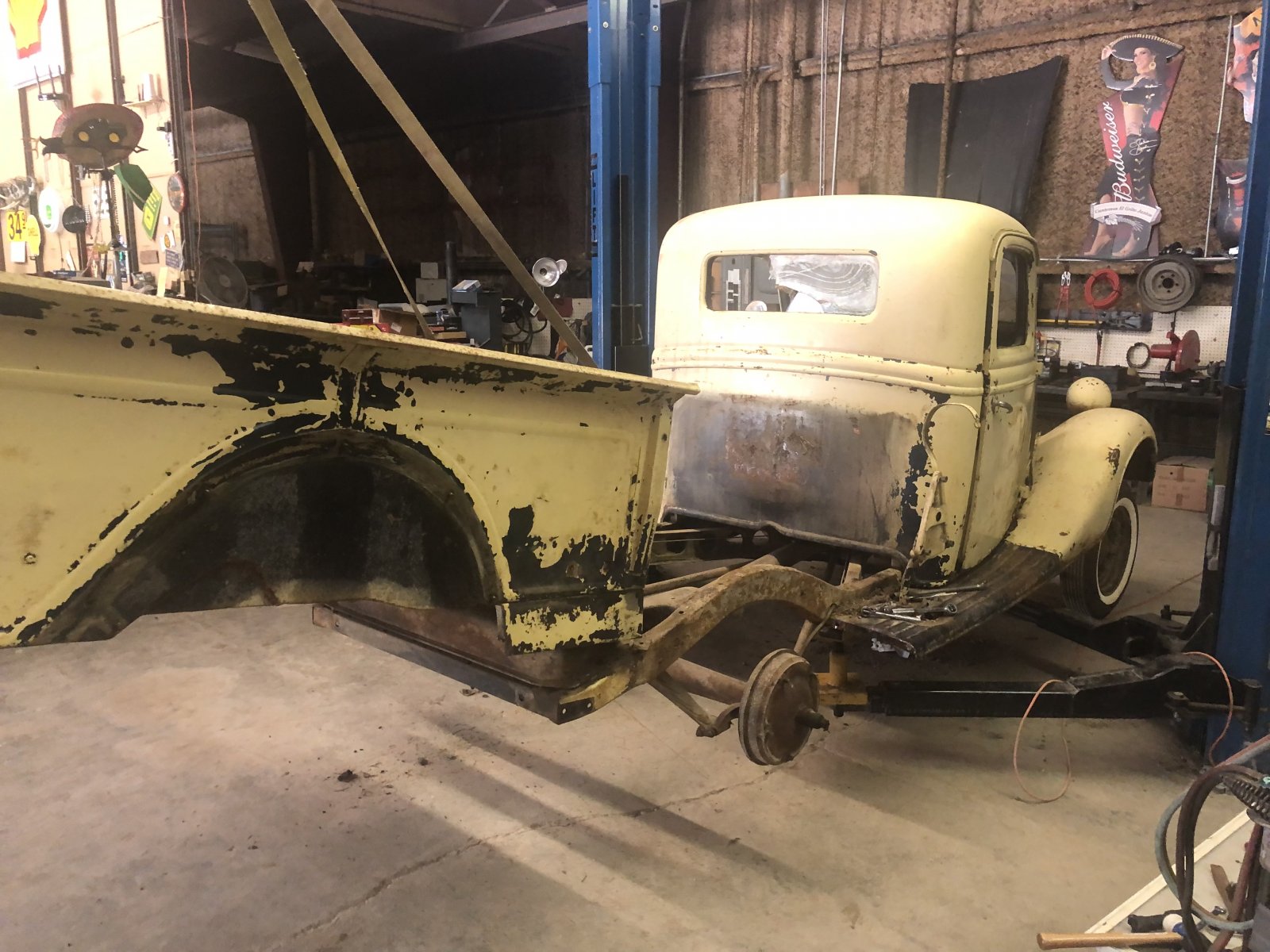

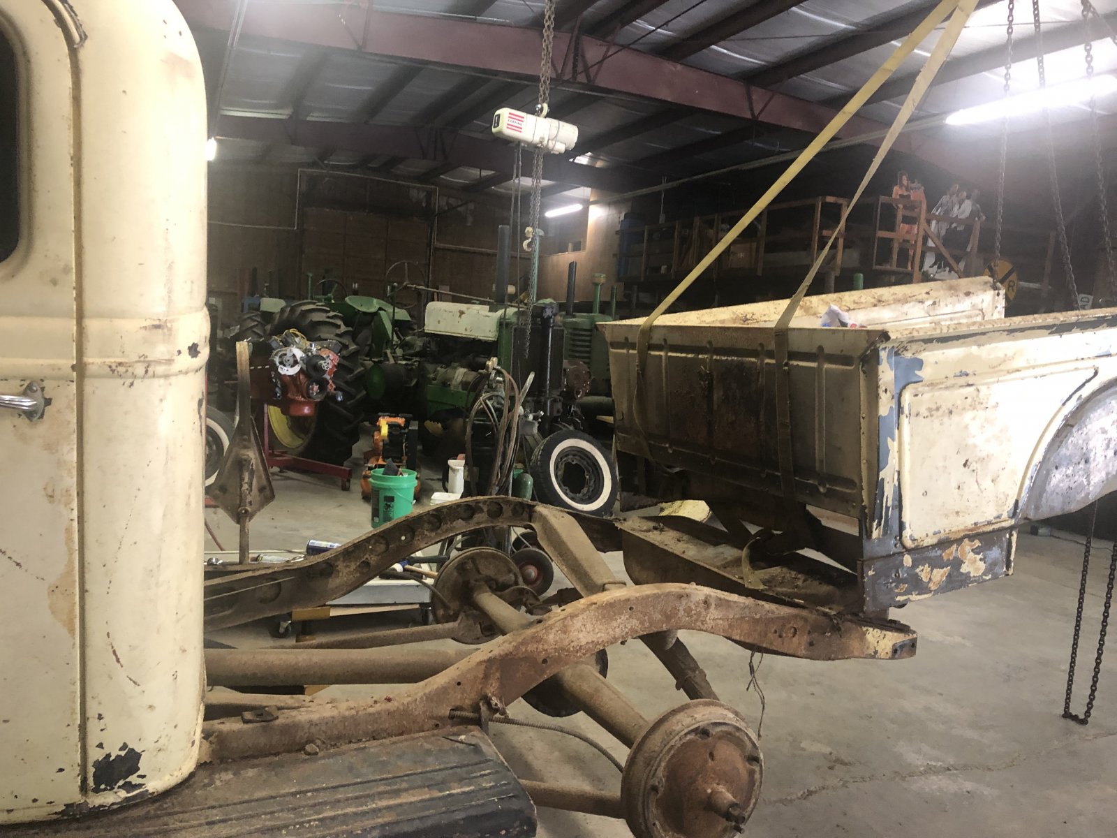

    Dad pulled the bed on the old truck this past weekend. Lots of busted bolts and knuckles! We believe that this is the first time the bed has ever been removed. The wood blocks between the bed and frame are still in excellent condition!

    Joined: Mar 14, 2001
    Posts: 25,957
    Roothawg
    How bad did the back of the cab rub? That’s a common issue. That and the lower molding line.

  24. Poppinjohnnies
    Joined: Oct 10, 2018
    Posts: 77
    Poppinjohnnies
    No rub at all.

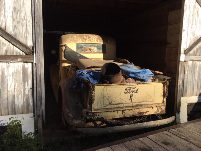

    Well, the engine was sitting in our shop at the farm and that shop is what burned down some 20 years ago. The truck was sitting in my Grandparents' barn at their old place. It was in the same spot, on the same wood blocks since 1963.

  26. Roothawg
    Posts: 25,957
    Roothawg
    That’s one in a million. Truck must have been gently used. Usually the bed front is bowed out from slamming things in the bed.

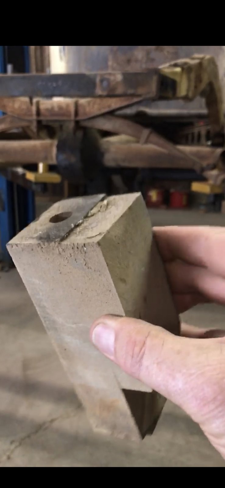

  30. Poppinjohnnies
    Posts: 77
    Poppinjohnnies
    Here’s one of the wood bed support blocks from the rear of the truck. They’re in great condition, so we will be using them when this goes back together.
