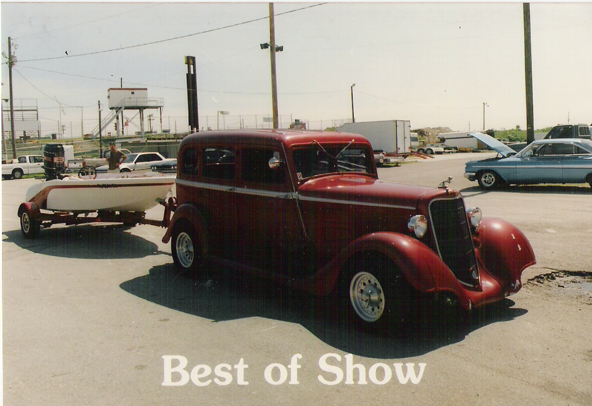

    I've towed 1800lb boat with my 34 Dodge,and 29 roadster....Dodge had a frame non-Reese type hitch, but the 29 had a custom Reese type
    29 had a 2.3 eng with M-II front brakes and 8" rear
    Towed a pop-up camper approx 2,000lbs with my 36 Chevy pick up,Reese type custom hitch, with no problems
    None of these had brakes nor eq hitch with no problems, but I towed on flat land in Fla

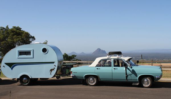

    Seriously? All over Europe, people tow campers with cars, and they have done for the past hundred years. The typical European cars they use to pull their campers are tiny compared with a '54 Ranchwagon. The idea that an American station wagon from the fifties is too light to pull a small camper is simply ridiculous. You can take theoretical safety concepts too far. The idea that you need a truck to pull a camper is a huge step too far.
    You're en***led to your opinion, of course. Meanwhile, back in the real world . . .
    That's the real world in Europe, mostly. I realize that, in the U.S., the marketing staff at the big three automakers have convinced us all that we need a jacked-up four wheel drive three-quarter ton pickup just to commute to work in the city. Lord knows I see plenty of them every day in Denver. Often, of course, I see them in the ditch too, on snowy days, because they have no real-world driving skills. No amount of weight or four-wheel drive or knobby tires will make up for the poor driving skills of the average American driver.
