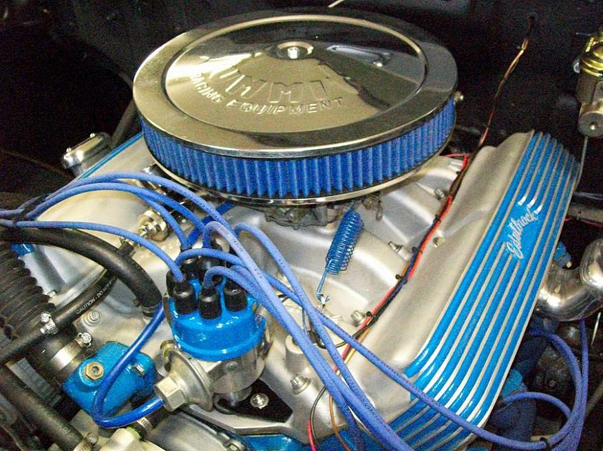

    Guys, i know the distributor is not 180 degrees off. It wouldent matter if it was the plug wires are in the correct order. I know the ford runs reverse compared to the chevy.
    this thing Runs. it even idles somewhat nicely. but it is NOT right.
    Debate the pertronix all you want. i have used them quite a bit and like them. i keep the points plate and everything in the glovebox if it dies, and i can put themback in as a backup.
    i am gonna take the engine out, this will allow me to remove the front clip and detail the front suspension while im at it.

    So, what's the up-shot? Have we figured this out or is it still nutzo making? It seems to me that at this point a guy should go back at least as far as the cam drive and make sure it all is going together right...Engine up on #1 TDC, valves for #1 closed, drive dowel in place, etc. There's gotta be something that's being missed. No other explanation. All the responses I read could be THE reason, and none of the obvious rookie mistakes seem evident.
    As for the cam grind being a 'Chevy small-block' grind, well, if it's true it's only because the little Chevy has been a popular engine for a long time...long enough for it to be considered as a 'standard'. Anyway, the specs are pretty mild, if they check out compared to the cam card. If they don't match the card, maybe it's time to adjust for reality, and go with what you have instead of what you think you have. You might have gotten a different grind than you bargained for.

    Well, the engine is on my stand, stripped down to the shortblock. this week a friend that builds engines every day for a living is gonna help me Degree the cam and reinstall everything.

    i really think either i got a ****ty timing set or the cam is wrong.
    its definately cam timing. im almost 100% of it.
    i guess ill find out this week.
