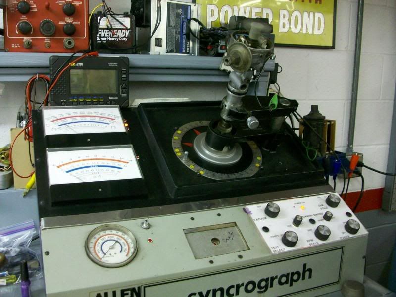

    And its a winner !!!!! Winner of the worse FE i have seen for a while. Dakota this thing is really sick. Will get er fixed this week but thought everyone would enjoy seeing this one for sure....:eek:
    Un boxed the disctributor and put it on the tester and bang problem found right away. ( i kinda prefer them this way , as its pretty easy to fix the problem when you can see it)
    At idle all eight cylinders fire ( some of the time:eek:) like this....
    With a slight increase in rpm it looses a couple cylinders at random and they come and go all the way up the rpm band.......:eek::eek:
    And again at higher rpm.............
    I will post more later as i degrease and take apart, check advance curve etc ....

    Wow, well that might explain alot.
    thanks again man..

    from Beulah, ND
    there is NO pertronix in the Distributor he is testing! i put the points back in it.
