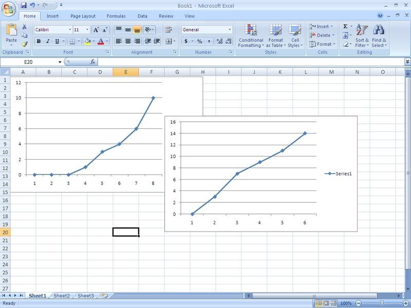

    The curve before and the desired are shown below.
    I put it in the cuda water blast and will retrive from the "hot tub" in the morning. The curve is way off from wear, dirt and oil vapors etc.as well as mis adjustment. Note springs are bent way outward. ( old ford trick to stop spark knock)...
    This is the present spark curve........:eek::( Plot is every 200 rpm from idle of 600 rpm)..
    This is the spec card for a 390 Police Intercepter engine ( the way it should be):D:eek:

    Well guys another short day with meetings etc. However i did get the FE cleaned up and back on the test machine. The stock springs ( below) was a little like a barn door spring ( the big one) and after three trys i ended up using one from the curve kit and the light one from the stock distributor.
    Ever find some of these old spring kits at the local swap meet , buy them up for a few bucks and send them to me , cant get some of them anymore. I will trade ya some hot sauce or a t shirt etc for them.:D:eek:
    Hows that for 14-15 degrees at 4000.....Interceptor Spec card...right on !!!
    Just clean helps.........:eek:
    Before and after today..............
    Just in case anyone thought the coil was defective. Dakota sent it along for the ride as well. I use a 5/16 copper line in the coil tower on my tester. You could weld with this one.......:eek::D

    Heres the chart for a 63 390 ci Police Interceptor
    8" = 1-3 deg
    10" = 2-5 deg
    12"= 4-7 deg
    20"= 4-7 deg
    Max 7 1/2 degrees
    These are distributor degrees and need to be doubled to obtain engine degrees.
  18. Nice!
    So 15 deg. centrifugal and 15 vacuum should be 30 total advance, 8-10 initial?
    My feeling is that the stock distributors have too much advance. I use a Motorcraft Duraspark in my racer that I have welded up the advance slot and filed open to allow 20 degrees of (crankshaft) advance (used a degree wheel/admires your distributor machine). With the light springs I get a total at about 2500RPM.
