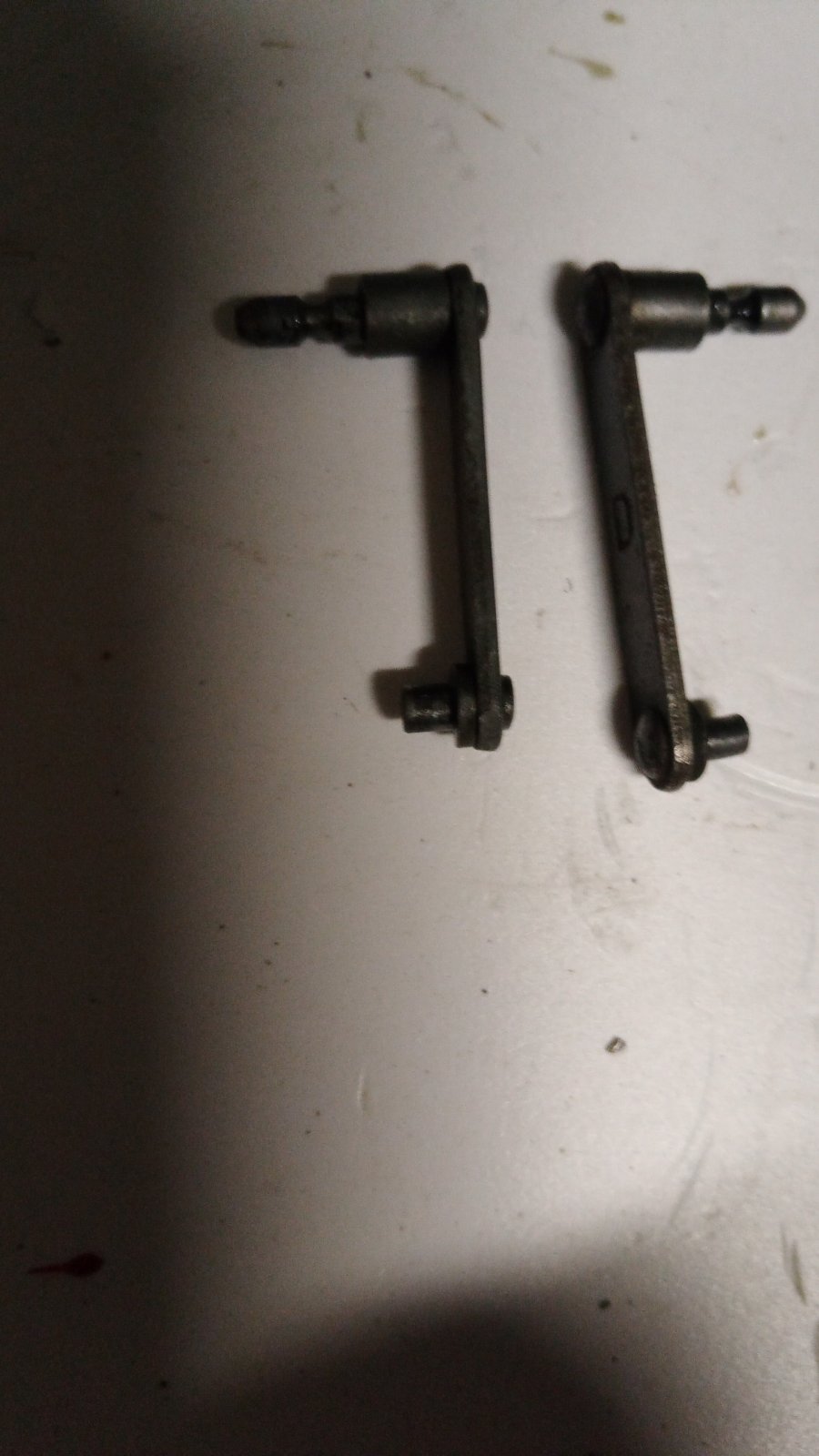

    IMG-20240314-WA0002.jpeg I hope this is not something that has been covered elsewhere, I have looked but have not found the relevant information.
    So my question is I have two Holley 94s on my T.
    I have been trying to match the carburettors to each other, I discovered that the pump links are different on each carb. One has D stamped into it while the other has C stamped into it. One is considerably longer than the other. This obviously means that the position of the pump operating rod is different on each carb. Is there a correct type of link to use? I have become fairly familiar with these carbs but I am far from an expert. Any advice will be greatfully received.

    These links plug into one of the three holes in the throttle bracket. My understanding is that depending on what hole you put the link in you can make the mi IMG_20240314_184636_371.jpg xture leaner or richer, this seems to be achieved by raising or lowering the starting position of the plunger in the pump. The length of the link does the same thing. Is there a 'standard' link?.

    The longer links are used with the Holley 94 style carbs like the Model 2100 that was used into the mid '50's. If you are using the pre-1949 Model 91-99 or Model 59 carbs with the 15/16 venturi then you should be using the shorter link stamped with the letter C.

    Thank you for your reply, it made me take a closer look at what I thought to be two identical carbs. As you said one has a larger Venturi. This carb has the number 1 cast into the body along with EBV on the side. The other carb with the smaller Venturi has 94 cast into it and no identification on the side. I am presuming this is a pre 49 carb. I mixed the link pieces before I realised they were different so not sure which came from which carb. I'm getting another early body sent to me. So hopefully I can have a matching pair. So I should use the short links marked 'C' on these carbs?.

    That's correct.

    Just an update, I spent a bit of time setting the carbs up and I have the T running really nicely now. So to reiterate, I swapped one of my carbs bodies to give me two early style carbs. I used 49 jets and 3.5 power valves in both carbs. The engine ticks over (idles) very well and has good response to the accelerator with little if any stumble or hesitating once warmed up. There is no cloud of black smoke like there was before. I will fit a new set of plugs soon and see how they look but the ones I have got, have a brown colour at the electrodes now rather than being black so looks like I have got it sorted enough for the upcoming summer runs. I also put two rebuilt bases on the carbs fitted with new, longer ****erfly rods. The old ones were a bit worn.
