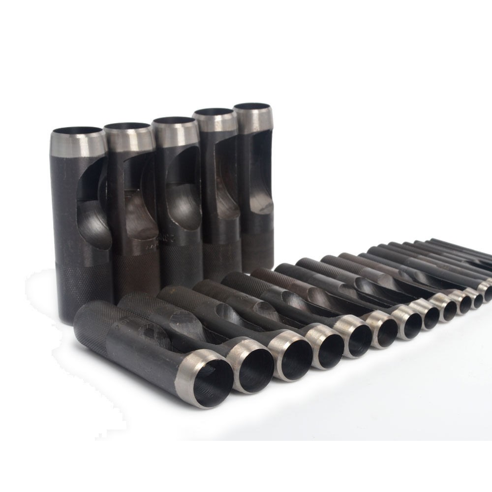

    You want a hollow punch set. Similar to this one or the ones shown below it.
    eBay item number:
    182421204502
    You should be able to find sets locally or find them on Amazon. They are handy as hell for gasket making as that is what I bought my first small set for about 50 years ago.

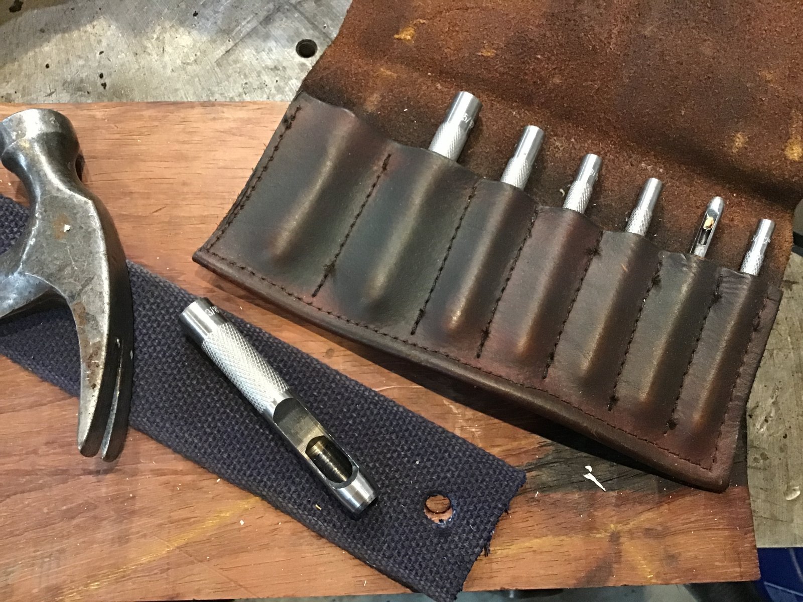

    I use a hole punch and piece of wood . I mark the holes with a soap stone . image.jpg image.jpg image.jpg image.jpg

    Thanks guys , I did try drilling but just caused a frayed mess with this material. I do have a cheapo hole punch set I use for gaskets, and holes in belts,,,so gave it a shot. Results were not as clean as Id like. Could be they were not sharp enough. So I broke the propane torch. Now the hot tip worked really nice. I was impressed. Then trying to cut off my test piece off the roll using sheet metal snips was not getting a clean cut. The heat worked so well, I heated up a old putty knife and made a very clean cut. Perfect, With the from you guys, I can do the holes and cut this stuff off nice a neat.
