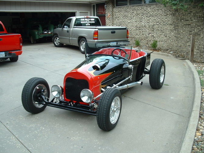

    Has anyone seen the roadster pick up built by Troy Lad. One of my current favorites. I have the issue of Hot Rod but no pics on the computer.

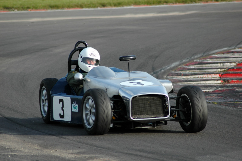

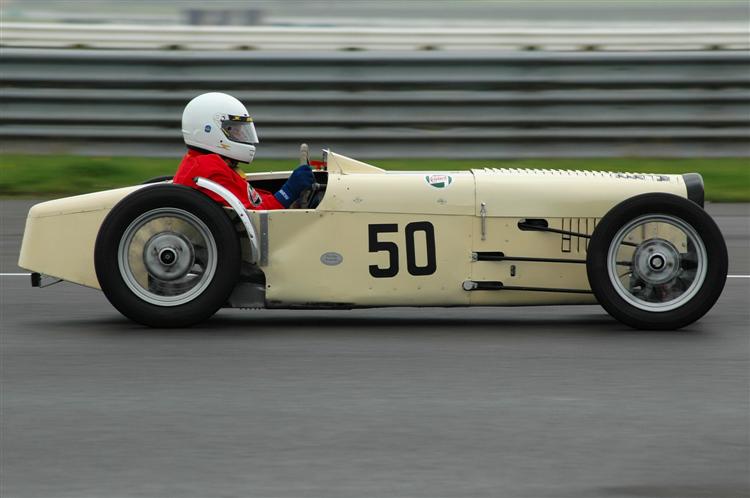

    1930s style Austin 7 racers:

  21. I was at craftyb's for coffee with the track roadster pickup a week ago last Friday. A guy showed up there with a TR-6A roadster autocross car with a crossflow Ford 4 banger (not a 2.3 Pinto/Mustang). He was asking me if I had ever autocrosssed my roadster. Had to admit I hadn't autocrossed since the early 70's when I had a set-up '62 Vette. I guess I didn't know there was anything of the nature still happening in Western Michigan. The next event put on by the Furrin Group out of Grand Rapids is having one at US131 Martin Dragway on 6/28 I believe.
    Bottom line I believe I'm gonna take a shot with mine - just for shits and grins.
    Charlie
