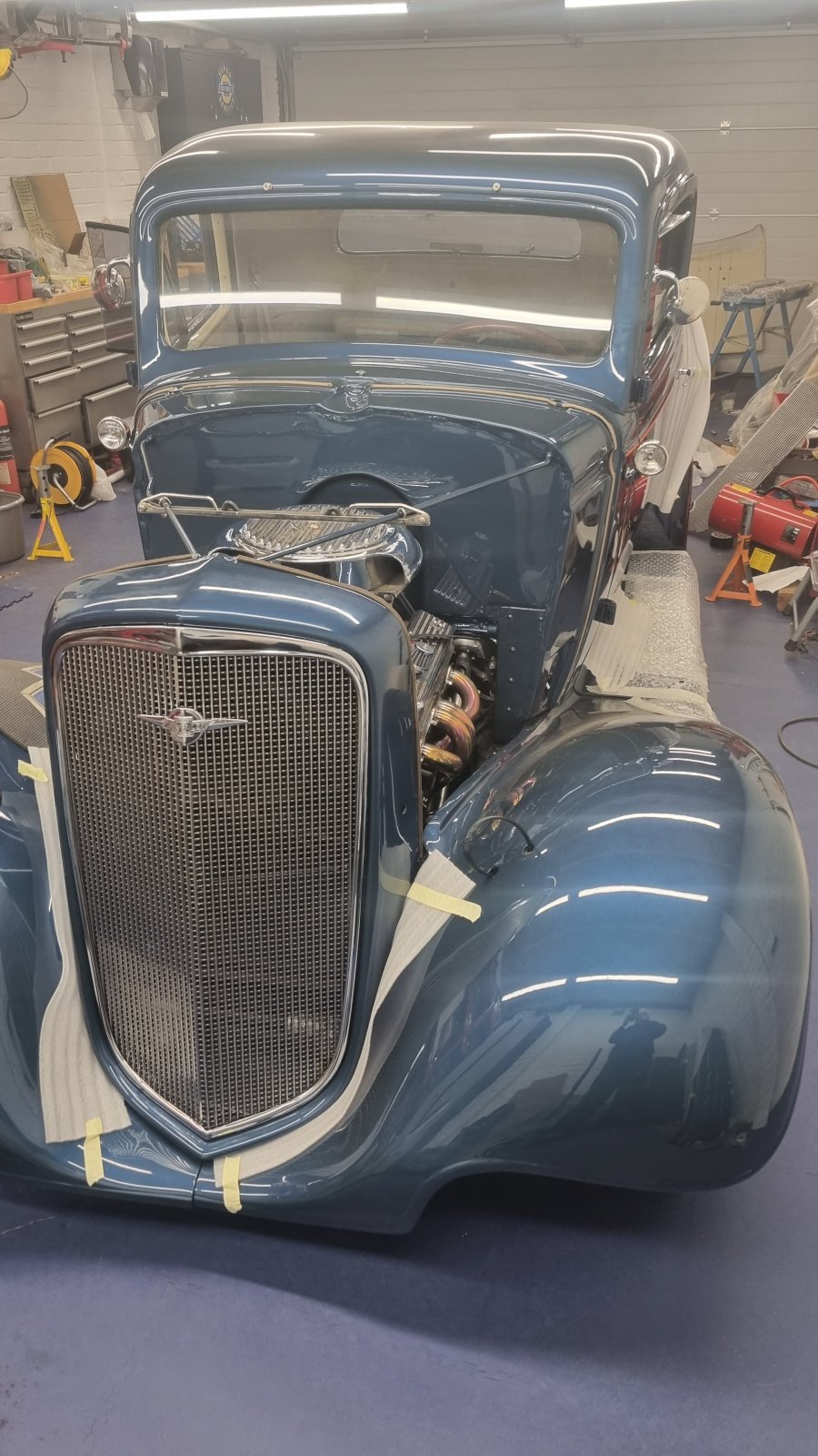

    Running a pusher on a 34 chev. Works ok and thermostat controlled. Its mounted high up on the rad core where it needs the most cooling. Its hardly visible through the stainless grille. There is also an override switch so it can be operated manualy
