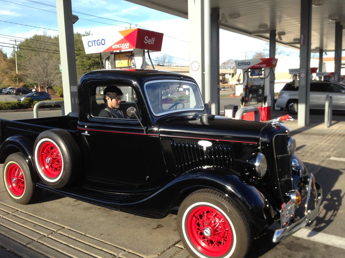

    Thanks AVator. I sort of suspected that. 13052643_10154110168935908_1808253226_o.jpg

    Nice looking vehicle! Best wishes.
