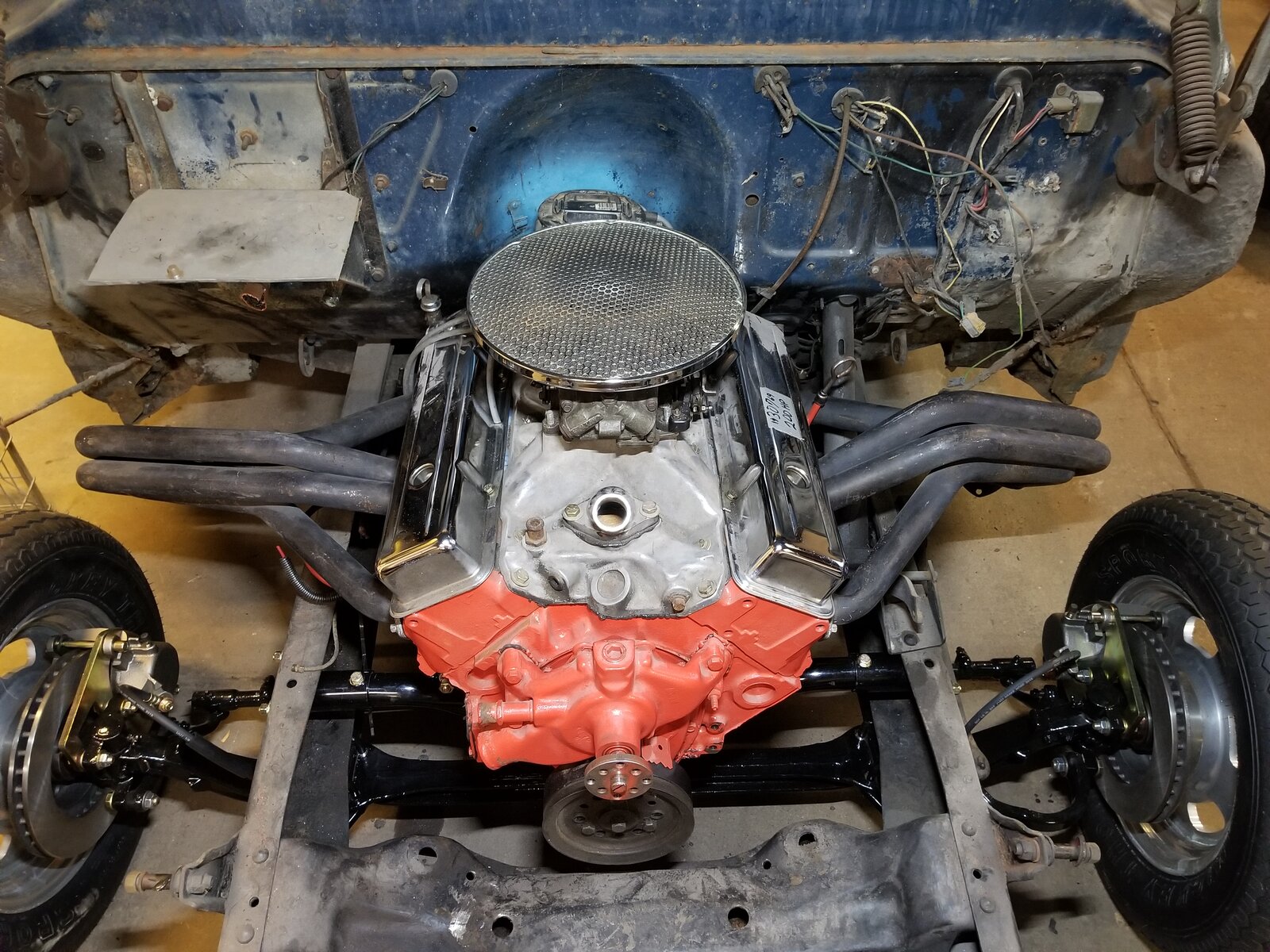

    Johnny not sure what you mean. If I raise it, it wont be in contact with oil pump. If I raise that top plate oil spills out all over the place through the top.

  3. Jeep 307 SBC
    Joined: Feb 20, 2021
    Posts: 5
    Jeep 307 SBC
    How will that effect the hole I circled in yellow?
  4. Johnny Gee
    Joined: Dec 3, 2009
    Posts: 14,353
    Johnny Gee
    from Downey, Ca
    This!
    Look at the oil galley that runs along the distributor. You'll see that the grove of the distributor (your case priming tool) needs to be in line with the galley. Your priming tool body is to low and oil is going up rather than horizontal to complete it's path. Show us your primer out of the engine so we can see how it's configured.

  5. Johnny Gee
    Joined: Dec 3, 2009
    Posts: 14,353
    Johnny Gee
    from Downey, Ca
    @Jeep 307 SBC if you had a later block (see lower photo) you would clearly see what's happening easier.

  6. Jeep 307 SBC
    Posts: 5
    Jeep 307 SBC
    That makes way more sense. If I am understanding correctly, the distributor or oil primer block oil from climbing to that hole if properly placed.
