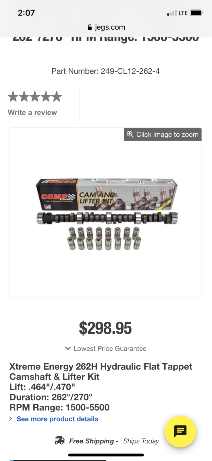

    Not having the loose converter is what has me concerned. I have never had a lock up converter in a hot rod, much less a smaller cubic inch motor with a lock up.
    Our late model pickup goes into OD at 45 mph which is about 1,500 rpm. How bad will it be with a cammed 307 if the trans shifts into OD at 1,500 rpm? If the cam specs say 1,500-5,500 rpm, am I good? Or will it struggle?

    I wasn't aiming for a 1,500 rpm cruise rpm on the highway. The modern truck doesn't live there either. I was wondering what would happen if the trans did shift into high gear at 1500. Would the engine have the low end grunt to accelerate from there or would it just bog down until it downshifted? How small of a cam would I have to go to not have a problem? How big can I go and it be tolerable. I have no experience with a combination anywhere close to this.

    The combo is capable to give you something near 300 hp. Maybe 285 maybe 325.,,,, so don’t expect to be a drag strip Godzilla, or serious contender in street races.
    On some extensive desk dyno work, The cam I mentioned made the most Average HP thru the rpm range. That’s AKA under the curve. The torque curve is very flat too. That’s where your street driven car spends the majority of its time. Bigger cams made more peak power but less average power. Complete as done in the car and real world driving it’s was really freaking nice! Forget that’s cast off parts and perfume pig ,,,, fun ride.
    That trans needs it tuned to downshift when it needs too other wise it’s going to RATTLE, the trans needs tuned to 3-4 shift and lock when needed. I can’t tell you how yours will do but I had no problems with my set up in a 4000 lb vehicle
