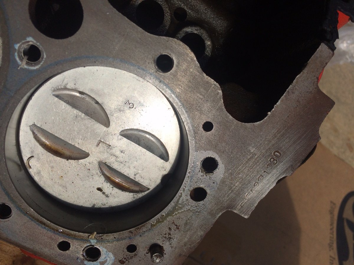

    I have a question about the 307. I bought a new short block. Put in the 54. Could not get any way shape are form chevy starter to work. Jerked the 307. Now I can't sell the block,because a starter will not work on it. How about the rotating ***embly. Can I get. Anything for it.

    26 T Ford RPU
    That doesn't sound right. Got the block casting # and a photo of where the starter goes? Sounds like a straight bolt starter on a large ring gear. JW
  22. You should post some pics of the problem and Some measurements.
    Are you saying you bought a "new 307 short block" ? If so Where did you get that?
    Your other thread might be a good place or here as well. I doubt it's a 307 problem,

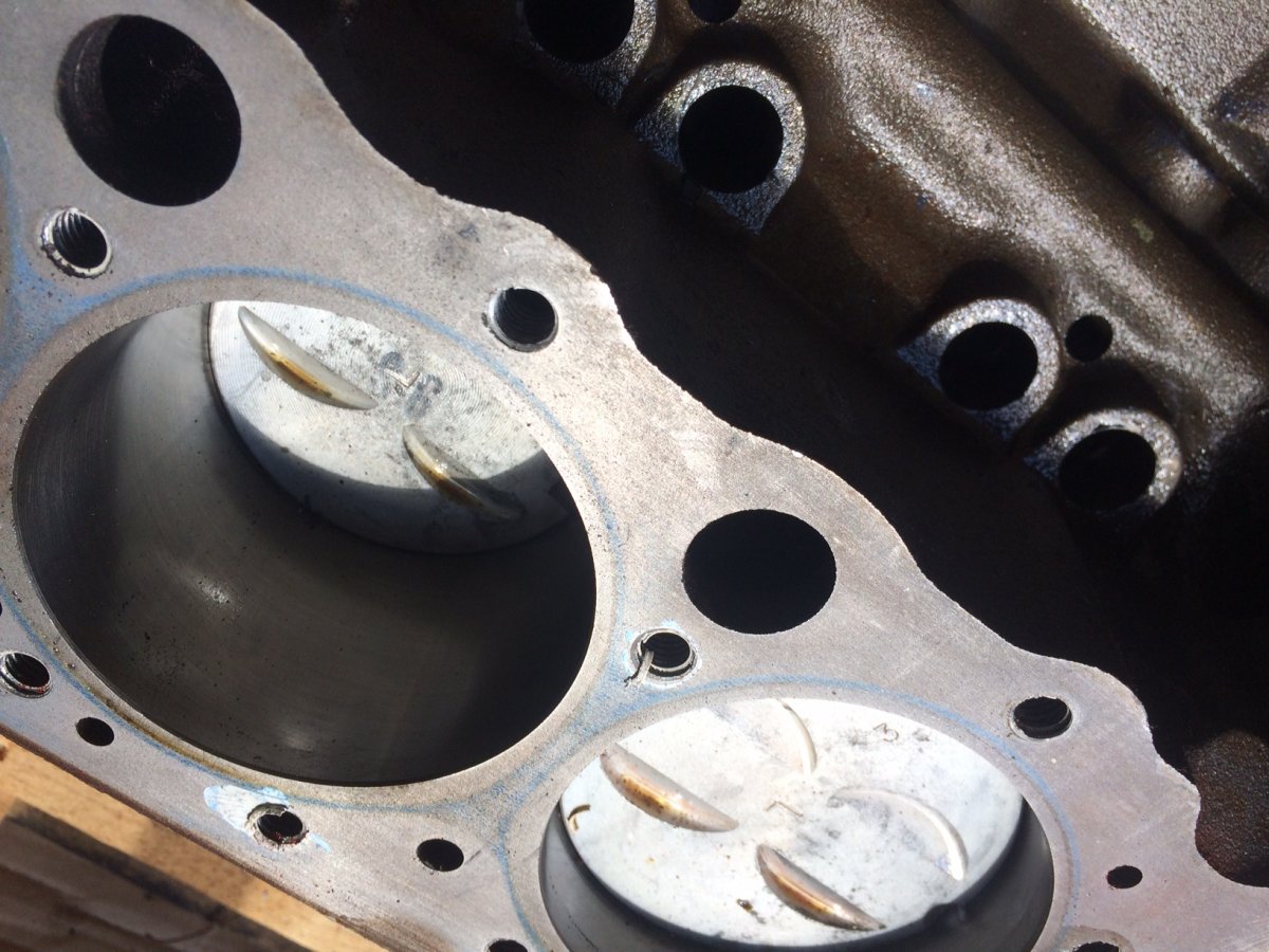

    The block was in a guys garage for over 25 yrs. he bought from GM. I have a friend who had an auto electric shop. We used every possible way to make a starter work. Big and small flywheels. After a month of shims bolts and stuff I gave it up. 307 had a history of starter issues. Googled it several times. Numbers 3956618. 1968-79
  24. 325w
    Joined: Feb 18, 2008
    Posts: 6,511
    325w
    IMG_2055.JPG IMG_2056.JPG Here's the pistons coming out. Giving the rotating ***embly to another old guy that will do something with it. Junking the block.

  26. Not sure why you won't measure and post some pics. Your measurements about the starter mounting boss can easily be compared to a SBC blue print.
    If every starter failed and shimming failed it must be a problem with the hole locations or boss height.
