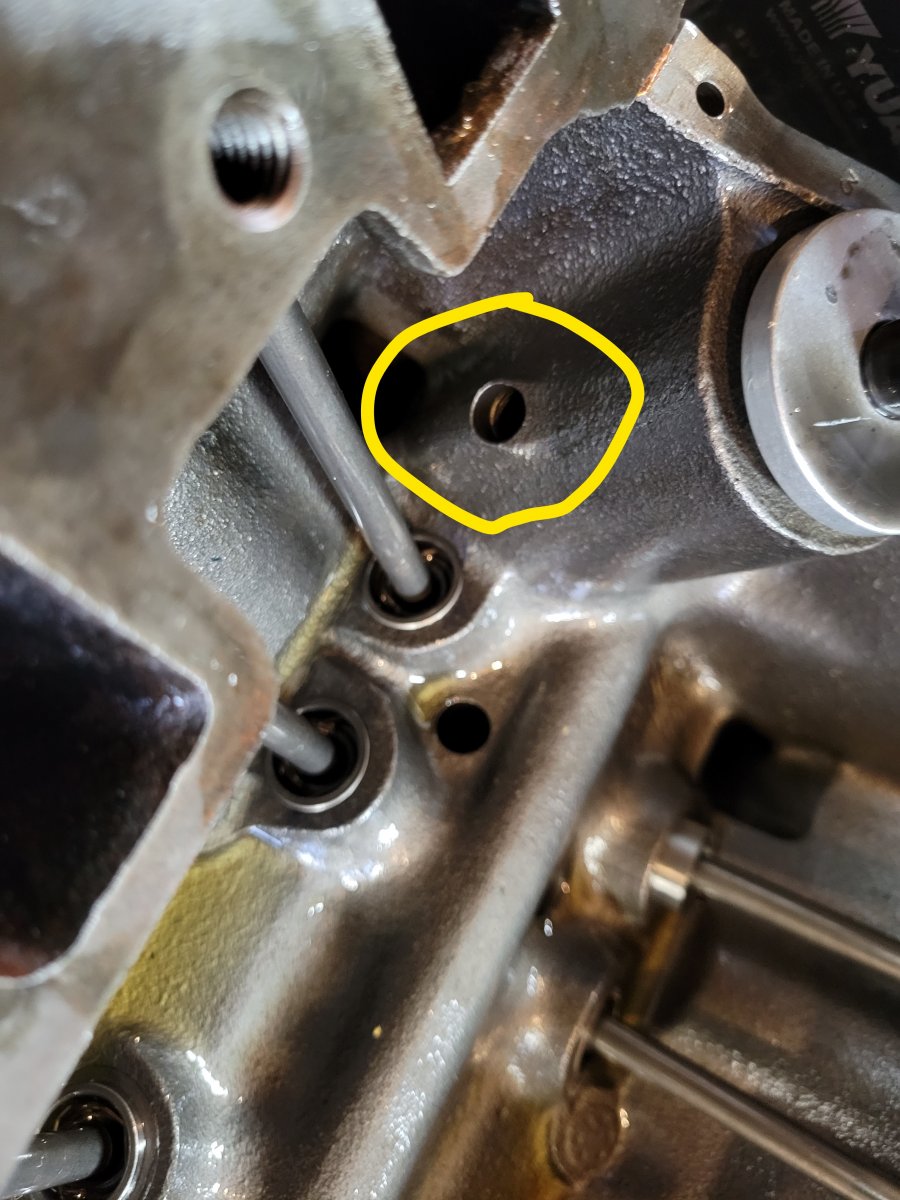

    So I am rebuilding a 307 for my CJ5. I have heads on and was priming the oil pump. Can anyone tell me if the hole in the pictures need to be plugged? 307 hole.jpg

  28. Was there oil shooting out? not supposed to be

    Yes oil was coming out of that hole. I know later model blocks don't have a tall distributor hole like this block has.

    Did you try raising your oil priming tool since there isn't an intake present?
