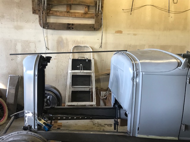

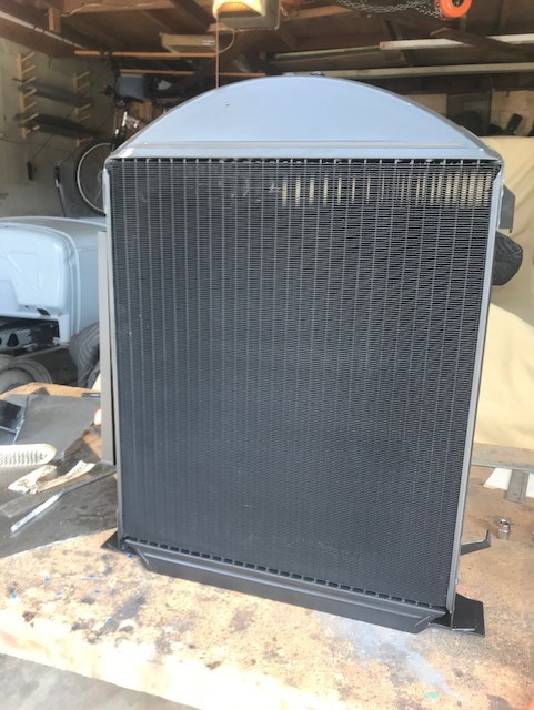

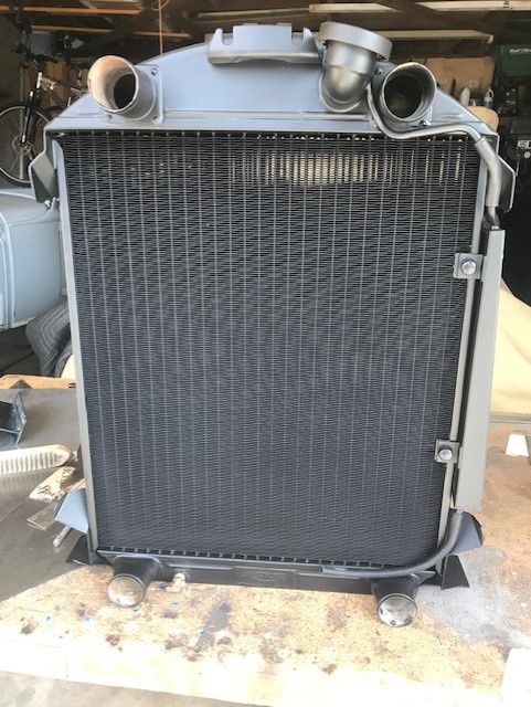

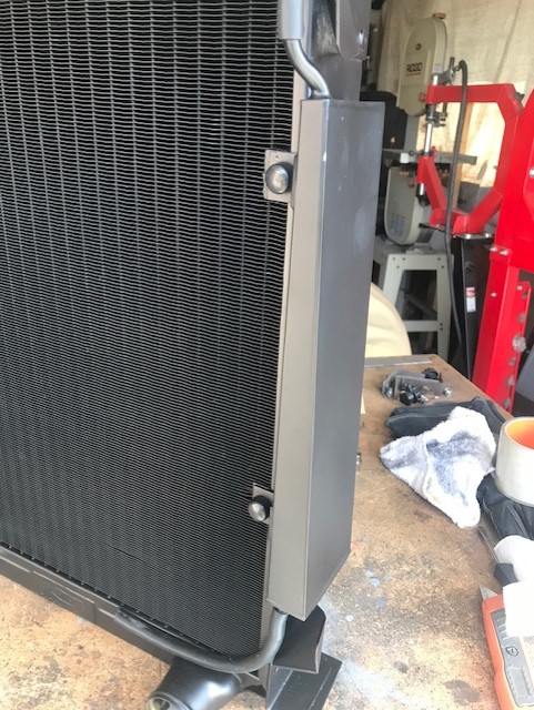

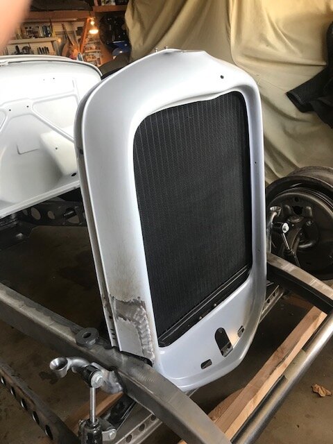

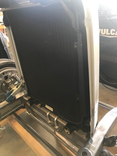

    Using a Br***works on my '30 roadster project with '32 grill. '32 frame and 59AB flathead
    Best customer service and really nice product. Fits like a glove.
    They added over flow tank to it.

    Hello, looks good is that a 2 or 3 inch chop on the rad. Don
  9. roll of the dices
    Joined: Jul 15, 2010
    Posts: 1,349
    roll of the dices
    Don,
    This is a 2" chop. Everything I found online indicated 30-31 requires a 2" chop. 28-29's need a 3" chop.
    I mocked up with 2" and very happy with outcome.

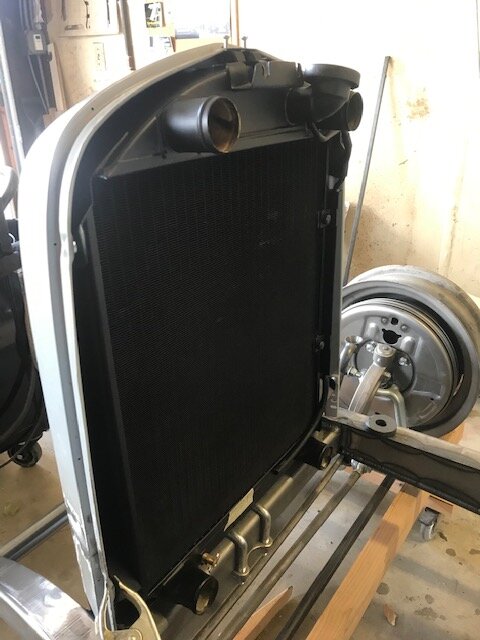

    7B7E0BC2-56B3-4635-87A9-0FFD29FD92AA.jpeg My ‘31 has a stock dimension ‘32 Br***works with the hidden fill neck. I chose not to get the built in overflow tank because you have no indication if the radiator level gets low. I use a bottle for the overflow to gauge if I’m losing water. I’m glad I did because the 21 stud that used to be in it used water very slowly and I could only tell by my overflow gradually going empty.
