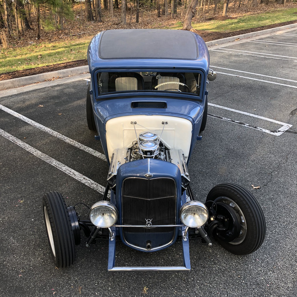

    Never posted a photo of the car painted on this thread.
