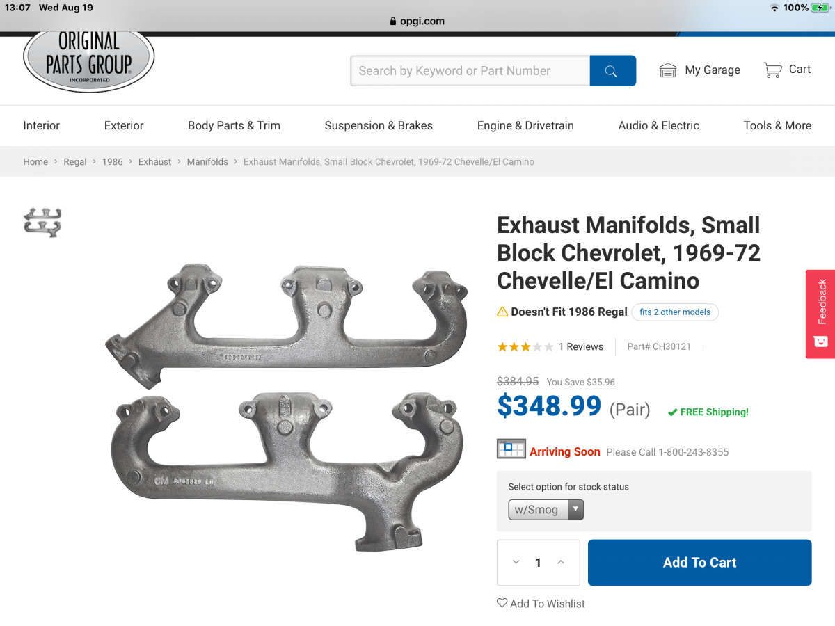

    If you are going to run cast iron exhaust manifolds try the early Chevelle manifolds they clear the steering box like they were made for the swap. I have a set on my 40 for over 50 years. You may be able to find them at a swap meet cheaper. C06E7216-A53A-446F-9748-FA04D4CFC3EA.png
