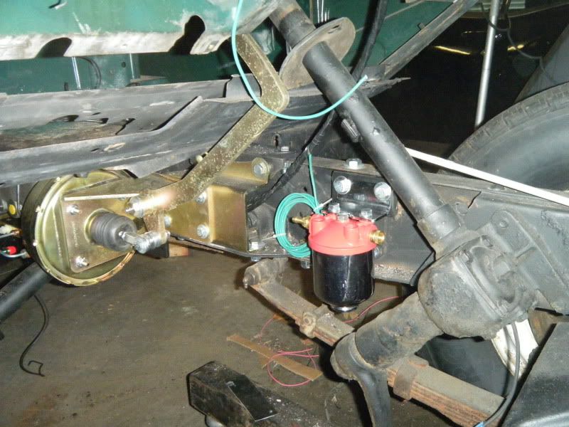

    Where did you find this master cylinder setup?
  28. I tried to find the name of the place I bought it in my old emails, but no luck. It's a piece that's meant for a mid-50's chevy truck. Search for "frame mount pedals"...there are a lot of places that sell parts for old chevy's. I had to make some mounts to get it to work with the dodge frame. You can kinda see what I had to do in this picture.
    The upper bracket is a piece of angle iron cut to fit the frame. The lower is a 2 pieces of flat stock welded together to line up with the lower part of the frame. Bolted in securely with nylock nuts. Very solid when it was done.
