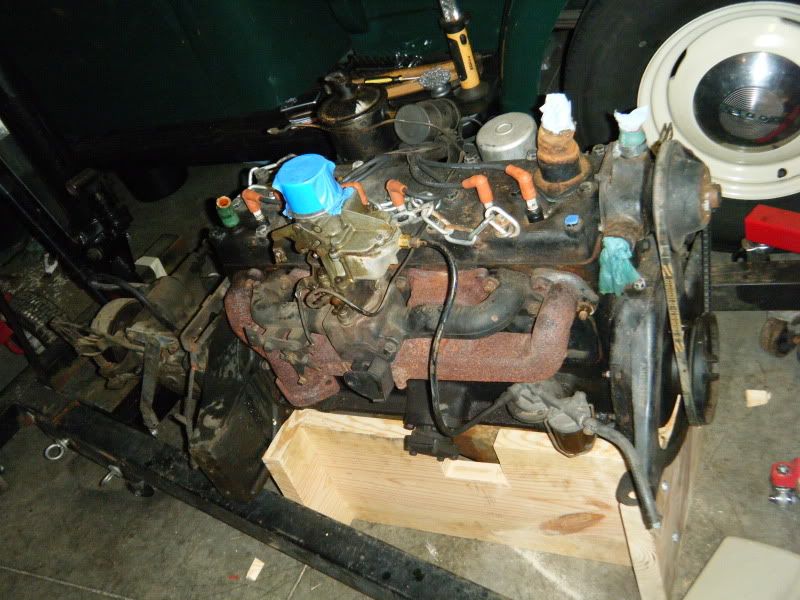

  24. More progress tonight.
    After 4 hours of work and thanks to the help of a great neighbor (and new best friend), I hit a milestone.
    Got the engine out finally.
    Someday, when the swap is complete, I'll try my hand at doing a rebuild on the old flathead just to have it freshened up.
    I don't think I'd ever sell it off. I think the original engine should stay with the truck...even if it's stored on a home-built engine cradle.
