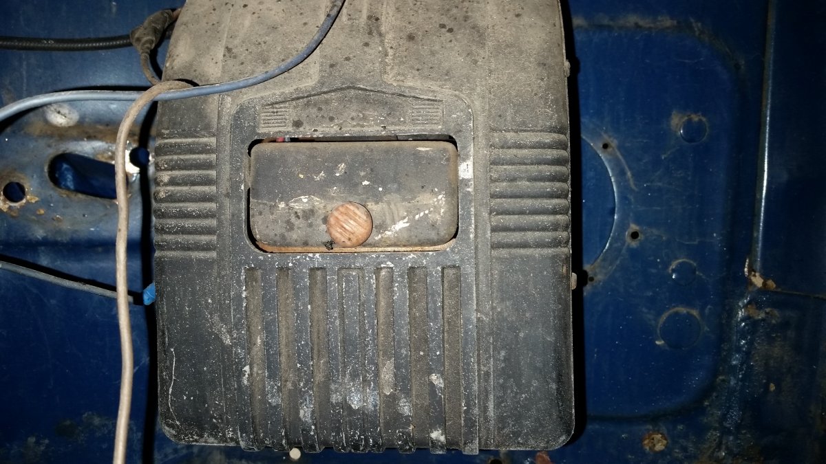

    Is this an original heater? I wouldn't know.

  3. As far as the heater goes, I think a lot of heaters were dealer installed options, so there are many different types on the same year trucks. Mine looked different than what you show, but it doesn't mean yours is wrong.
