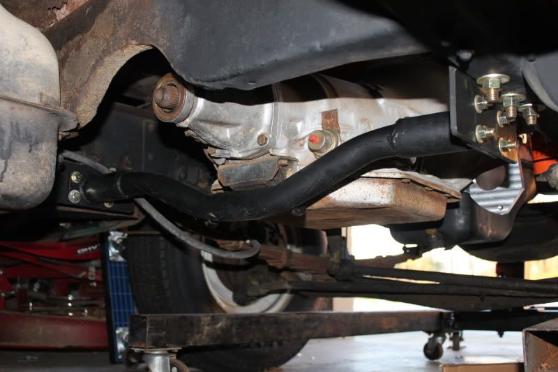

    Thanks to Rock for coming back Saturday morning! We got the engine in it's final position so I could get the trans crossmember brackets fabbed and mounted.
    Crossmember Mounted
    Bracket
    Frame Clearance ( if the u-joints are too close, I will modify the frame for clearance )
    Engine final position (tilts down in the rear about 3-4 degrees)

    Engine and transmission look good! You'll probably have to open that arch up on the crossmember for clearance, but that should be pretty easy.
    As for the jacket, it definitely helps to keep the molten metal going away from you. :D But that jacket looks like a blend type material, and that's a no-no when dealing with hot stuff. Stick to cotton (and not even cotton blends either) - you'll still burn holes in it if you're not careful, but it doesn't typically carry a flame like blends do (acrylic/nylon/polyester/spandex) etc.

    Joined: Jan 29, 2007
    Posts: 7,340
    73RR

    Looks nice, Dan. I'd use nylock nuts on those mount bolts, however. Better safe than sorry. :)
