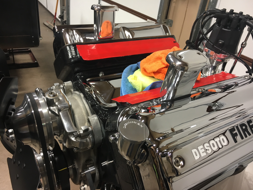

    No they are not! Sell those to the chevy boys and install something like these from Hot Heads. I put one in each cover but I kinda wish I had done 2 in each cover. I also had to add an oil filler in the right cover. I welded in nuts inside that one to accept the Donovan filler neck, also from Hot Heads

    I don't know why you'd need four. We only had two on our Bonneville engine that turned 7500+. The pictured one has been on my 354" Chrysler for over a dozen years and don't think I need another.

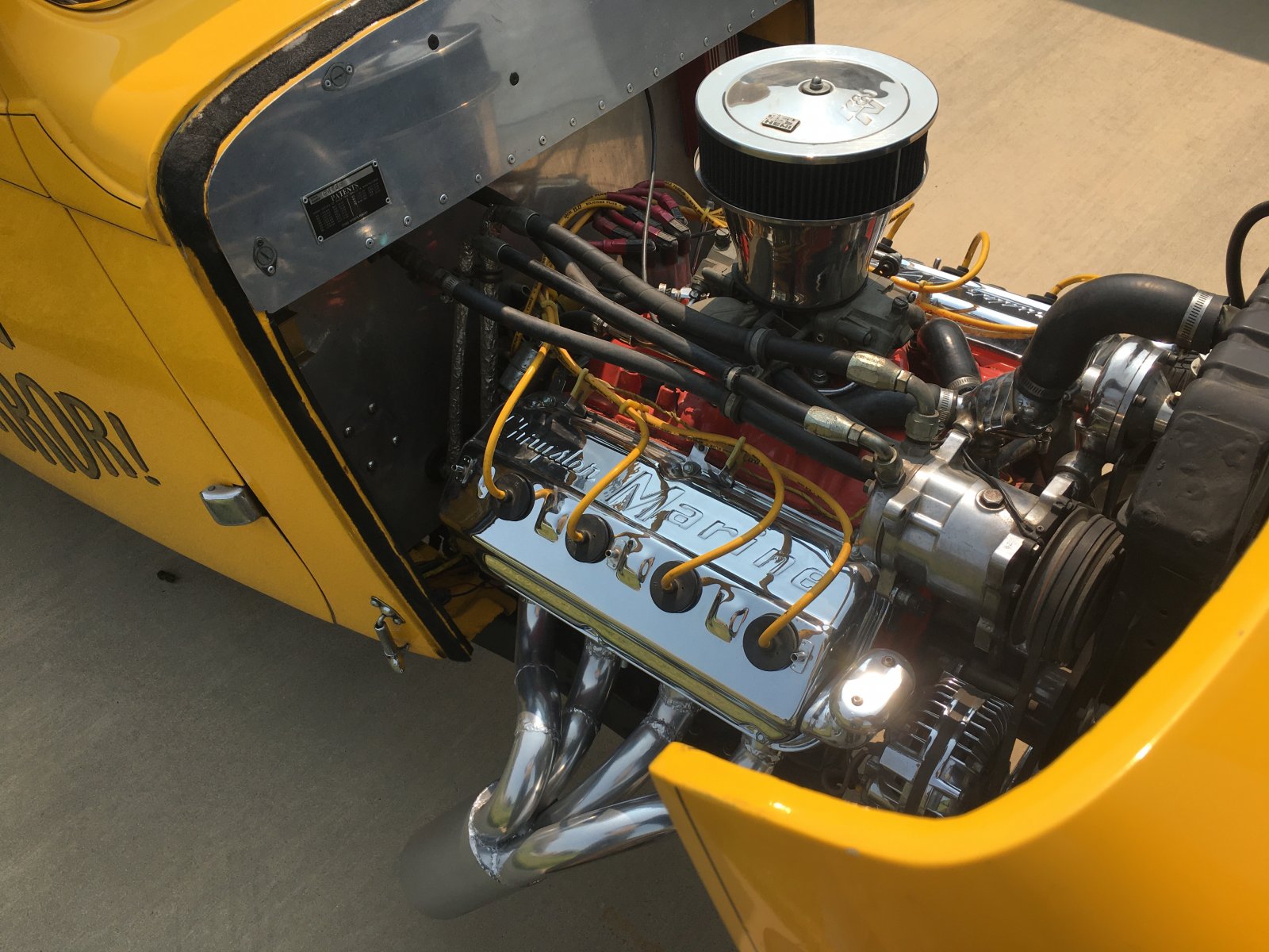

    I ran four of the Moon breathers just because I liked the way it looked. At first I had it set up where all four were open but once I got my adjustable PCV valve I decided to block the back one on each valve cover because I was afraid it would never pull a vacuum on the crankcase with so many openings. 331Hemi1.jpg
    Like Bandit Billy I put the oil filler on the valve cover but used a swivel water neck.

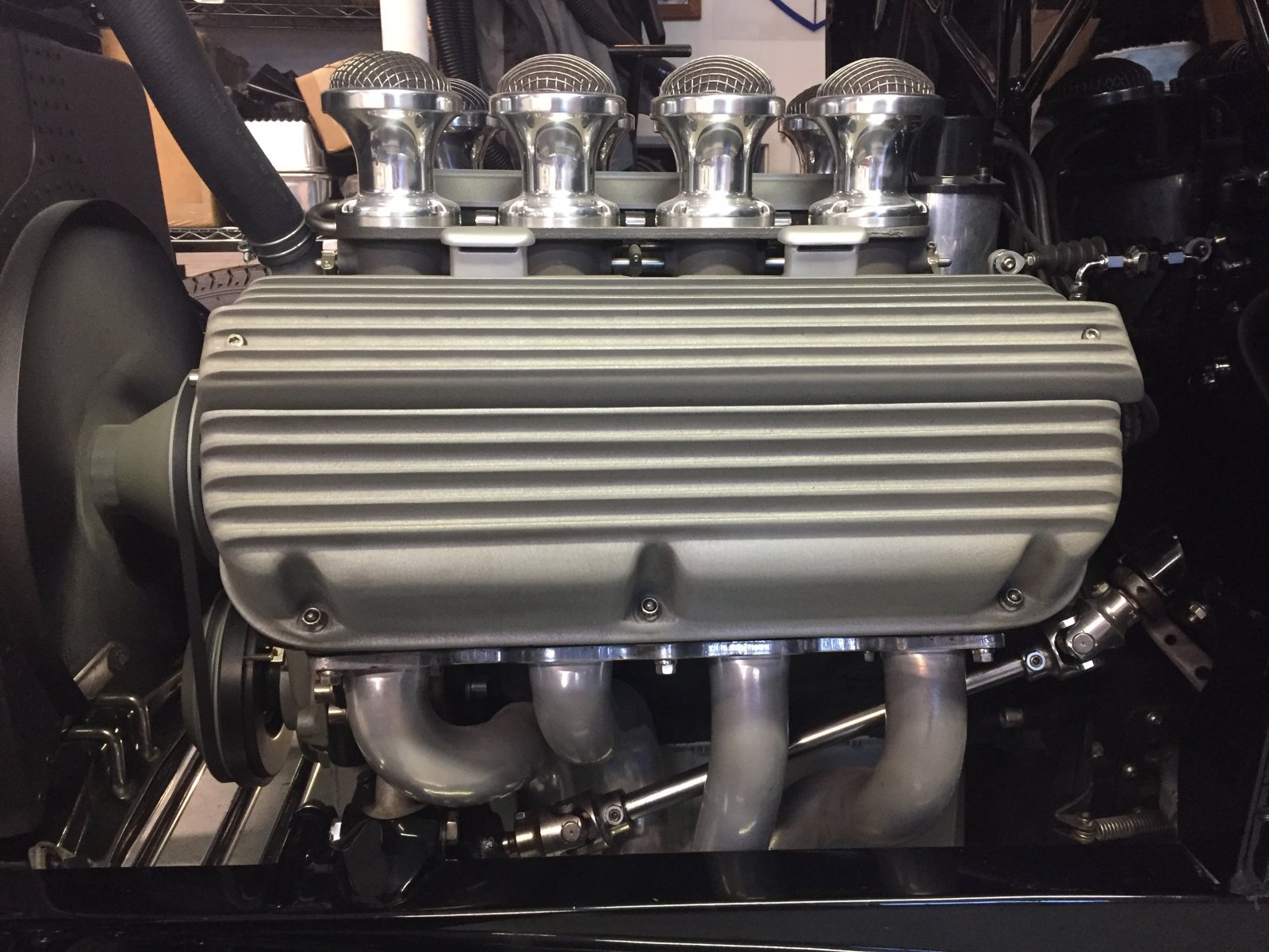

    Ran 4 small ones because I liked the look. F2CDB6DA-FCA2-4DC7-A123-50643C57EFE7.jpeg FCF04BA6-CF87-4274-BBB5-96CB8C4F7812.jpeg

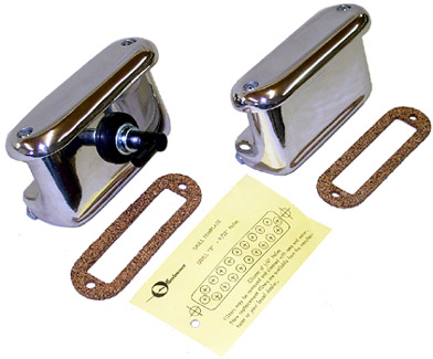

    Sorry to revive an old thread, but I just bought this kit from HH, but it didn't come with the little instruction leaflet. Hard to make out from the picture, but looks like it says "Drill 18 9/32" holes". Can anyone confirm?
    I can't make out any of the text below that though. Thanks!

    Yeah, I found my set, but they also do not have any instructions!
    My advice is to trace the gasket on a piece of paper, and lay out that same pattern of holes.
    It does say 9/32", but there are 20-holes there. Two rows of nine, with a single at each end, between the rows.
