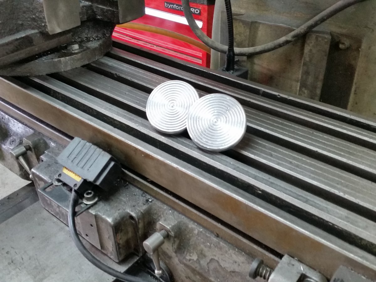

    Mr Skully and the rest of the product line. Maybe I'll resurrect my old " Beverly Hillbillet" line of accessories.

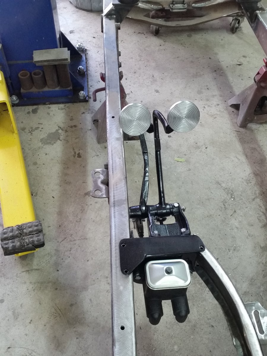

    It's been raining the last few days so I have been in the shop working on the latest from the house of Hillbilly
