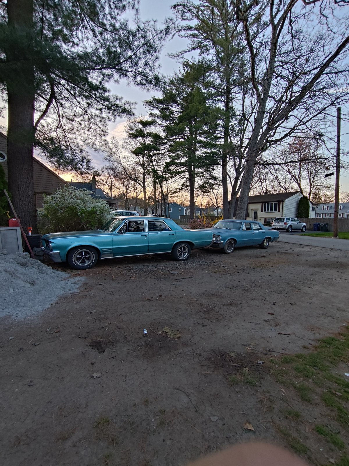

    I originally went to look at this car as a parts car for my other 64 sedan, as this one had no ***le and hadn't been on the road since 76. I was surprised to find that the car was in quite a bit better shape than my other sedan and I ended up buying it. That was august last year, and since then I've managed to go through the paperwork process and get a ***le for it. The plan now is to make it a budget cruiser using parts I had collected over the last couple of years. This car has the 215 Pontiac (it's a Chevy 230 with a smaller bore) inline 6 with the Pontiac super turbine 300 two speed air cooled transmission. I am pulling both out and saving them for my other car in case the current 215 in that one ever quits on me. Going in will be (here comes the hate) a warmed up Chevy 283 and a first design Borg Warner st-10. The 283 I got out of a Chevy Impala parts car I had years back, and it had been rebuilt with .030 flat top pistons, a stock grind 327 cam, Holley intake/carb and a pentronix flamethrower distributor. Now before the purists trash on me for putting in a Chevy motor - the factory 'pontiac 215' is a Chevy inline 6, complete with the Chevy bell housing pattern. It's also a 4dr not a GTO so I can't imagine I'm hurting much value lol. The st-10 I found cheap on marketplace and ended up having rebuilt. All in all doing all the installation and exhaust myself I estimate to be into this car for about $4500. The wheels were Craigslist specials off a yellow GTO and those will be painted. Also if anybody has any tips on measuring to cut the hole for the shifter I'd appreciate it! P_20240429_192605.jpg

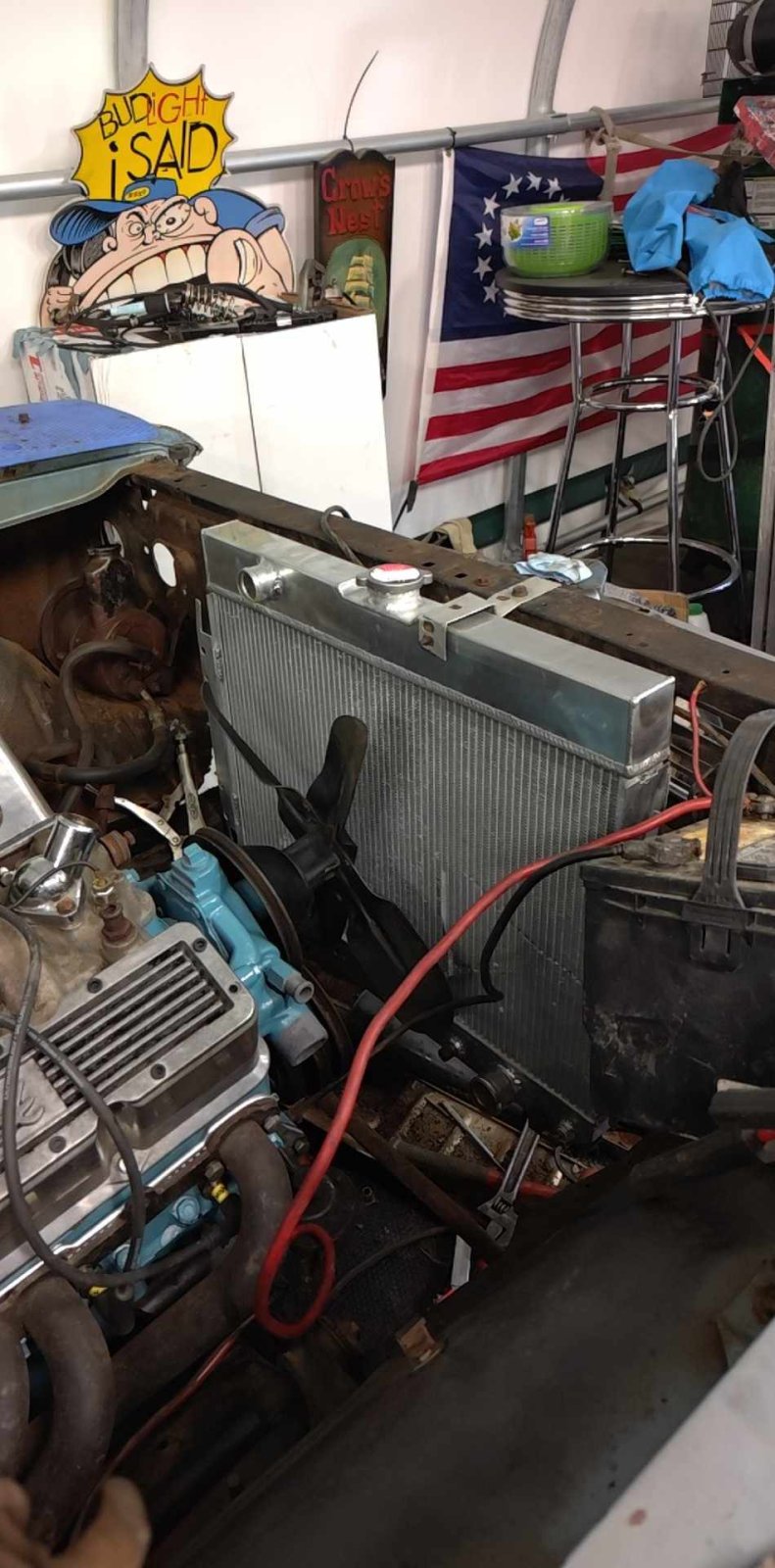

    Some progress over the weekend. A few friends helped me pull the 215 and get the small block in place. I've since spent some time yesterday persuading the headers to fit. Drivers side required me to remove the steering column, oil filter, valve cover, unbolt and move the master cyl to the side, and lift the engine back up a few inches lol but it ended up fitting in place. Next step is I'd like to throw on some wires and a carb to fire the thing up for a few seconds and make sure it's still healthy. It was healthy when I pulled it a few years back, still clean inside, but just to be sure. To get it diving I've got to locate another set of brackets for the power steering and alternator, as the impala mounts from the parts car would put the ps pump well into the steering box. Couple of small issues like that to tackle and I should be able to at least get it moving.

    Still lots to do on this thing, but since we swapped the V8 in a little over a week ago I've been working on it nights and weekends. Have to thank @Duellym for helping out often too. We have made a ton of progress. In the last update I mentioned that the exhaust headers are installed (lots of swear words were mumbled while working on the drivers side). Since then we've finished up mounting the trans, cross member, driveshaft, Removed the drivers side fender and welded on the tab for the zbar, installed all of the clutch linkage, reinstalled the drivers side fender (thanks duellym), installed the radiator and finally we threw on some old wires and a carb and got the thing to light off. The small block sounds HEALTHY and I'm stoked. I still have to figure out hoses, and I have to get some nice new battery cables and maybe even go the professional route and buy a battery that'll actually fit the battery tray. Overall there's a ton of work left to be done. With that said, I have the next 5 days off of work (and a big parts load coming in today) so by the end of this holiday break this thing will hopefully be pretty damn close to roadworthy.

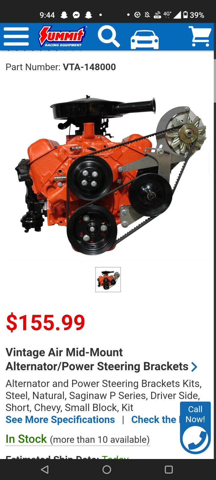

    Making more progress after a months long break to hide from the July heat. A few nights of work and the interior is in, accessory drive is done, new fuel pump is hooked up and working, and it's running/driving/staying cool up and down the street. I wish I could upload a video because with the longtubes and dual Gl***packs it sounds mean. EDIT- uploaded one to youtube
